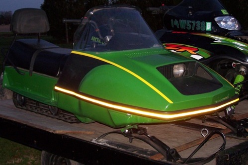

Rebuilding ASAP.
When I tear this stock 1980 440 trailfire down, where should I start? and go for parts? Looking at Dennis kirk...
with a 30 yr. old sled, I'm guessing I should go all the way to the crank seals?
