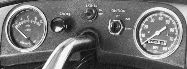

I am looking for a 72 tach. I no it will probably be very hard to find but I would really like one. This is what it looks like.

Check the classifieds on vintagesleds.com, there was just one listed.

We had this discussion years ago so I'm not sure I can find it, but the tach in that promotional photo never made it to production. I believe the actual tach was similar to the speedometer in it's needle design. Still, very, very hard to find.

Here's what the 72 tach ended up looking like during production. There were some changing runs made to it though I'm told, apparently some of them even had a red needle. Even the kits were kind of goofy. Instead of having a bracket that you mount to the back of the gauge, they have a plastic cup with a screw. Also if you look in the other picture I put up, you'll notice that the bezel is taller than the stock speedo. So needless to say, these are a very interesting little piece of the beginning of Deere sleds. The tach in the picture came from the guy on VS, by the way, so I'm sure it'll look the same
