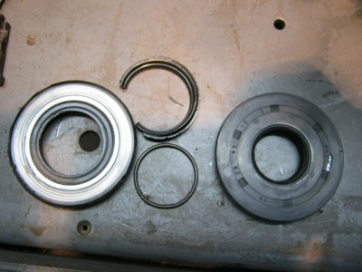

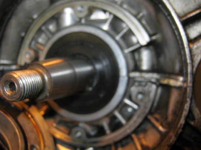

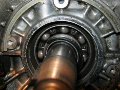

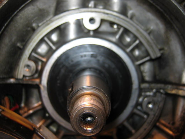

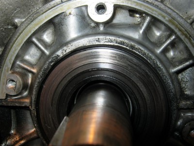

I finally got around to replacing the crank seals in my 78 LF 440 tonight. I purchased it last spring from a friend who had just taken it for 25+ mile ride and it ran great. I was SHOCKED at what I found.

Once I got it on the bench it took me about 2 hours to tear down and put back together. Seals cost about 3 bucks each. Pretty cheap compared to burning it down. I like the looks of the new seal much better. GOOD LUCK

That's what you keep saying and why I was so surprised to find what I did. The old seal literally fell off the crank. No prying necessary. Hopefully a good seal doesn't screw it up its mojo. It's going back in the sled very, very soon.
