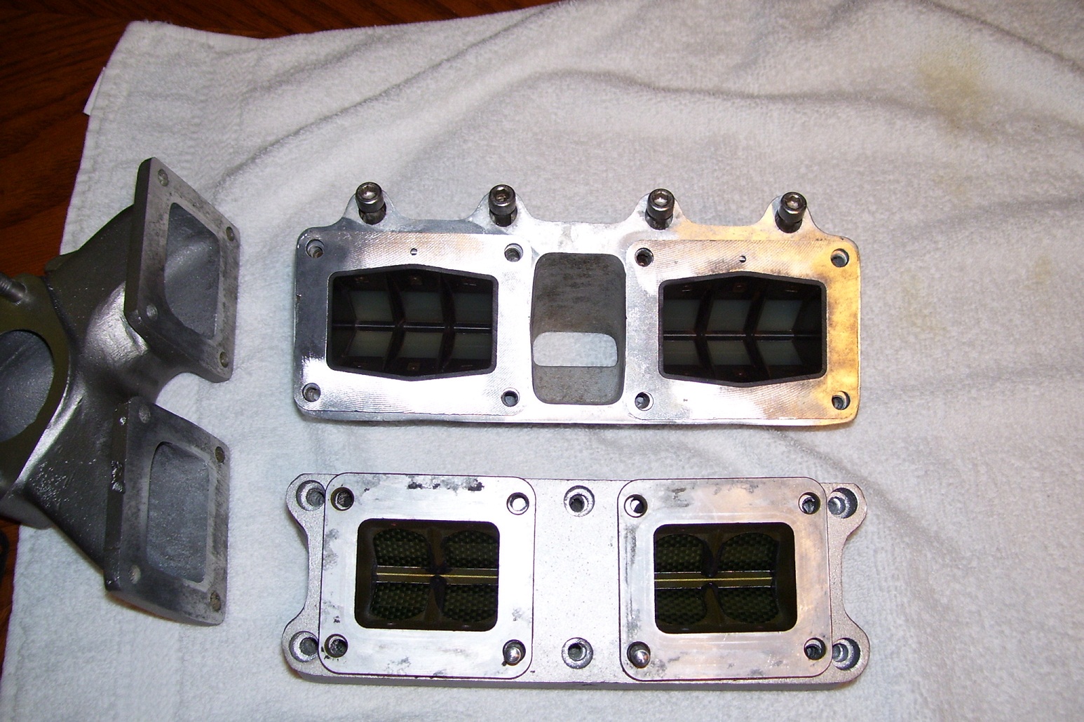

It's been awhile since I've done any mods to a deere since the 4/6 into a new breed LF. I've been into hot rodding jetskis and have a new project in mind as the Kawasaki engines of the time have many similarities. One of these is the intake port shape and bolt pattern, and the 440/550 jetski manifold lines right up. During the "Heyday" of jetskis in the late 80's early 90's one of the mods that came up was retro fitting the piston port engines of the 440/550 with a bolt on adapter that incorporated reed valves. The only modification necessary to the engine was to drill "Boost ports" in each piston. These adapters were available through Johnny O's Racing and Goki. They pop up periodically on ebay. The one from Johnny O's is the one I'd like to try on this project as it utilises the reeds and cages from a Yamaha RZ350/YZF350 (Banshee), and I therefore can use the carb boots from the banshee as well. On my heavily worked jetski cylinders, this "bolt on" made a huge difference in starting, idle, and responsiveness. Here's some pics of both the adapters and some modified pistons I have from my JS550 jetski. Of course I won't be able to utilise the air box, but I don't plan on running powerjet carbs or dial-a-jets so this shouldn't be an issue. The additional fuel circuit in the affore mentioned carbs requires vacuum from the airbox to function. Anyways, if anyone has ever done this or heard of someone doing this please chime in!
Tracy
Top is the Goki, it uses the reeds, cages and intakes from a Jetski 650. Bottom is the Johnny O's using banshee reeds and cages. Intake pictured is for a vertically mounted SBN44 Mikuni diaphragm type marine carburetor.
Quick view of the goki with reeds removed. Port matching is a breeze!
Left; stock double ring piston. Center; my own creation. Right; used single ring with "recommended" boost ports.
Engine side showing the bolt pattern and port shape.

Thought I should show one of my "top secret" ported cylinders from a jetski with the reed adapter and dual SBN38 carbs....I have no intention of going crazy porting a fan cooled engine as cooling would become a issue. Just trying this to get a little "cleaner" response from the engine for low rpm trail riding.
