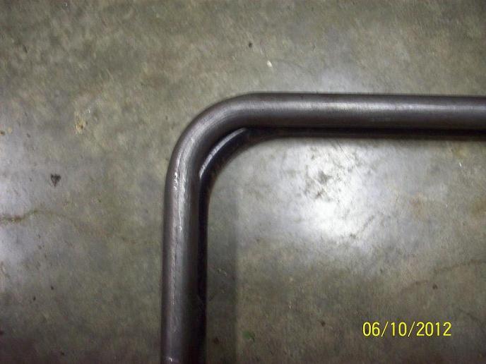

Re: Kenny's next reproduction: '78 style rear bumpers
Here you can see the 90 degree bend is tighter than the original Deere bar.
The bar is made of much heavier wall thickness than the OEM bar. The bends are pretty much on the money. The two things I noticed is that the 90 degree bends on Kenny's aftermarket bar are tighter. The OEM bends are more sweeping. Also the holes do not align perfect with tunnel holes. They are about 1/2 a hole off. I was able to get the two carriage head bolts started in the running board on each side. With those two bolts tightened down the four bolt holes that secure the bar to the sides of the rear of the tunnel are roughly a 1/2 a hole off. That being said I could easily drill the holes in the tunnel using the holes in the grab bar as a guide. With the flat washers installed on the backside of these bolts it would hide the elongated hole. The factory fasteners are 1/4" diameter bolts and Kenny had 5/16" holes drilled in the bar. So you talking 1/8" to 3/16" off center. Overall I was pleased with what Kenny had made. I also like the idea of it being heavier to withstand more abuse.
