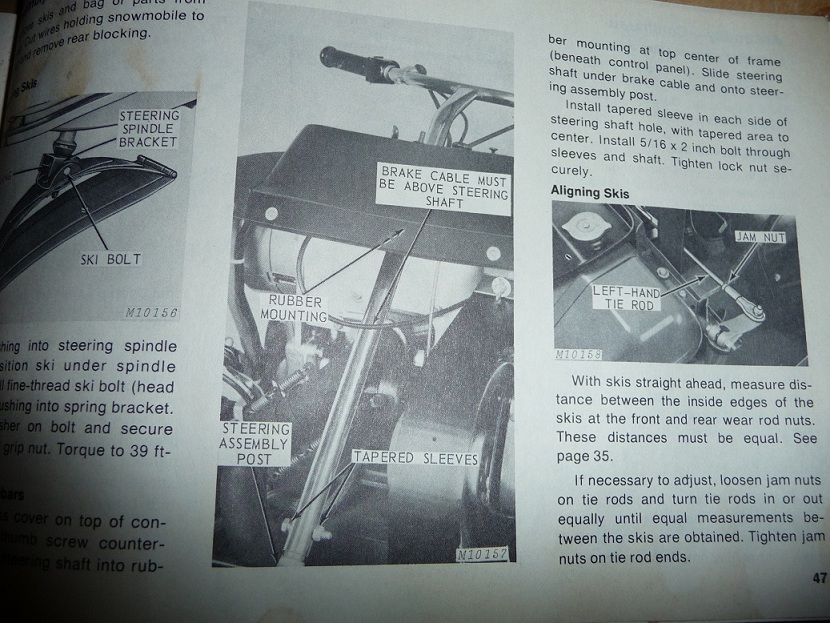

Post by jeffreyrempel »
Check out these picks from my 1972 owners manual. The front belt gaurd over the secondary looks steel. The plastic one is not on the 1972. You can also click this link and go to page 100 to see the gaurds: http://www.vintagesnow.com/John_Deere_f ... _Parts.pdf
I have never seen this gaurd before :think:

Post by 80spitfire »
The part that they call the belt shield is definitely plastic on the 72s not steel, it does look lke steel though and it's actualy pretty thick plastic, but it's plastic none the less. Nice job scoring those NOS parts! You should post some pictures of your progress on the sled so far.

The belt shield ( M63458 ) over the secondary is steel, and painted black. It was also used on the '75 models.
I did a little bit more research on the belt shield and found out that M63458 is the correct part for the 72s. I also looked a little bit closer and did notice the difference in the picture that it is the steel one, so my apologies on that one because I was going by the one on my sled. My sled ended up at some point getting a M63913 added to it which surprisingly fits perfect lol I always wondered if they ever actualy came with the M63458 or not because I too haven't seen one before other than in manuals. I've always seen them with the same one mine has.
