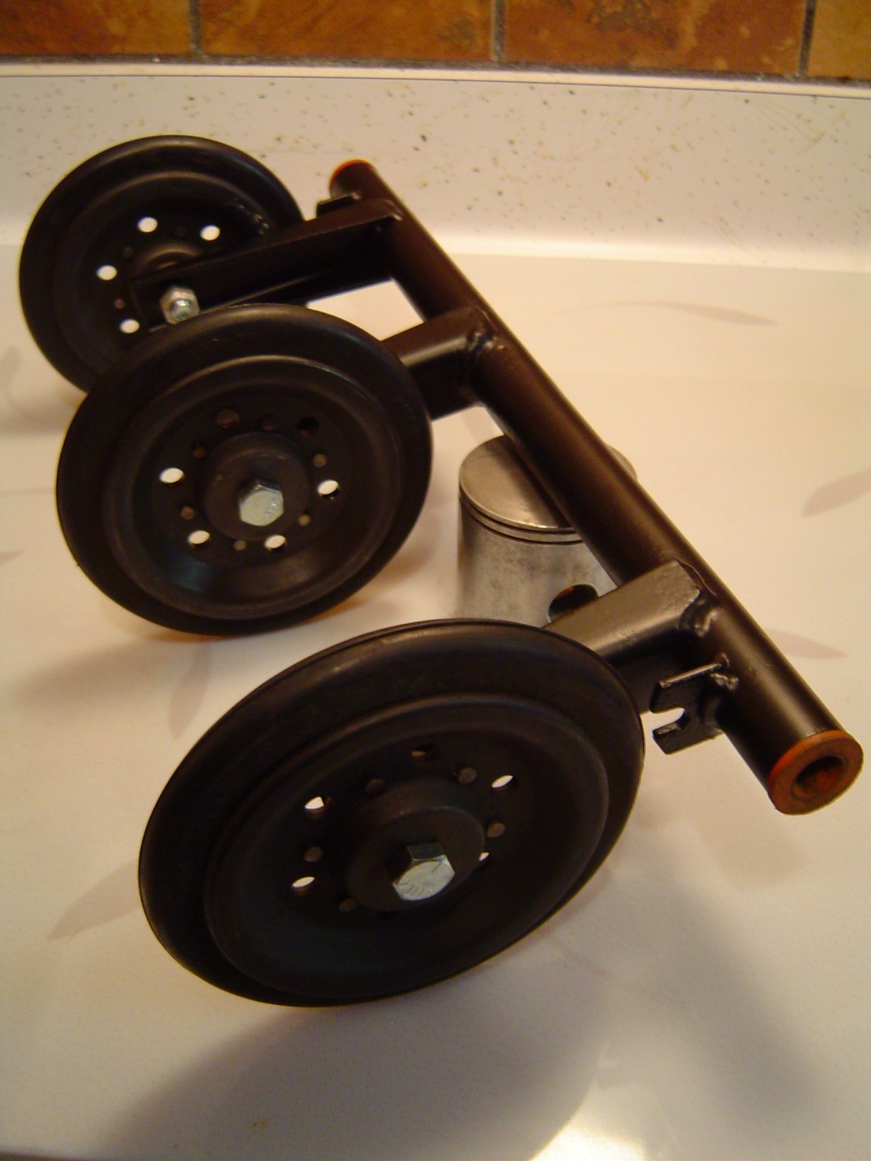

This will be the lead bogie shaft.
Blasted and painted, NOS wheels, and 1/4" longer bolts so that locking nuts could be installed.
I removed the PN stickers, but Rainville should note the molding flash on the edge of the rubber tires.
Joe recently confided in me that when it comes to 15 bogie wheels and 2 inches of travel...SIGN HIM UP!

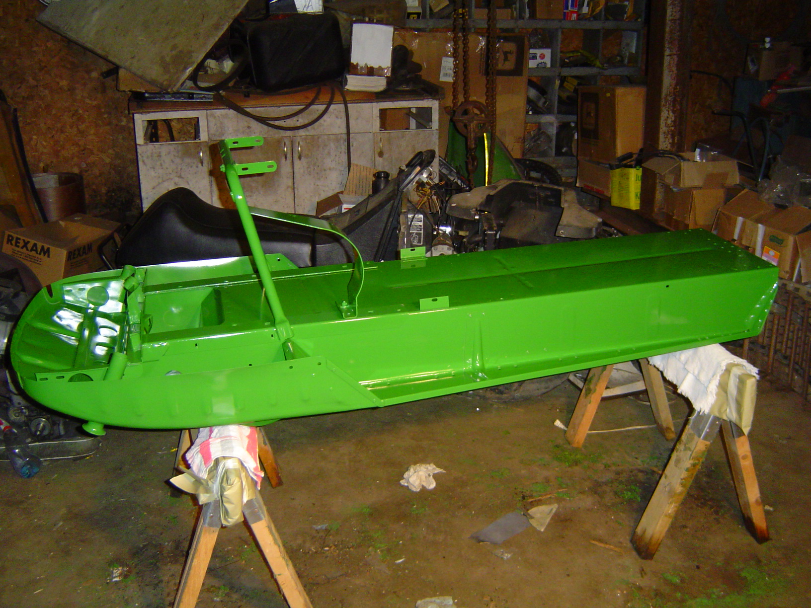

The tunnel is painted!

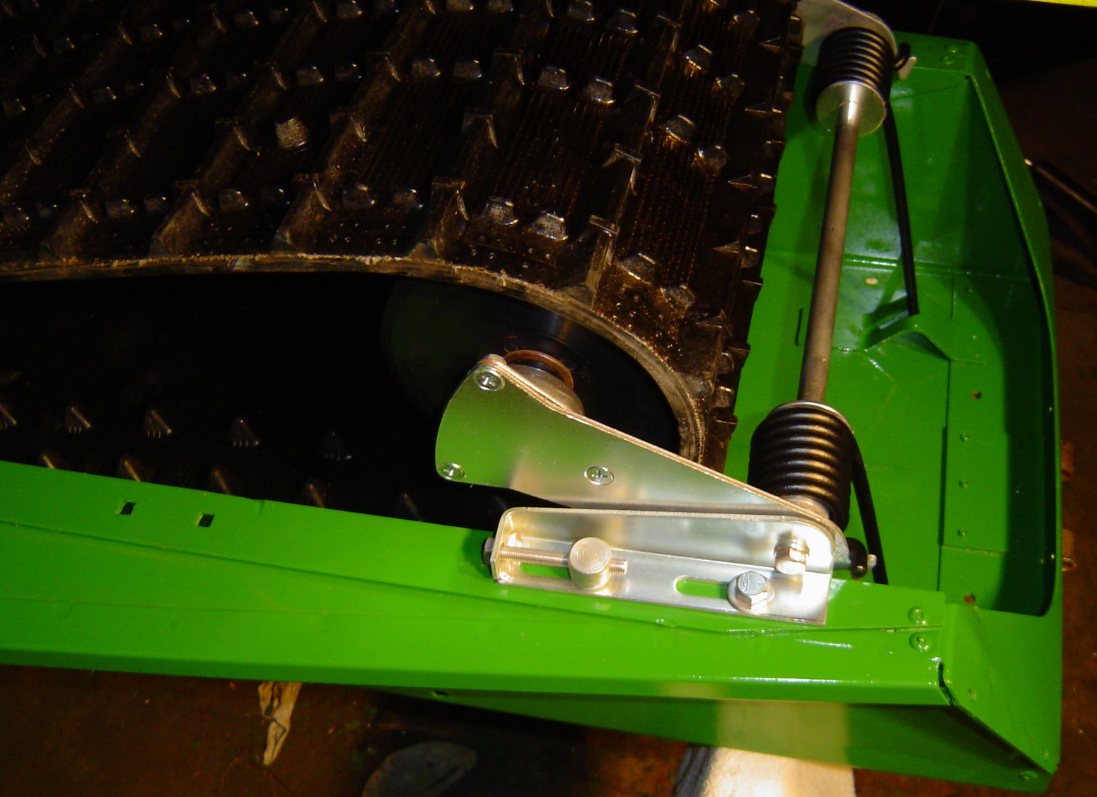

Progress is slow, especially around the holidays, but I've made a bit.
Power module is bolted in, as are the motor mount plates. I hope I didn't forget anything that requires access through the tunnel, because the track is in. Finally got all the bogie hardware painted, so that is next.

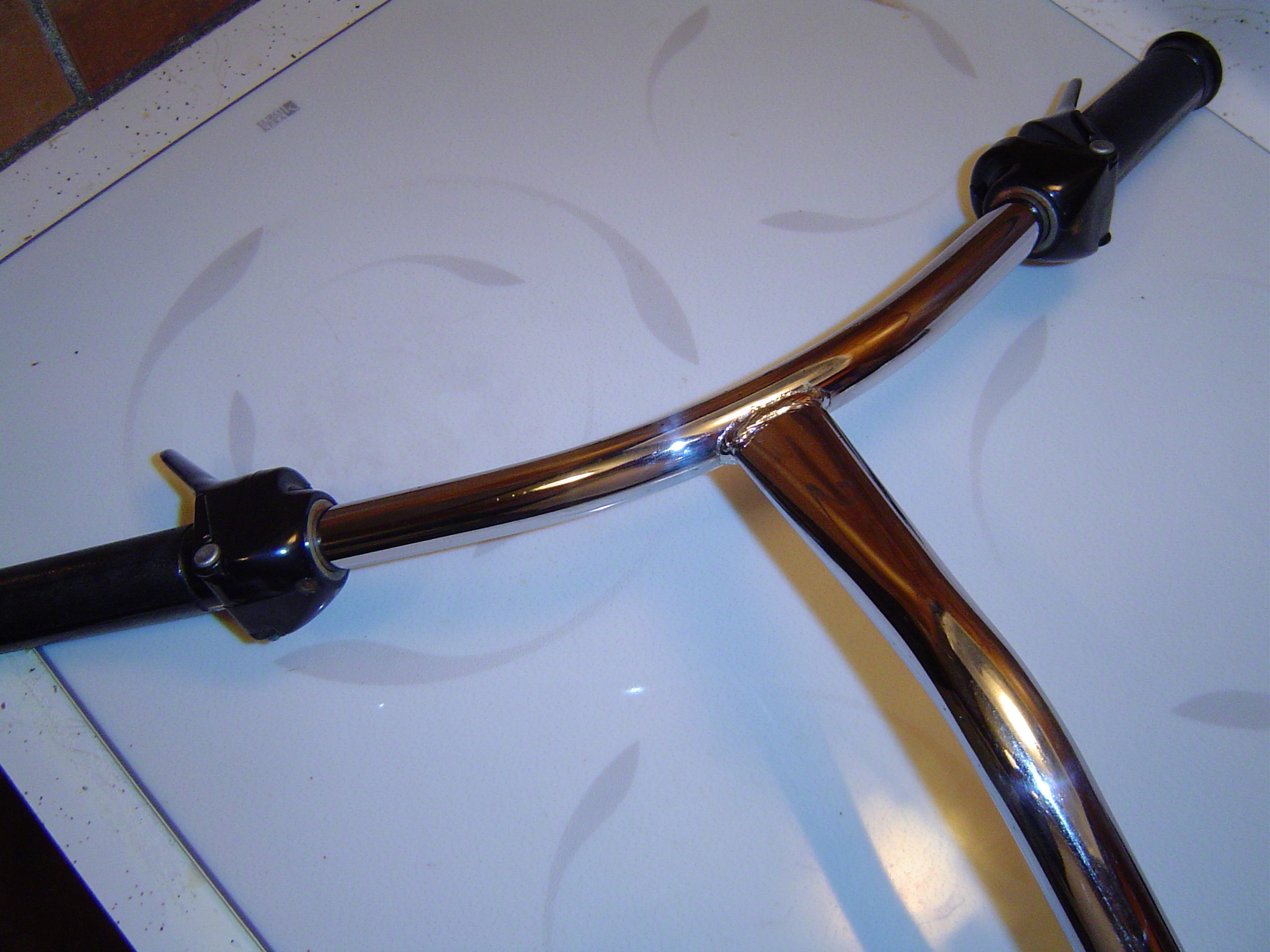

There is so much to do, and so little time. Tonight I felt the need to see some chrome, so I brought the handle bar and bumper to the house. I got the bar from Greg Stebner 5-6 years ago. It was supposed to be NOS, but like so much of this stuff, it was a bit beat up from laying around all these years. I was just starting to rust when I got it, and it had gotten some worse while in storage.
The bumper came from the same guy I got the 340/S engine from 5-6 years ago. I don't know if it had ever been on a sled or not. Again it was a bit beat up, and starting to rust.
Before I went too far, I wanted to see if the grips would come off the original bar. By the way, despite being under cover for most of its life, that bar was rusted solid brown. I was amazed to see the set screws back right out, and the grips slide right off! The grips aren't even cracked.
I went to work on the bar with Mother's, and it cleaned up pretty good. It would be an excellent candidate for re-chroming, but that is Don's specialty. The bumper is about the same deal, some rust and minor dings and scratches. The bumper is the one item that I tried to acquire NOS and failed. Stebner had a couple of them, but on opening the box, he found they were either bent or rusted beyond use.

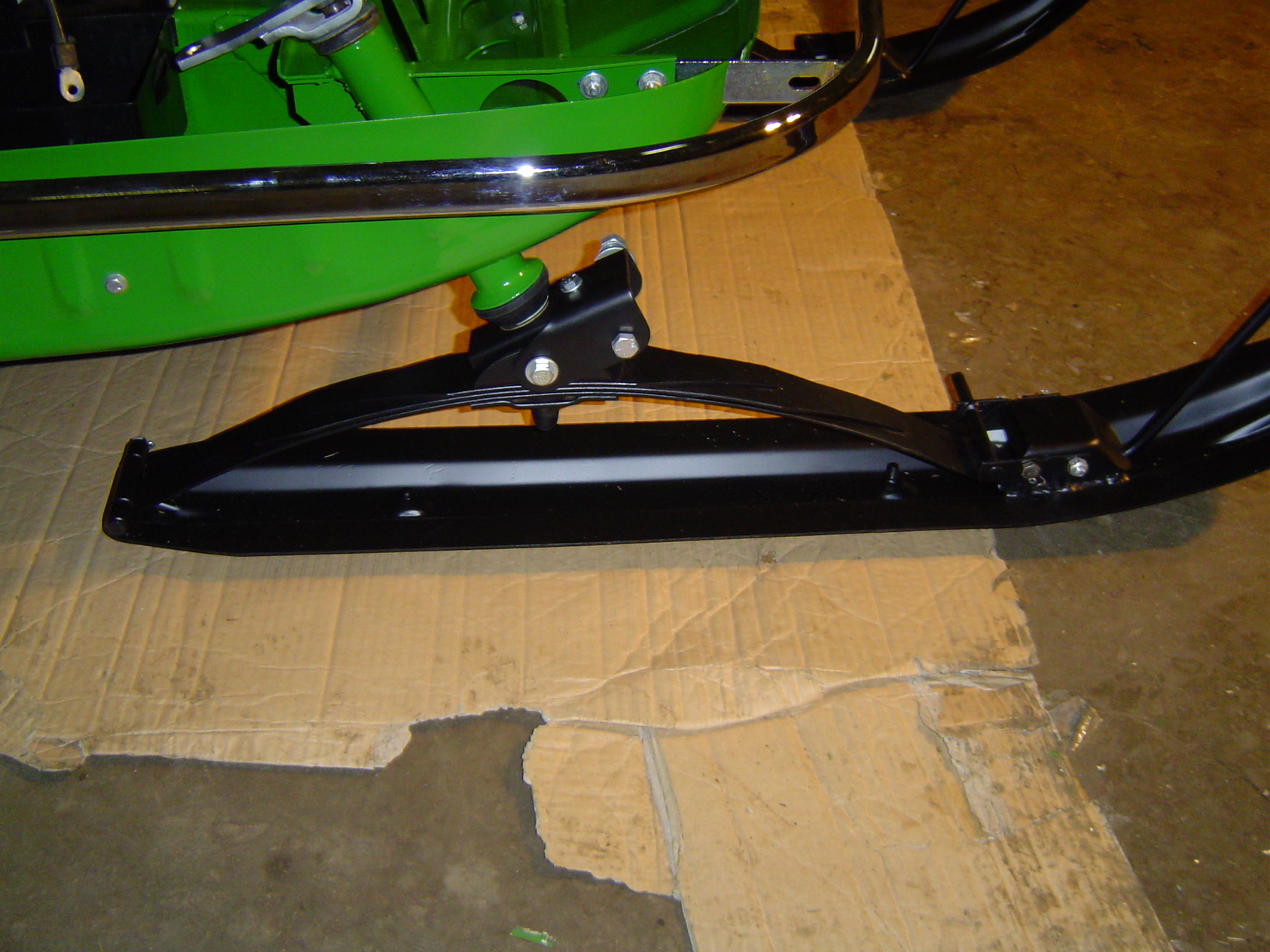

Some progress was made today.
The skis took a lot longer than anticipated. The spindles, skis, springs, and shock kit are all NOS. The original spindles and skis were pretty messed up. I have told the story many times; in around '85, my brother rode the sled into a switched railroad track, rolling the skis under the sled, messing up the skis and bending the spindles.
The shock kit was acquired from Greg Stephen out in Denver several years ago. It complicates installing the skis considerably, especially when you are trying not to scrape off all the paint that was just shot. Obviously I haven't installed the shocks yet.
The e-start kit was acquired off e-bay several years ago. Pretty rare item I think, the battery box in particular is unique to '72, as is the manufacturer of the starter motor.
