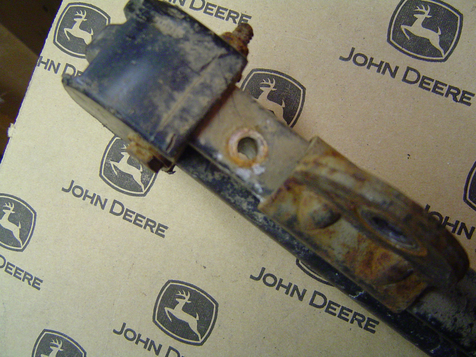

I wonder if a 80s LF mount got bolted on to this rail, this is what it looks like after the side wheel and outer steel bushing has been removed. Looking at the parts book, this looks like a -190,000 LF part. Certainly not a CC part.

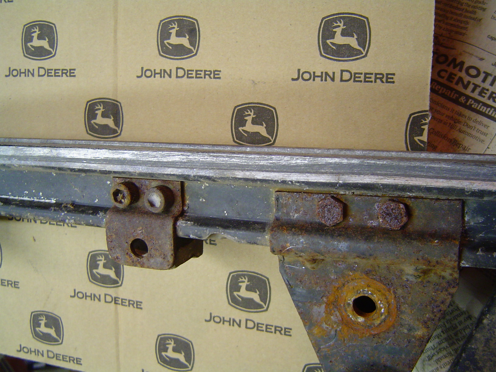

Here's a look at the biggest issue I have found.The left rail has been seriously worn into by the track clips.
What I thought was really surprising, is that it starts at the very front, and goes most of the way down the rail.
Any thoughts?
Any thoughts?

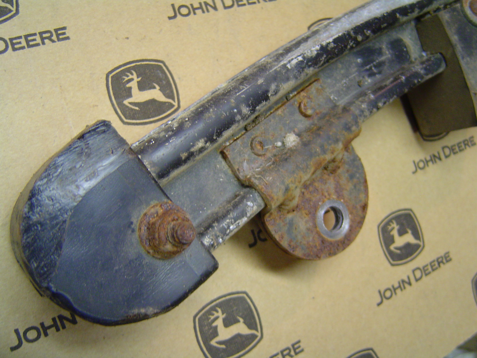

One more thing; while the hyfax retaining clips are bolted in place on the rear axle bracket, someone went to the trouble of drilling the rails and bolting the hyfax in at the front.

I've seen that caused by bent track clip tabs on the 80s. Not sure how the tab gets bent.400brian wrote:Here's a look at the biggest issue I have found.The left rail has been seriously worn into by the track clips.
Any thoughts?

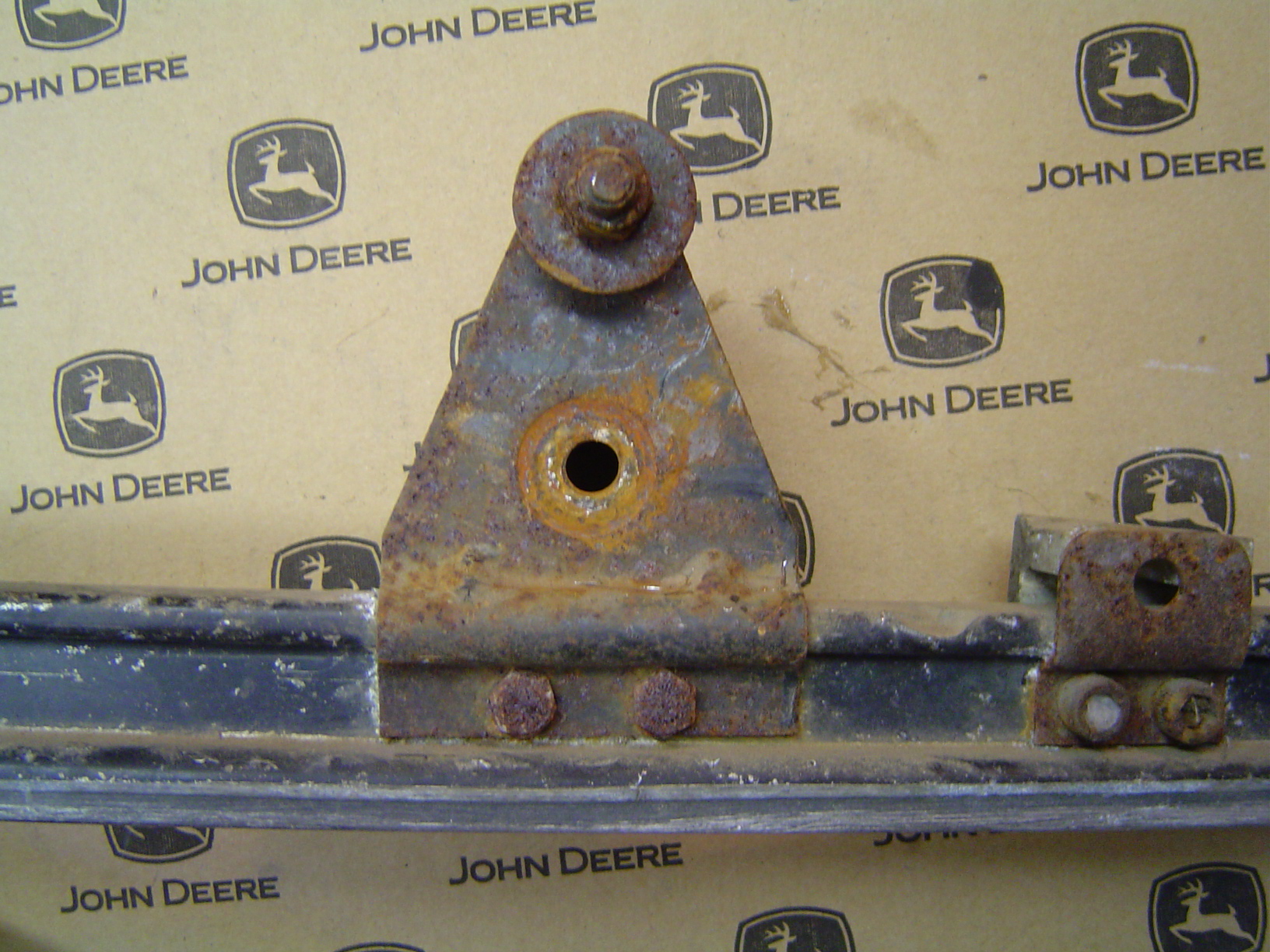

The tail end of the 78 is a full I-beam, where on the CC, the top of the I has been cut flush with the web on the last few inches. I assume a production rail could be re-worked to CC specs. I'm going ask around to see if anyone could run a bead down the inside of this rail. As it is, it will probably hold the hyfax. I just pulled the old one out.

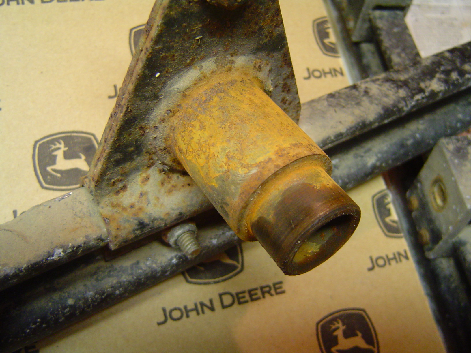

Here's a photo of the inside of the tower.

Brian That tower IS NOT a CC tower The CC tower has a oblong hole as the both the steel & aluminum spacers that the center wheel mount on are pushed into that oblong hole for stability. If I can find some I'll get some pics & send to you..

Brian That tower IS NOT a CC tower. Agreed, that is what I've been saying. I've never seen the CC spacer, but I have looked at the setup in the parts book. This won't be 100% correct obviously, but it'll be ok for my '78 rider.ICCSF 108 wrote: The CC tower has a oblong hole as the both the steel & aluminum spacers that the center wheel mount on are pushed into that oblong hole for stability. If I can find some I'll get some pics & send to you..
