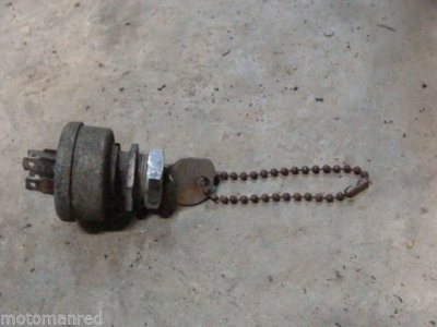

i order my brake pads thank now i need a new key switch i now know its a 1976 but i olny see 77 and 78 key switches listed most places so will there work they look like they will here is a pic of the old one

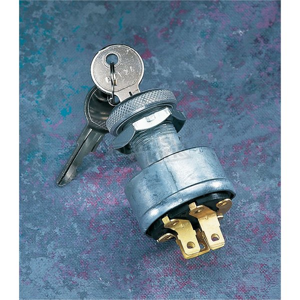

these are the new ones will they work?

Yes it will but there will be an extra position between off and start. Do you have electric start?

No but the switch that was in it had 3 positions

Correct, the JD OEM switch had OFF, RUN, START
The aftermarket switches have OFF, ON,RUN,START
Since you do not have electric start it will not be as confusing. ON and RUN allow the engine to run but the switch has to be in the RUN position to charge the battery if you had electric start.
