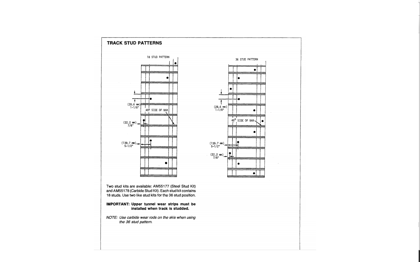

It seems all the Liquifires in my area have studs on their tracks. The owner of this sled didn't follow Mother Deeres recommended Stud Patterns. Is this reason for concern? He sure punched a bunch of extra holes! I will be riding trails and on frozen lakes. I would think I would benefit from the studs. Why do you recommend removing the studs on the outer belts? Is it due to the narrow widths of the outer belts?

People have run studs on the outer belts and will continue to do so. Studding the outside can inhibit corning on the trails, causing your snowmobile to push straight in the turns, which is fighting the steering effort. If you are going to use the studs, you also need to install carbides to balance out the traction.

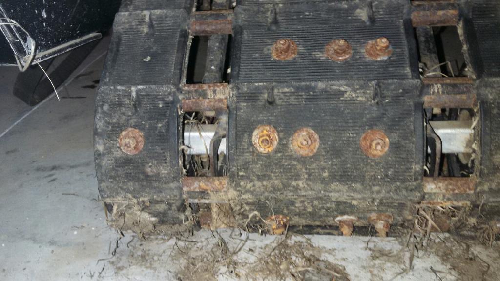

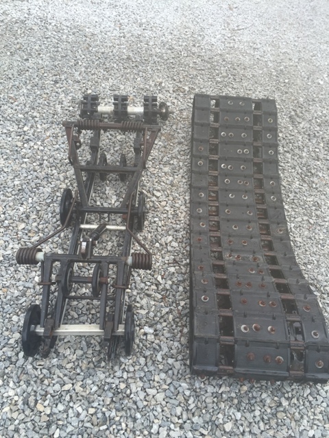

Got to work today on removing the Liquifire Track, Suspension and Drivers from the 80' Liquifire parts sled. The track has missing studs here and there. I will remove all the studs since I have more people recommending a track with no studs rather than one that does. So what do you do with the holes left behind made by the studs? Do you fill the holes with something like Black RTV? The suspension looks pretty good. There are a couple of idler wheels that have little chunks missing on them. One upper rear and one front idler. Have replacements for those lined up!

Holly Cow ! Looks like a super clean skid. Most i tear apart are a rusty mess. Brock
