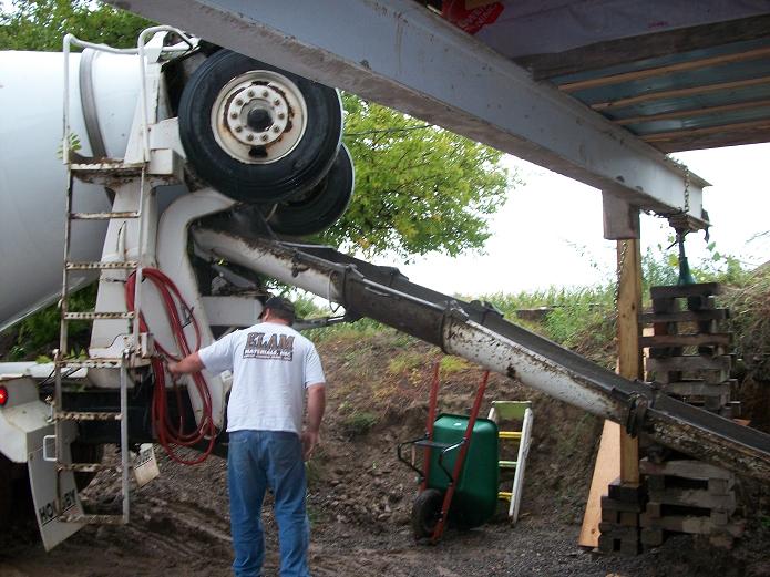

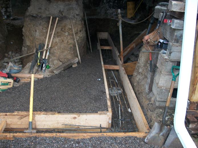

After winning the "Battle of the Cript" the excavation could continue. Unfortunately we did not find Hoffa, the Wildfire or anything else cool in there. The forms were FINALLY built in early Oct. The cement truck arrived Friday, Oct 2nd and poured the new footer.
Then we could finally start building walls...

- Concrete Truck pouring new footer
- Footer Concrete 9-Oct-09.jpg (142.96 KiB) Viewed 3016 times
- Forms ready for concrete
- Footer 2-Oct-09.jpg (136.9 KiB) Viewed 3015 times

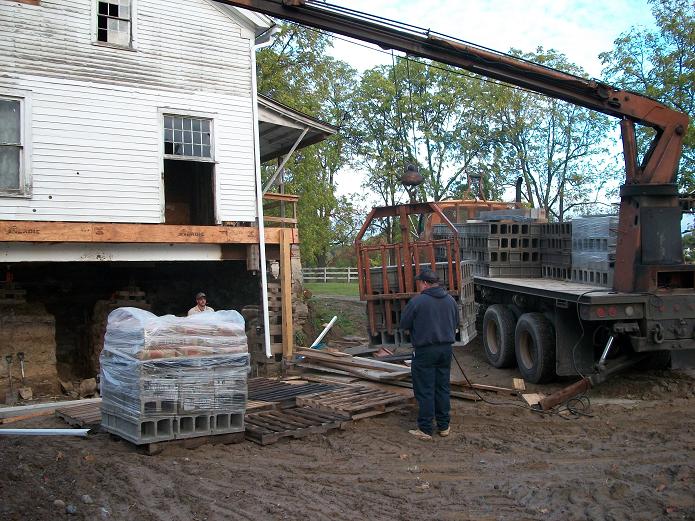

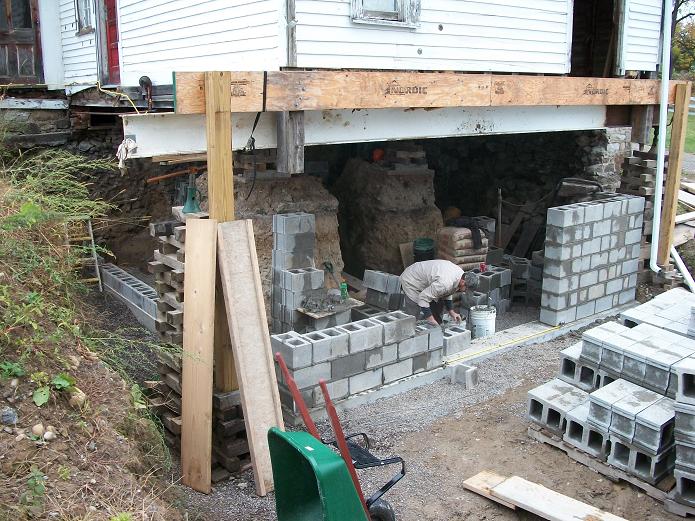

Once the footers were in, progress was swift. After doing the take off for the block supplier, all the needed materials were delivered the Tuesday following the footer pour.
My contractors provided me a mason to put up my walls, so I got to be his helper for a few weeks. Lugging around 10" blocks also helps with getting in shape for snocross and cross country racing this winter.
- 9 Pallets of bocks being delivered
- Block Drop 13-Oct-09.jpg (179.57 KiB) Viewed 3016 times
- Walls going up
- Building Walls.jpg (180.3 KiB) Viewed 3019 times
