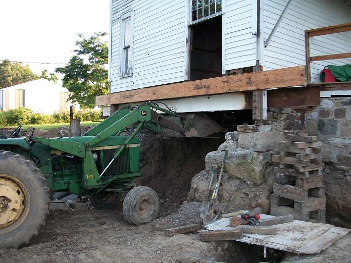

Here is a pic from yesterday, the 4030 is really being a big help in this project. Even Cari keeps remarking how glad she is that she bought it for me.
I figure it's only fair to spend at much on the house this year as I have on vintage sleds, LOL! Cari is totally cool with me putting in a "John Deere Sled" room in the walk out basement. I kind of like the idea too...

More progress the past few days...
Started digging out the new basement and installed the temporary support beam. Got the jacks in place and began lifting and leveling the back wing. It sunk over 6" from the front of the house because the old crawl space was literally "rocks on grade."

Then I started diggout out the huge old rocks that make up this so called foundation. They come apart pretty easy between years of heaving and limestone motar that didn't last...
