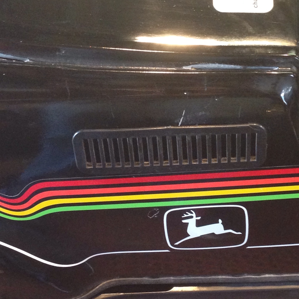

1980 Liquifire Project
Got the parts I need thanks Sledder670 for the vent!

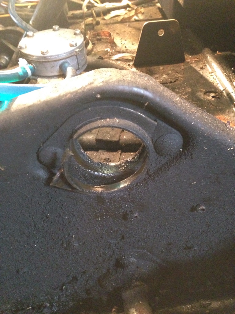

Re: 1980 Liquifire Project
Found the cause

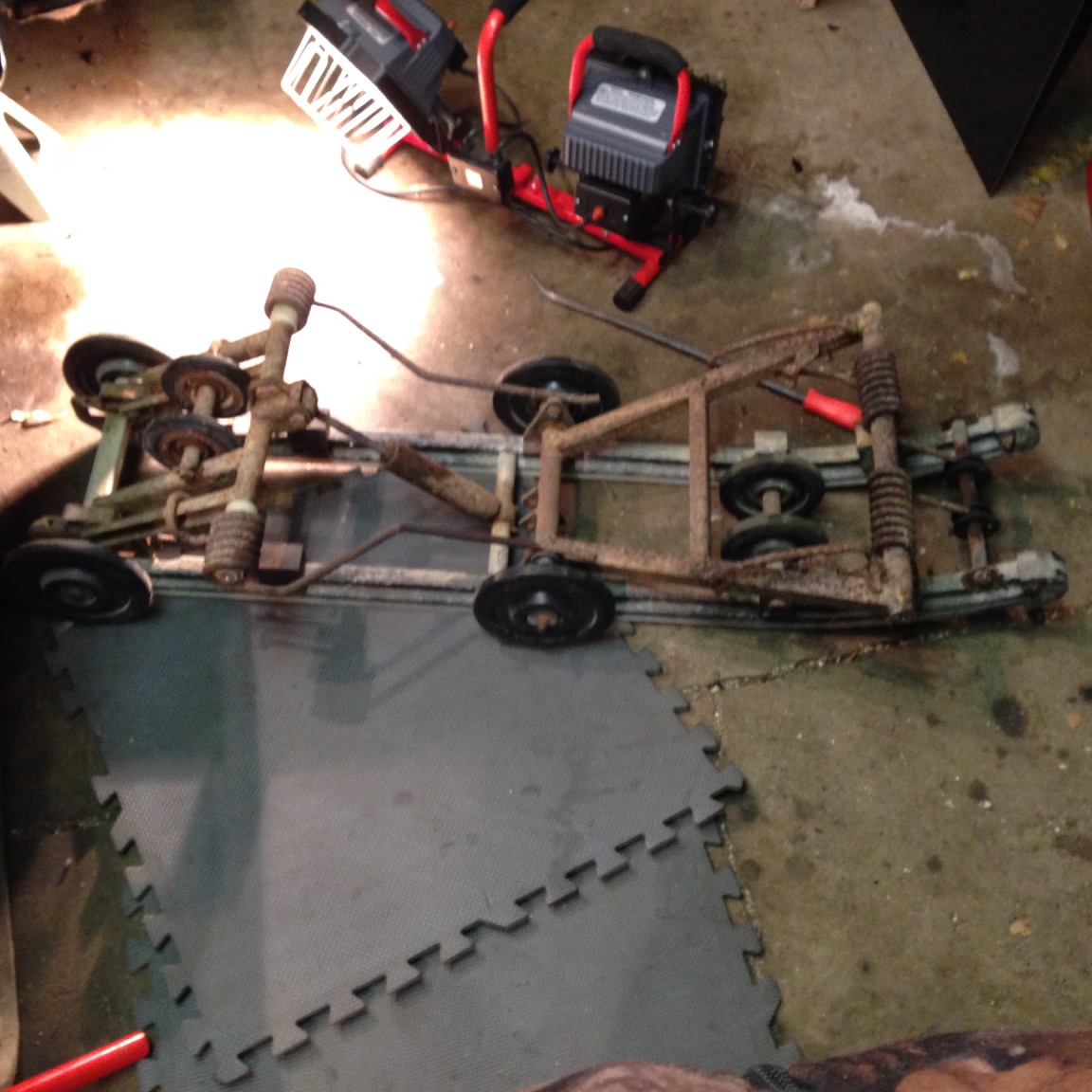

So today went to a smowmobile show today notice what I ran into. A 83 and a 80 with a 84 hood. Then when I got back worked on replacing the collar for the bearing then went on a gunk cleaning spree and then took the skid out and found a few problems...

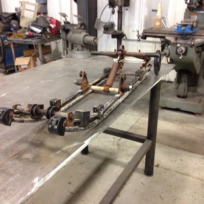

Did some rear skid work put some nice slides on just waiting for a rear shock.
