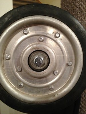

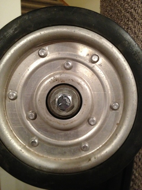

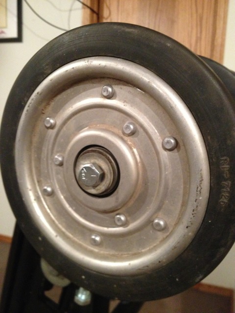

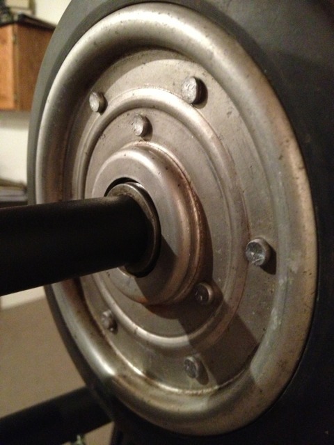

Results of my rebuilt idler wheels, using the jig I made...

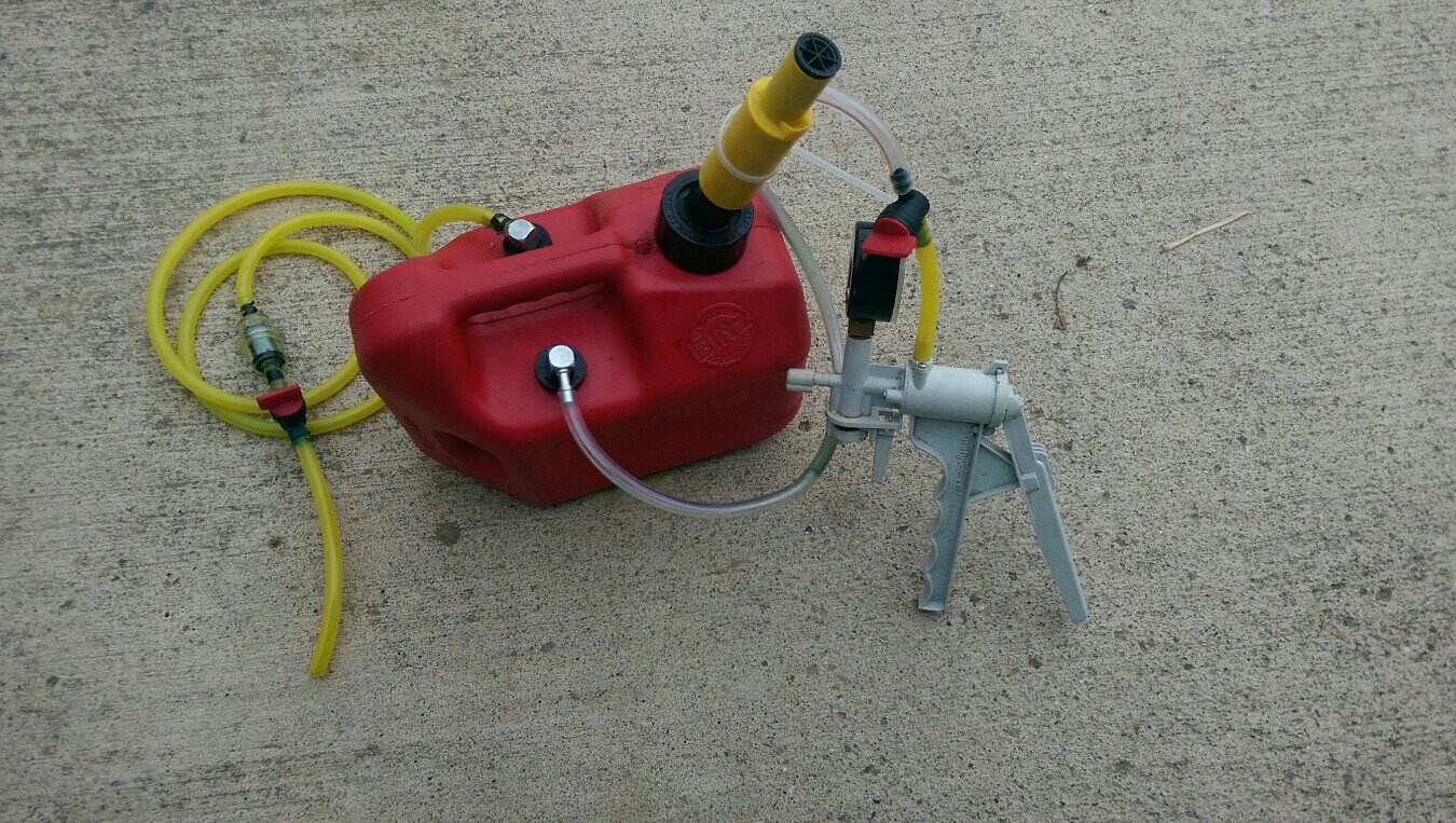

I have modified a little 1 gallon gas can by adding 2 of the push in fuel fittings. The yellow fuel line has a pickup (non check valve). The clear line is just a vent. When I go start an engine I connect the yellow line to the fuel pump turn on both shut off valves, connect a mityvac to pressureize the can. This will fill the carburetor bowl(s). Then I carefully vent the the pressure and remove the mityvac. The engine can then be run on off the fuel can if desired.
For me the main purpose is to keep me from pulling my guts out at the beginning of the season since I drain all the fuel for summer storage. I find myself using it to also suck the last bit of fuel from the tank our drain a line by pulling vacuum on the can instead of pressurizing it.[attachment=-1]uploadfromtaptalk1419809501913.jpg[/attachment]

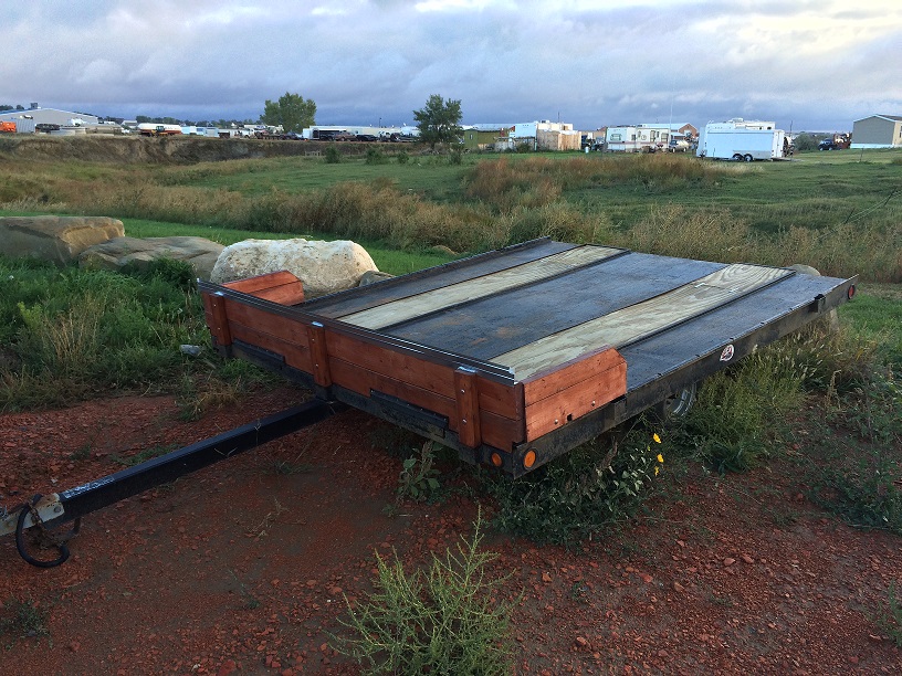

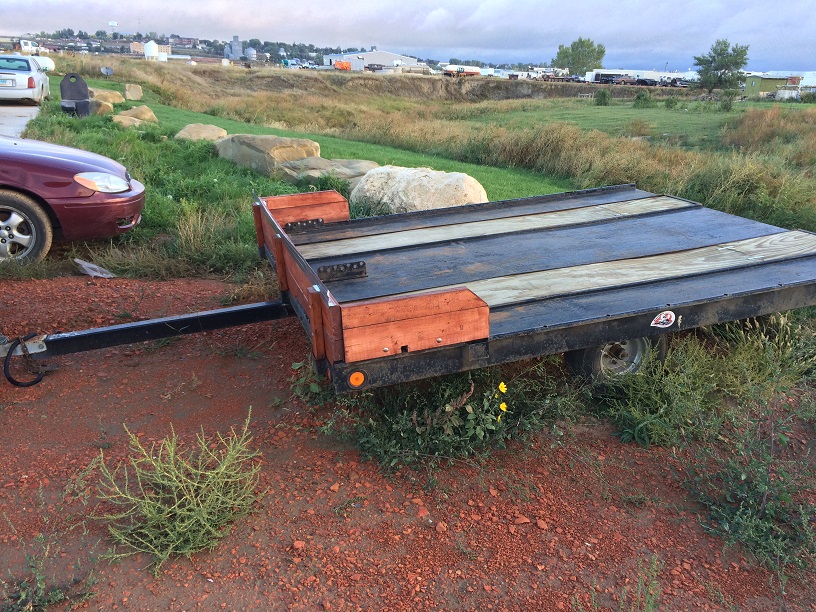

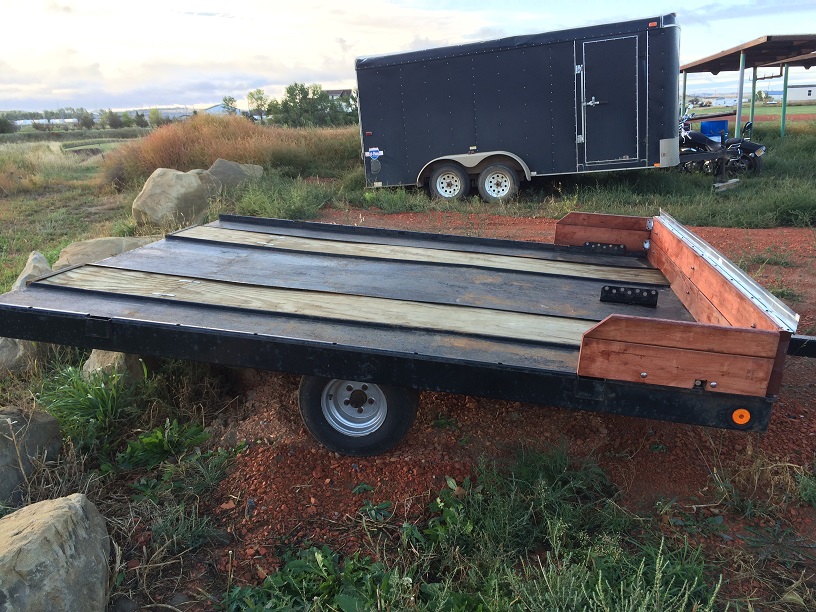

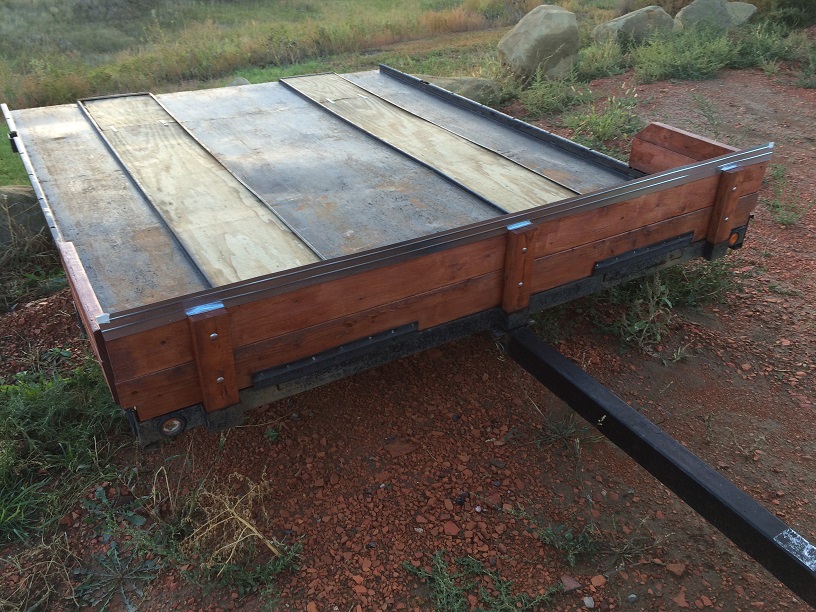

I was extremely disappointed in how grimy and dirty my sleds got when I pulled to Waconia last winter, so here's a cheap way I installed a salt shield to my trailer. I think I got about $65 in the lumber, hardware, flashing, and stain/varnish. With the two - 2x6, plus the aluminum flashing, it reaches a height that gets over the front bumper. That's fine, as the covers reach part way down the belly pan, so now I shouldn't have any salt and road grime all over the skis, and belly pan & skids. Maybe the back end of the skids, but that would be minor.
