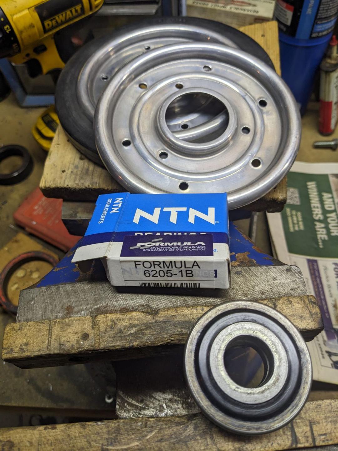

A number of years ago I bought a box of 6205 bearings off ebay for a good price. I have been rebuilding my aluminum center idlers for getting close to 20 years now. However, the sleds I had put those particular bearings in had not gotten much use. A friend peer pressured / bullied me into doing a set for his Dator, then after a seasons use complained that the bearings were already crunchy.
That was all the data I needed to throw the box under the bench. Since then, I have been using NTN bearings sourced from Wahl Racing, with good results so far. If you price these bearings, you will find a huge range in prices, and you really can't tell what you are getting by looking at them.

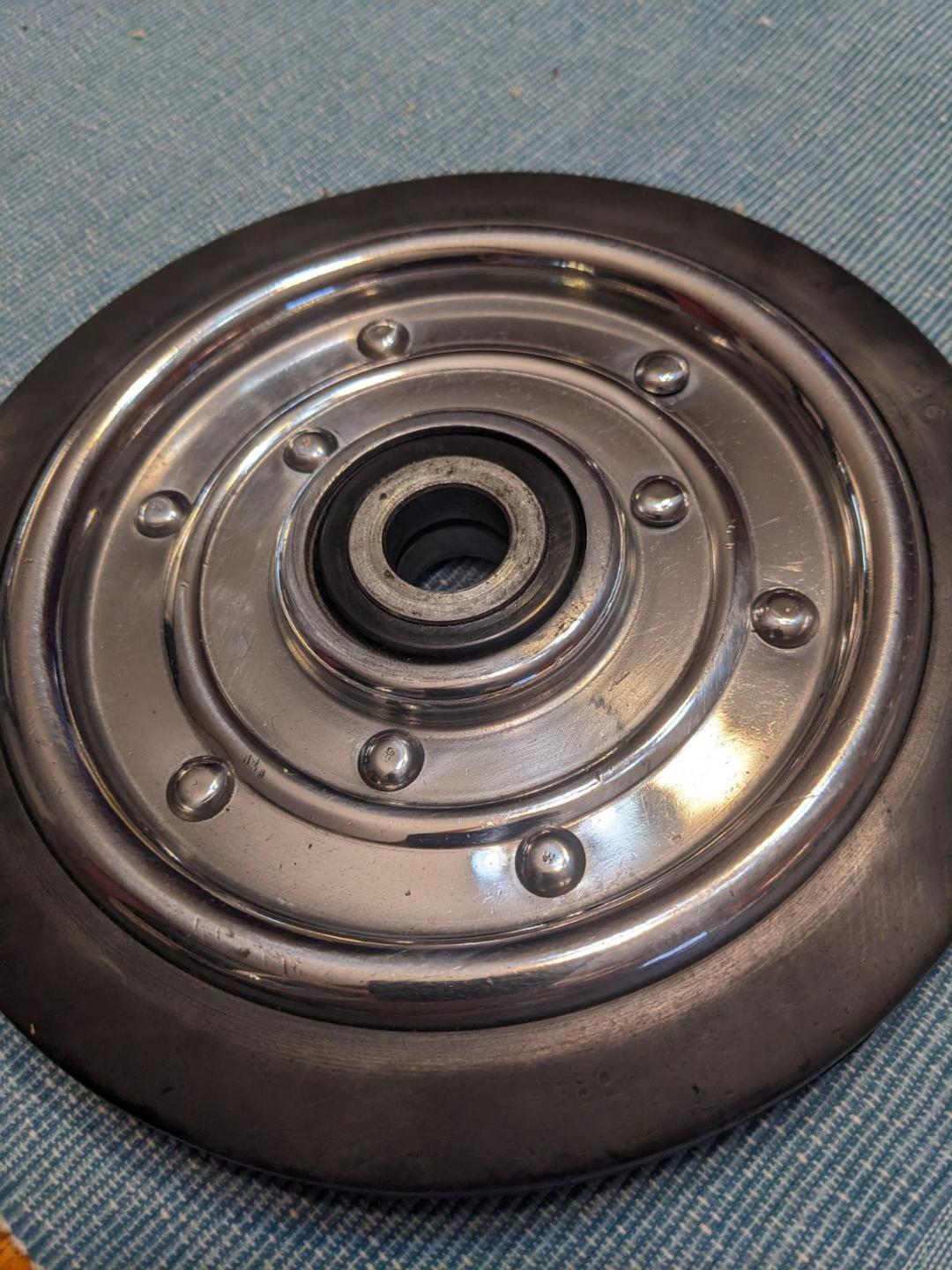

Finished up the first of two rear idlers I needed to do for the 78 CC clone. Swapping out bearings that I have since learned were not up to the task. When I started re-assembly a week ago, I found the rivets I had on hand were not to my liking.
I received my order from Wicks Aircraft Supply on Monday after ordering them the previous Wed night. The rivets I use are aircraft grade, dome head, and dead soft. 3/16 dia x 1/2 long.
New rivets make a huge difference! Dead soft rivets harden over time, and the ones I had were 10+ years old. The fresh ones set much easier, you could hear the difference in the hammer blow. Three or four strikes and they are set.
A quick polish brought the previously polished centers back around, good to go.

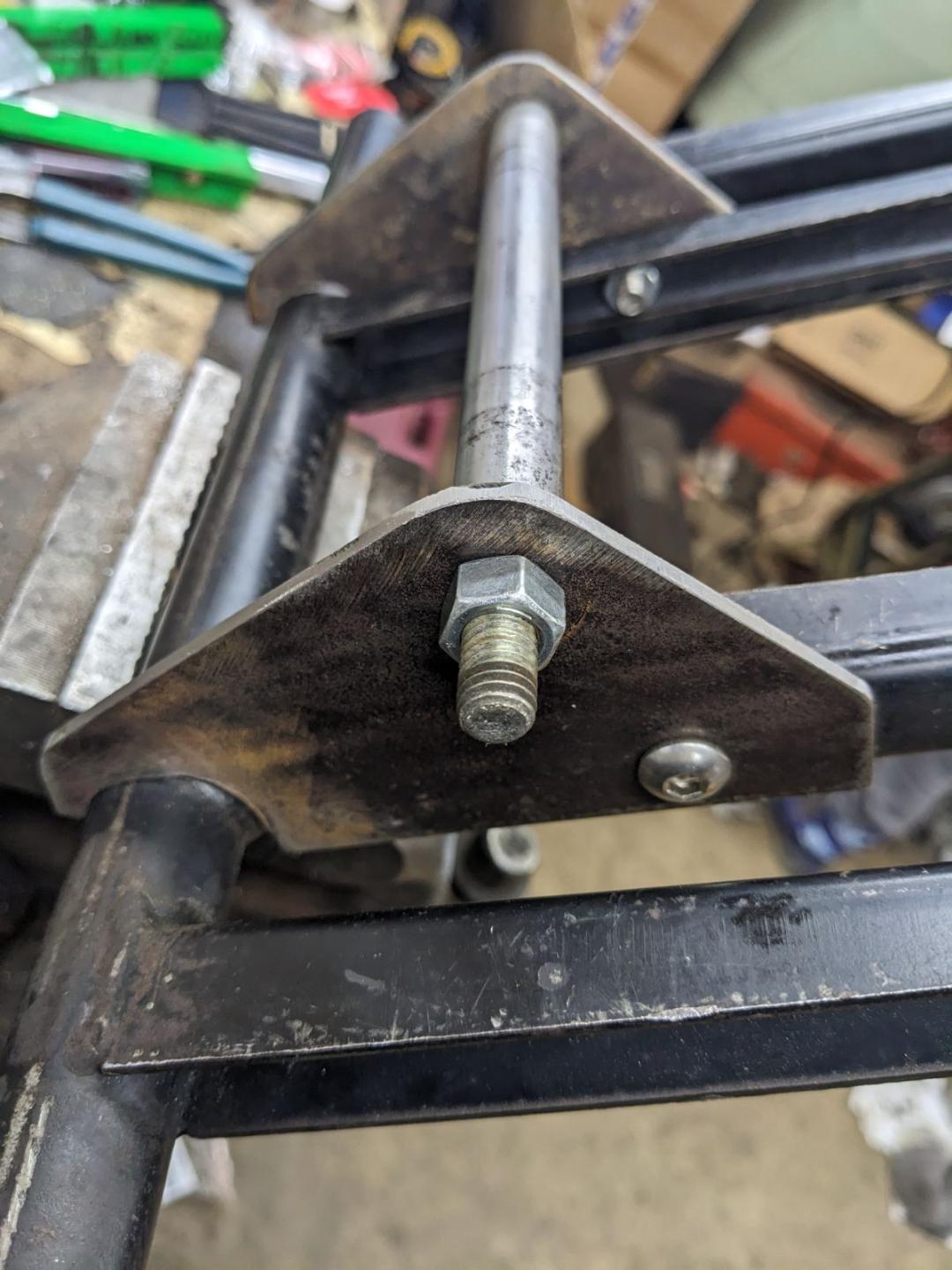

I guess this is what I am going to go with on my rear arm. It places the idlers a bit higher than the 80 LF idlers, but considerably lower than the placement of the original CC shaft that was mounted separately in the tunnel.
Just needs a few beads of weld to lock it in place.

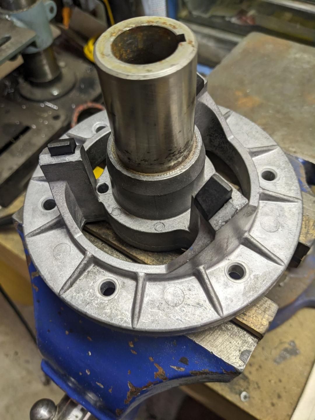

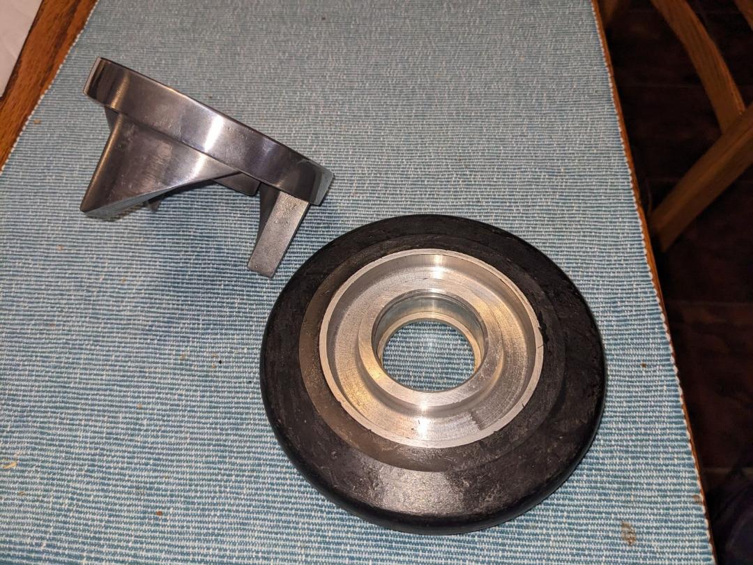

Decided to get the secondary clean and freshened up. Took it apart Christmas night ( decompressing a bit ). My intention was to soda blast the aluminum hub and helix, but my soda blasting media had turned into a solid. I have a coffee can of chunkage in the oven hoping a can grind it back into a powder. I only need a very small amount for this job. If it doesn't work I'll have to satisfied with a good wire brushing.
The sheaves show no obvious wear, just the typical corrosion where the belt sits. The sheaves have been sanded smooth, and I think I will paint the outside one silver to give it a fresh look.
The helix has been sanded smooth and polished, not quite to chrome standards, but a lot better than the gray fur it was before.

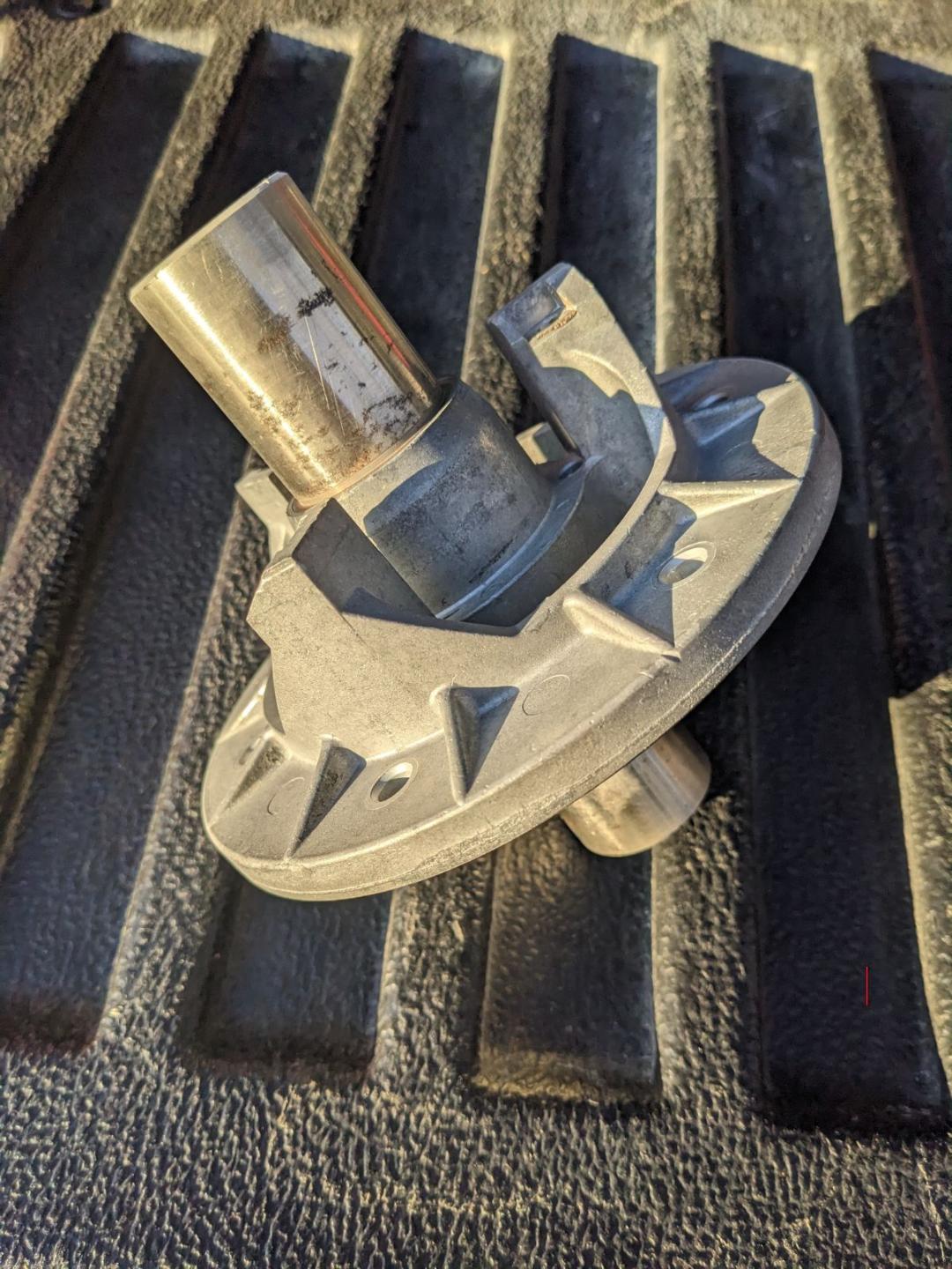

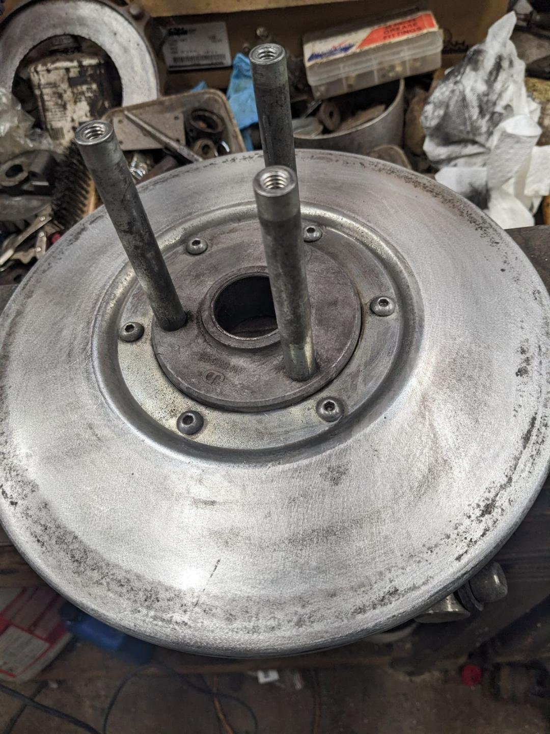

It turned out there was enough soda left in the gun to clean the secondary hub up! So I am a step closer to reassembling the secondary.

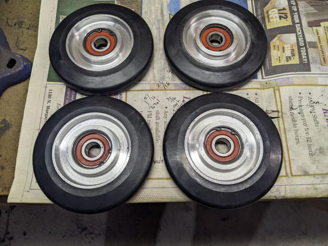

I had two new bearings on hand, so they have been installed into the auxiliary idler wheels. The second set of wheels have been cleaned up and are waiting for another pair of new bearings to arrive.
I ran into some issues that gave rise to a number of questions when I tore this suspension down, and it took a conference with Tom Rehberg to sort it out. I was seeing a mixture of shaft and bearing IDs. Apparently it is not uncommon to find idlers with 5/8" IDs, and others with 17 mm. Being as I had some shafts that needed replacing, I started looking for some 17 mm steel shaft, only to find it was not common, and expensive when you did find it.
Tom assured me I could get bearings with a 5/8" ID, and go with commonly available 5/8" shaft. He was correct, Wahl Racing carries NTN bearing 6203LLU/15.875 , which has a diameter of 40mm x 12mm wide x an ID of 15.875mm ( which is 5/8").
That is the bearing that is installed in the wheels here, and the new 5/8" axles were cut, drilled, and tapped almost a year ago.

The secondary sheaves were quite dull after the grime was cleaned off, so they got a coat of Argent Silver, which is Case/IH wheel color ( what I have on hand ). I use this on Kioritz engine tin as well. As soon as the paint dries, final assembly can begin.

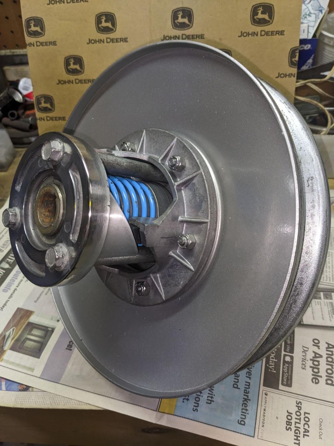

Assembled the secondary clutch tonight.
The entire process was:
Disassemble and clean
Soda blast the moveable aluminum hub
Sand and paint the sheaves
Install new plastic buttons
Sand and polish exterior and ramps on the helix
Reassemble hub to sheave with new stainless nyloc nuts
Install new spring
Bolt helix to the towers per book specs
Doesn't look like factory new, but the sled is going to be a rider, so I think I can live with it.

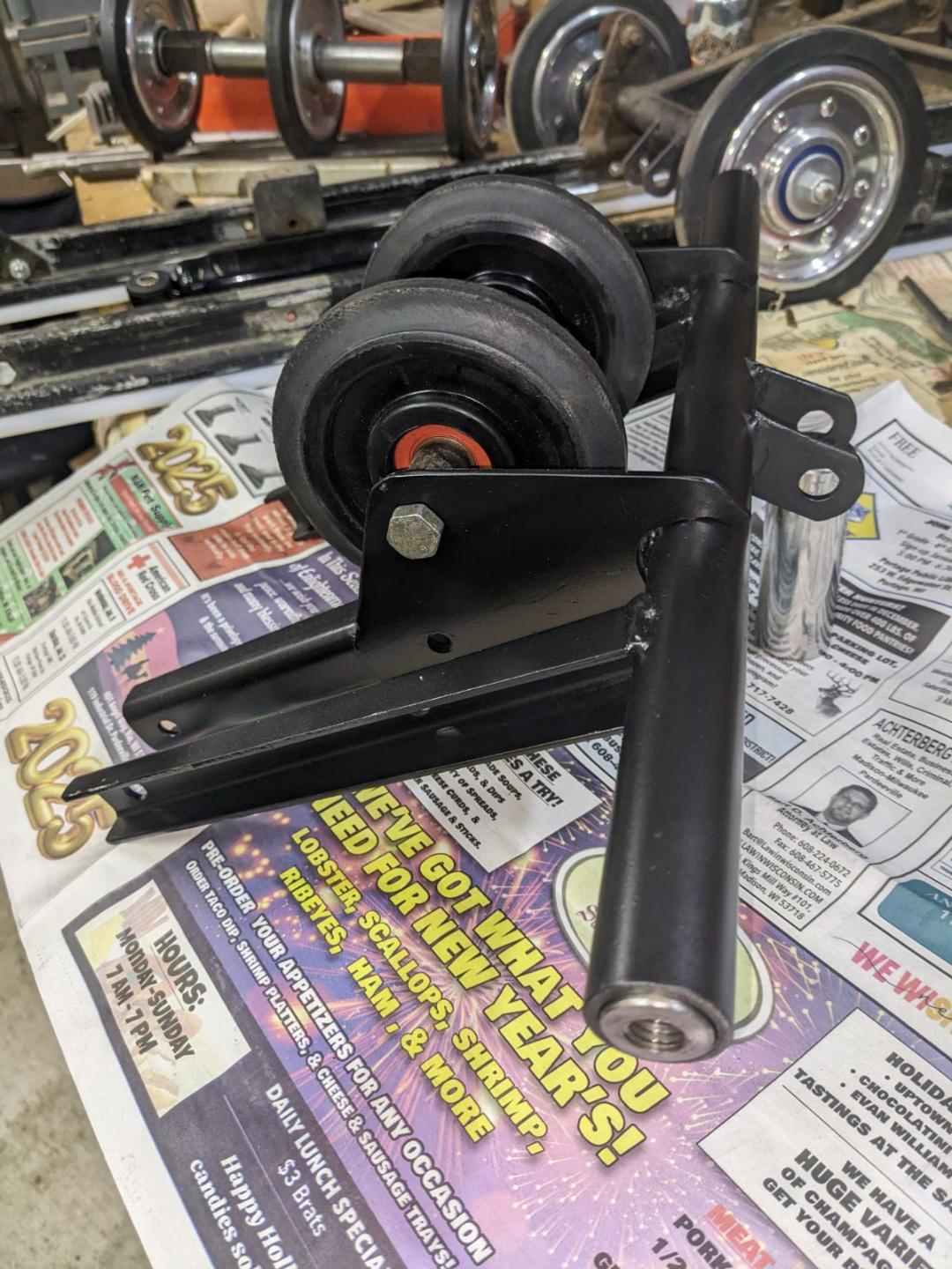

Small progress. The rear arm has had some welding done, and is now sporting fresh paint.
The spacers on the idler shaft have some deep grooves worn into them, so they need to be replaced. I have a piece of new tube sitting in the vice, ready for new spacers to be cut from it.
Bit by bit the suspension will get fresh paint before it gets installed into the tunnel.
