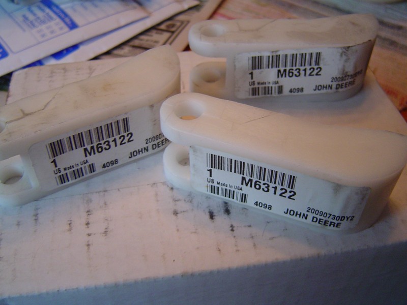

Re: 295/S Chaincase Fail
FYI
The nylon tensioners are still a good part number. You can get new ones straight from JD, less than $10 ea.

Brian, thanks for the tip on the tensioners, didn't know that.

Brian, I didn't know those tensioners were current either, thanks for posting that. Funny how a few parts have stayed current since 84, like taillights, tank grommets, those tensionser, the recoil sticker on a Dator, the suspension cross bolt that goes from center idler to center idler on the 80's LF. We might need to update the FAQ on that topic...

Actually the tensioners are already listed in the FAQs, I looked, as I was going to add them. They were added 4 or 5 years ago. There has gotten to be so much info here we can't remember it all. :beers;
