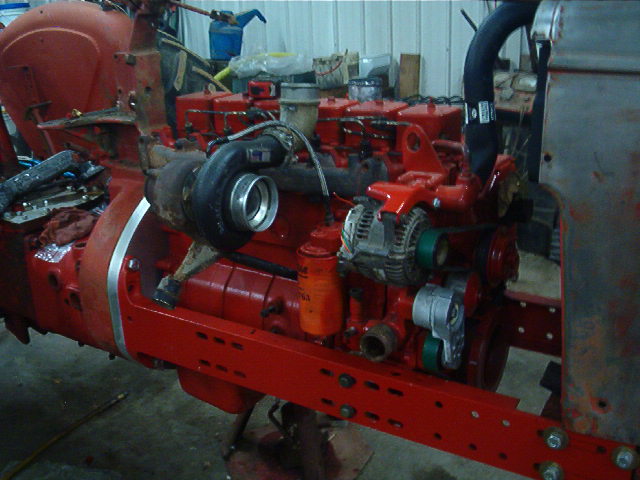

Ok so I Haven't been working on sleds much lately. Since theres no snow (anymore anyway) I have been working on my Farmall Super M for tractor pulling next summer. Finally seeing some progess on it. 6 cylinder cummins with a turbo ought to make it sing. Hoping to crank it up soon.....

Re: Winter Project for Summer
Dustin,
You have been telling me about this project for a while now, and i must say, that thing looks sweet! It really fit together better than i expected. Keep up the good work, and keep the pics "Cummin"
Is that a piece of 1.5" SS plate for an adapter?
Todd thats 35 pounds of 1 1/2" of aluminum.
Are those 806 frame rails?
Dustin
Those are 06 or 56 series frames from a gas engine tractor. The diesel rails would have a notch cut out so the fuel pump accessory drive would fit.
You are correct. I forgot that the timing cover was so much larger on the diesel tractors. Good eye Pat.
Those frame rails are actually off a 560. I am waiting for 2 last parts to come and its ready to start (Flywheel bolts and clutch)
DE correction a 560 hood is a mile and 1/2 long. The hood will need about 6" stretch, not too bad. another picture- it may not seem like alot of progress but its coming got guages, intake, wiring, steering all done. Found and M&W gear reduction starter for it so it should crank the cummins
Well after waiting for parts (and waiting some more) and delays. I finally got all my parts and time to get the ole cummins fired up. (good enough to run and drive under its own power) more Pics coming soon....
