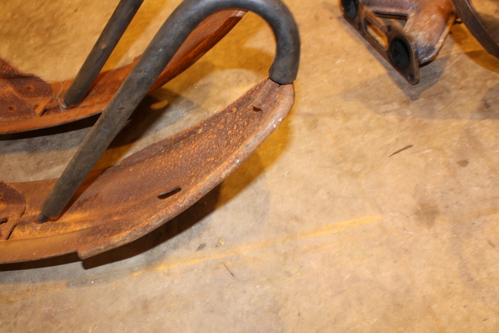

Here is a pair of NOS skis I cam across for the restoration. Interesting reinforcement on the ends. I was told it was for the Canadian sleds, but am not really sure about that.

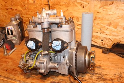

A little update on the progress. The motor is back together and ready to be dropped back in!

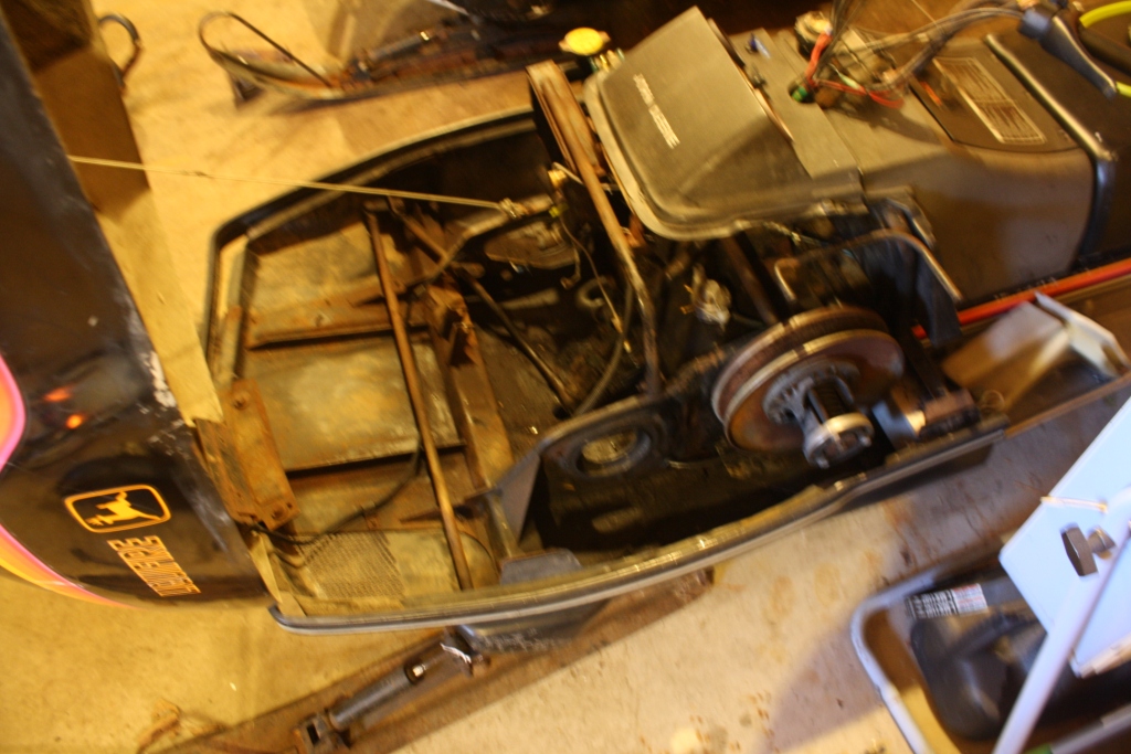

It has been a while since I posted about this project, but moving slowed it down a bit. In the last few days, I have gotten the sled mostly torn down. Decals came in last week. I still have to split the tunnel and bulkhead, but I hope to start media blasting parts this week. I will try to get some pictures up as soon as I can.

The OEM ski's were part number AM55307 and back in the day Deere listed them as Ski Welded SWEDISH......I don't remember if we found out about them through service bulletins or if the Consumer Product person told us about them..I do remember ordering a couple sets for myself and I think it was around the time I set my 84 liquifire up at the dealership..Mark

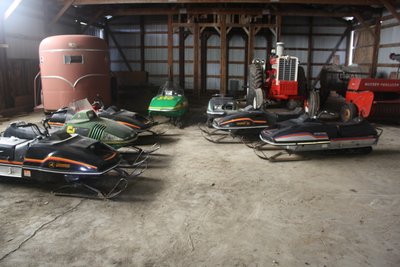

Mark S, thanks for the info on those skis! Do you happen to know what the purpose was for building them that way? Here are a few pictures of the progress on disassembly. I also snapped a shot of a few of the sleds while I was cleaning up the shop. Monday, I started with the sled completely together minus the engine. My wife was out of town and I had plenty of beer. Amazing what progress can be made! :D

Very nice 1206! I always thought the white rear rims, radiator support, and fenders was a cool look. Too bad you can only use them in weather above about 50 degrees lol.

Post by ihengineer76 »
Thanks JD600, I restored that a couple years ago. I only has a little over 2300 hours on it. And thank God for the block heater!
