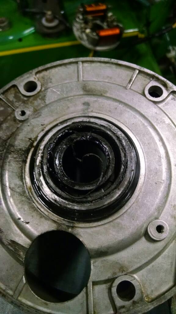

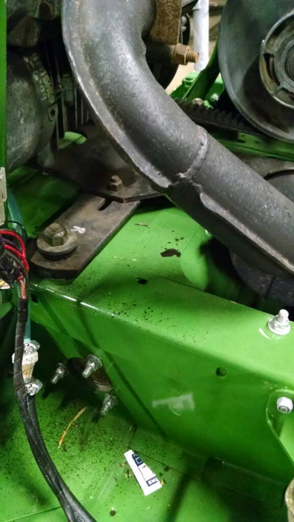

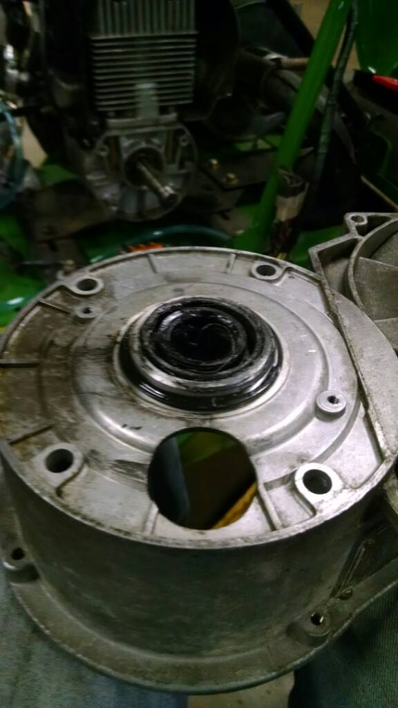

Just finished the seals tonight and got her running again. Couple of things that I have some questions about... 1) when I have the engine running for a while and get it "hot" I'll turn it off for about 15 seconds or so and try to start it again.. Its a (bad word) to get started again once its hot. Once I have it going though, it runs awesome. Would that be to a sticky advance for the timing?? The timing seems a little advanced when it's running too, like I'll need to retard it a little bit. 2) why is my exhaust system spitting "unburnt gas" out all over the belly pan? I'll post some pics to explain what I'm talking about!

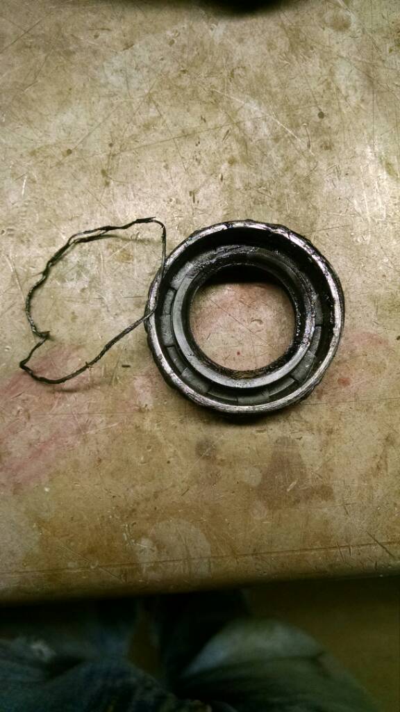

it appears that the old seal was rubbing against the bearing...

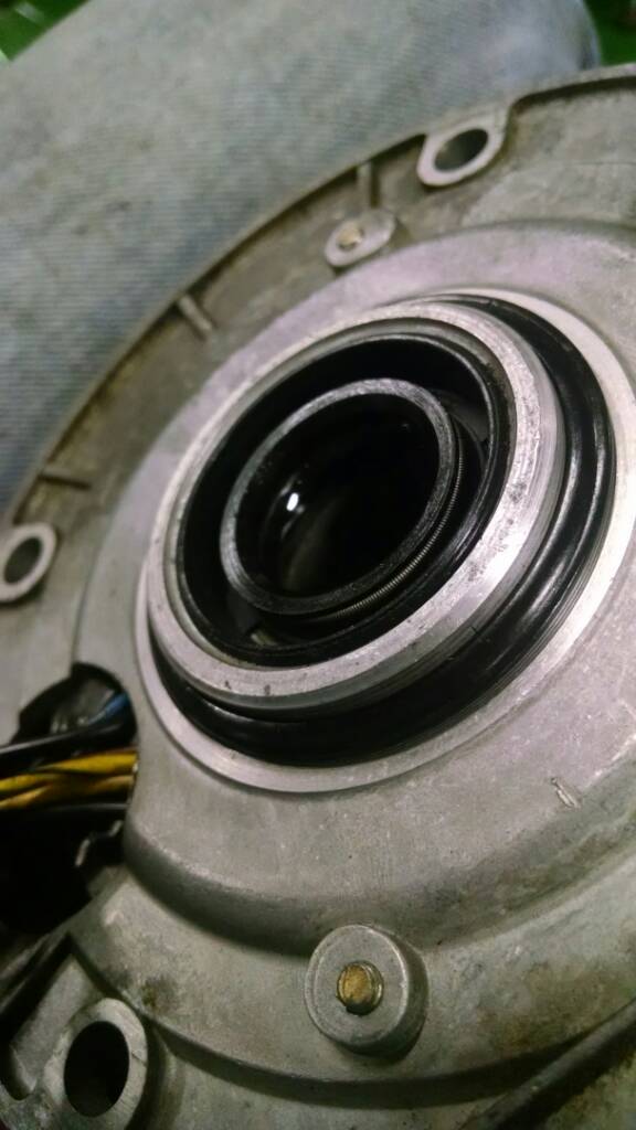

And here is the new one!

And thanks to some helpful info from "bigjeff" I got her put back together and running.

So here's that unburnt stuff I was talking about.. any idea what causes that or what that's indicating?

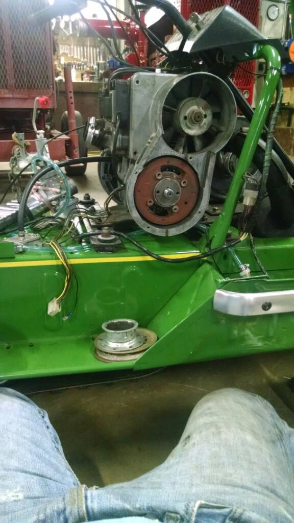

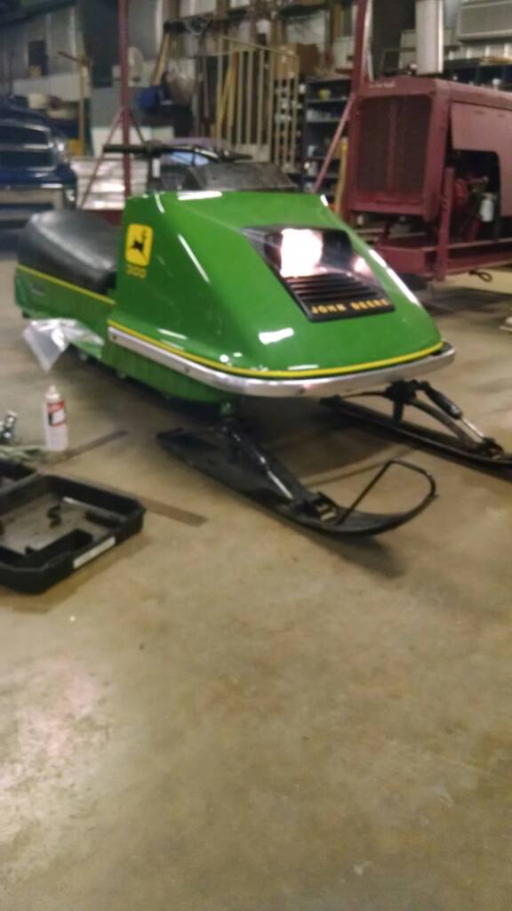

Rylie she looks nice I'm jealous of your shop looks like my dream shop lots of room . When I get a chance Ill post some pictures of my 300. Jeff

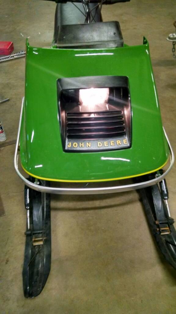

Thanks Jeff! We'll since no one has picked apart my sled from the pics yet, I'll point out some problems lol. One thing I realized about 2 months ago was that I have the front shocks mounted wrong.. They're on the outside now, and should be the other way around
And thanks for the compliment on the shop! Wish it was actually mine, but that's the perk for working for a water/wastewater municipality

Check your plugs after you shut it off, see if they are soaking wet. The excess oil/gas at the exhaust is also a sign of it running too rich.Waterboy7 wrote:Just finished the seals tonight and got her running again. Couple of things that I have some questions about... 1) when I have the engine running for a while and get it "hot" I'll turn it off for about 15 seconds or so and try to start it again.. Its a (bad word) to get started again once its hot. Once I have it going though, it runs awesome. Would that be to a sticky advance for the timing?? The timing seems a little advanced when it's running too, like I'll need to retard it a little bit. 2) why is my exhaust system spitting "unburnt gas" out all over the belly pan? I'll post some pics to explain what I'm talking about!
