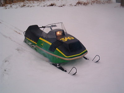

Good Day Gentlemen! Am new to this Board but have been riding Deere's since 1973.... JDX 4.... I am thinking of creating a Liquidator clone....Starting with a 76 340 Liquifire as a start. Comments or thoughts. Craig

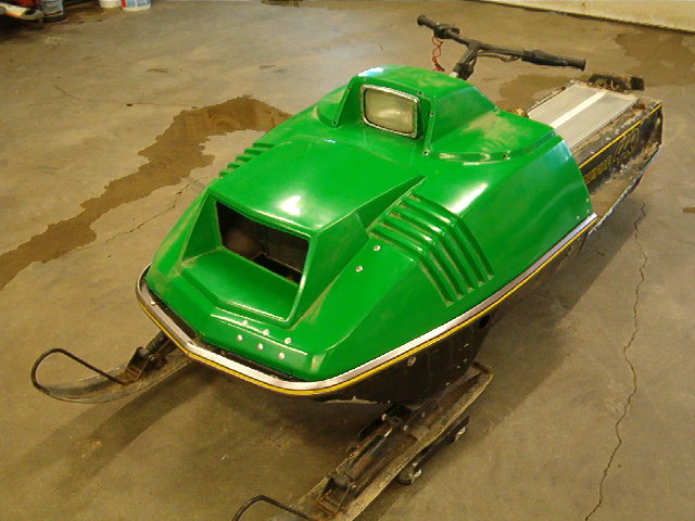

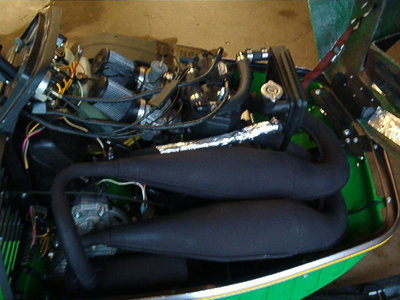

I did a clone couple yrs ago and have had fun with it since. Started with a 76 440 Liquifire. Repop hoods are available, This is what i used. I could have used a liquifire engine and with paint and decals had a nice clone. But doing project like i do I went with a bigger engine. Used a 650 wildcat engine from an 88 wildcat. :bonk: It was alot of work but i wanted something different as I have the real thing too. It has a jd chaincase and suspension from an 80 LF. Track is from the wildcat.
Its all about what what you want in the end its your sled. :think:

thanks for the comments... and the heads up on the hood. Are the bars on the 79's and above the same as on the Liquidator...aside from the chrome??? Anyone got a line on a Hays hydraulic system? or 78 suspension?... I see that there are cooling parts available...any ideas on a radiator?....for entertainment... had a blast at my first relic run. Gonna have to compete with my brothers cat....picture attached... and my last rest.... a 72 Alpine... was a lot of fun... and great for trail marking... though turned like herding sheep!!!
