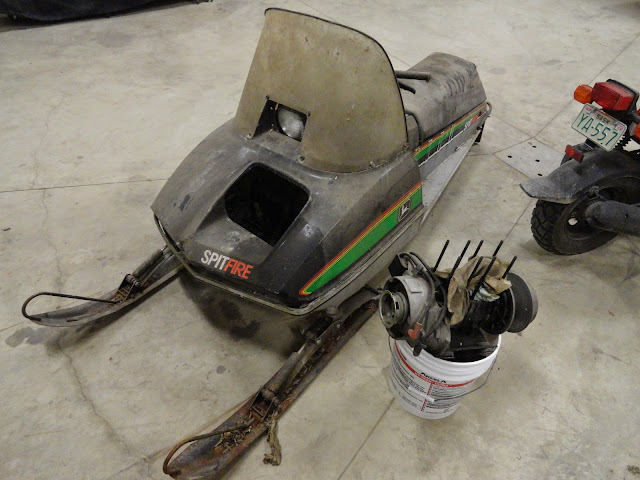

A guy I worked with asked me if I was interested in his old Spitfire. I have kinda always wanted a free air machine and my boy and I have talked about the Spitfire in particular so when the guy asked I said "Sure! How much?" . He responded with "I dunno. How bout a case of beer? I just want it to go to someone who will have fun with it." Done deal. I went out to his farm the other day to pick it up. Turns out he burned up a piston in it back in the day and then parked it. He had pulled the engine, taken it apart, and put all the parts in cupboard. The sled sat in the barn up on blocks so the track is in pretty nice shape. Other than a good cleaning and engine rebuild its a pretty easy one to get going again. My Scorpion is nearly finished except for the hood, so while I wait on that I'm going to clean this Spitfire.

Spent the whole afternoon cleaning this thing. Stripped it down, sprayed the whole thing with citrkleen and hit it with the pressure washer. The fuel tank was the worst. Ball bearings and citrikleen then the pressure washer took care of that. A little wax on the hood and new hardware for the windshield as well. New hi fax and wear bars tomorrow.

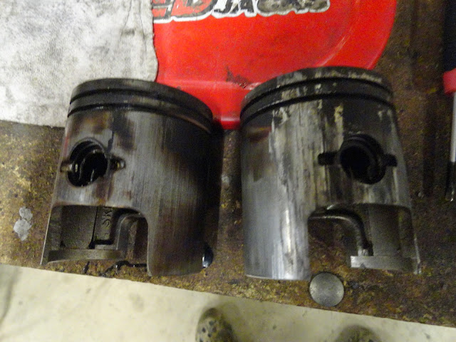

I have been picking away that the engine all week. The crank and bearings are in very nice shape. Most everything needed a good soaking in the hot tank and a pressure wash. Here are the old pistons.

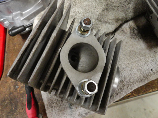

I can see why this engine failed. It was sucking air all over the place. The crank seals were both pooched. The intake sides of the jugs were really beat up. This part I don't understand. I looked like someone had been hitting them with something. I put them in the mill and faced 0.015" off the intake side and then 0.007" off the exhaust side to square everything up. The exhaust side loaded with carbon scale. It couldn't be scraped off. It would have taken me hours. I media blasted it instead.
