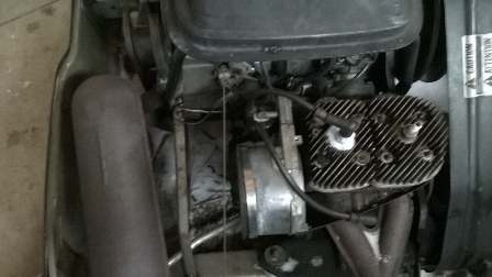

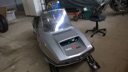

Ok I'm new to snowmobiles I have experience riding other peoples, but I've never really worked on one. But I never back down from a challenge. So here it is a few days ago I picked up a 1980 trailfire 440, it is in what I believe is pretty good shape, a few flaws here and there, but by no means bad.

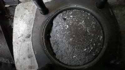

The engine however is another story! The previous owner told me that he didn't have an airbox on it, he said that he took of riding one day, not sure how long said it started to bog down so he went home and stopped it stalled he tried to pull the cord and it was locked up. He said he didn't try anything else. When I figure out how I will post pictures. I do need the pto side jug for sure and piston. If anyone knows where to get them that would be much appreciated. Thanks all. Matt

Got it now, ok more pictures coming

Just to pull the engine and replace the cranks seals too while you are at it.
