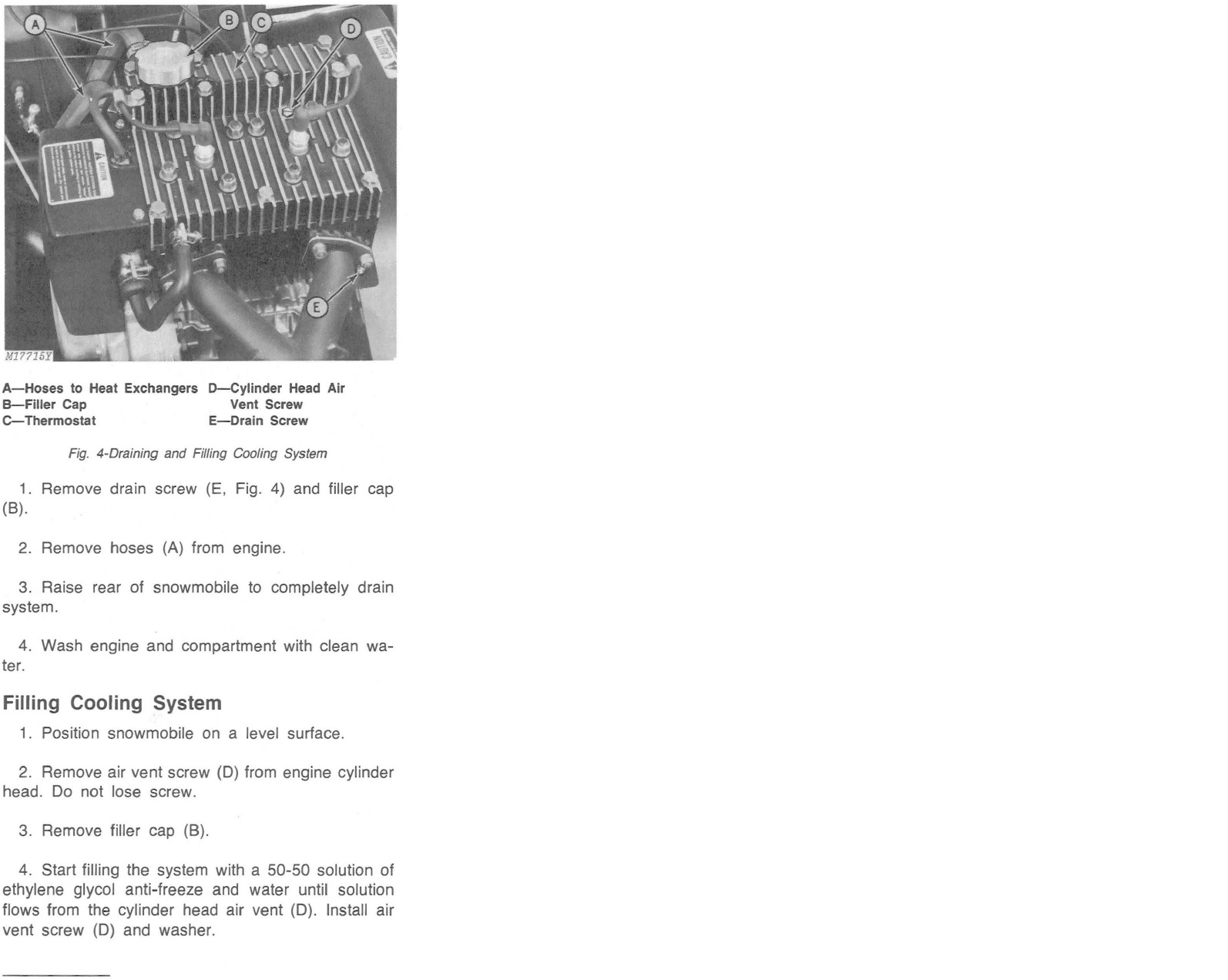

I am finishing up my 78 liquifire and I need to know how to burp the coolant system. I put the front up on blocks with the back down to keep the place where you fill it the highest point. Filled the coolant system and tried to squeeze the hoses as much as possible, then started it and got it warm, but didn't see no burp or air pocket come out, just wondering if I need to do anything else or if there is a secret to getting the air out of the coolant system.
Thanks!!

Follow steps in picture.

THANKS!!
