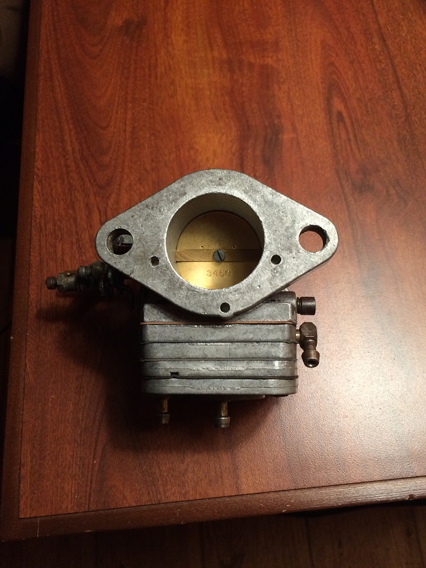

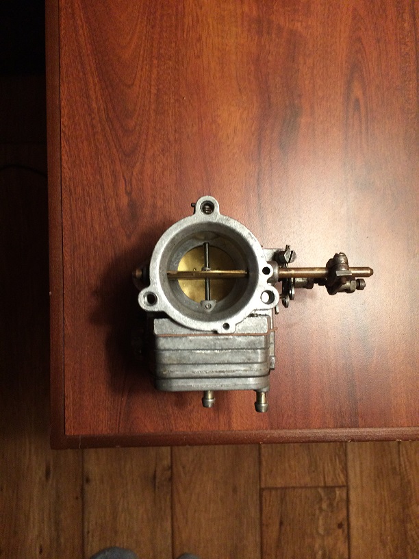

Made a little progress this week. I got the carb rebuilt. Other than being filthy on the outside, the internals were actually fairly clean. I was told that the original owner did start the sled each year, even if he never put it on the trails. So that probably accounts for why it looked like that. Always good to keep the gas flowing through them.

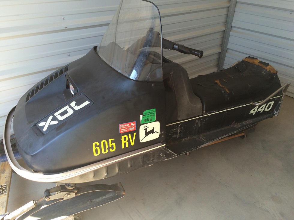

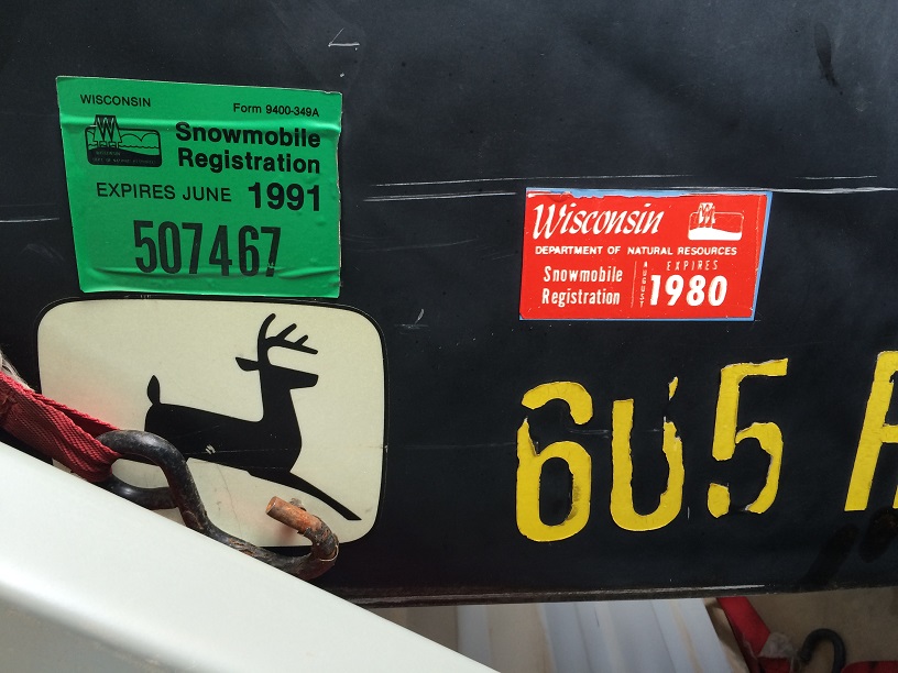

I also thought the trail tags from Wisconsin were interesting. The last tag it had was 91'. Next to it was from 1980. I was kinda curious, so I removed that one to find the very first tag when the sled was new. It appears to me that Wisconsin originally issued them every 3 years. Didn't make sense at first, since this is a 75' model, but it would have been sold in the fall of 74' so the owner got it registered possibly in November of that year; hence why it expired in 77'. Somewhere along the line it must have switched to 2 year registrations, because the last tag should have been 92'. Maybe you guys from Wisconsin can speak to that. It's fun to see the time line on these old sleds.

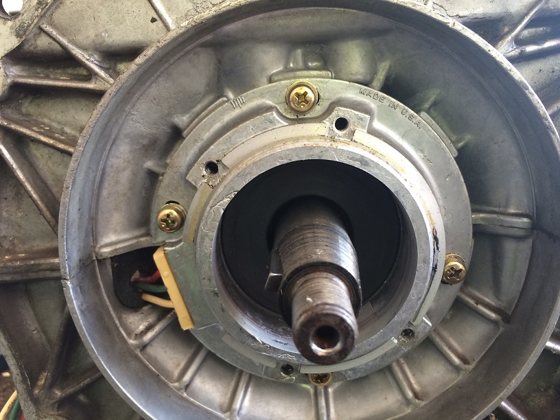

Got the stator out tonight. I have the replacements from Hewtech. I am impressed how tight the windings are on the rewound stators compared to original equipment. Must be why they are so recommended for re-builds/restorations.

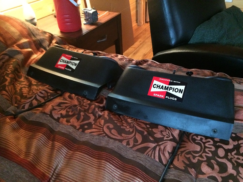

This X8 did not come with a tach. I've read that this was an option that could have been installed at the dealer, but this one didn't have it.
I've had a NOS one for a while, so I installed it in the dash. Since I'm working on the 800 as well, I had that one for reference. The one on the left is the dash I installed the new tach. Turned out pretty good.

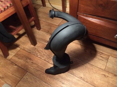

Tuned pipe was done last night. Lot of wire brush and sanding wheel to remove all the rust first. Primed and painted with High Temp paint.
