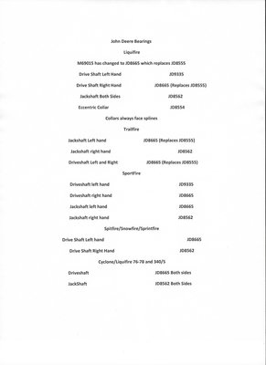

I was asked to post this here. I only use bearings from John Deere and while I know some folks don't care for that I only purchase the "better" bearings, never the "alternate" choice. Anyway I made myself a chart of bearing usage and I'll share it here.
John Deere Bearing Chart
