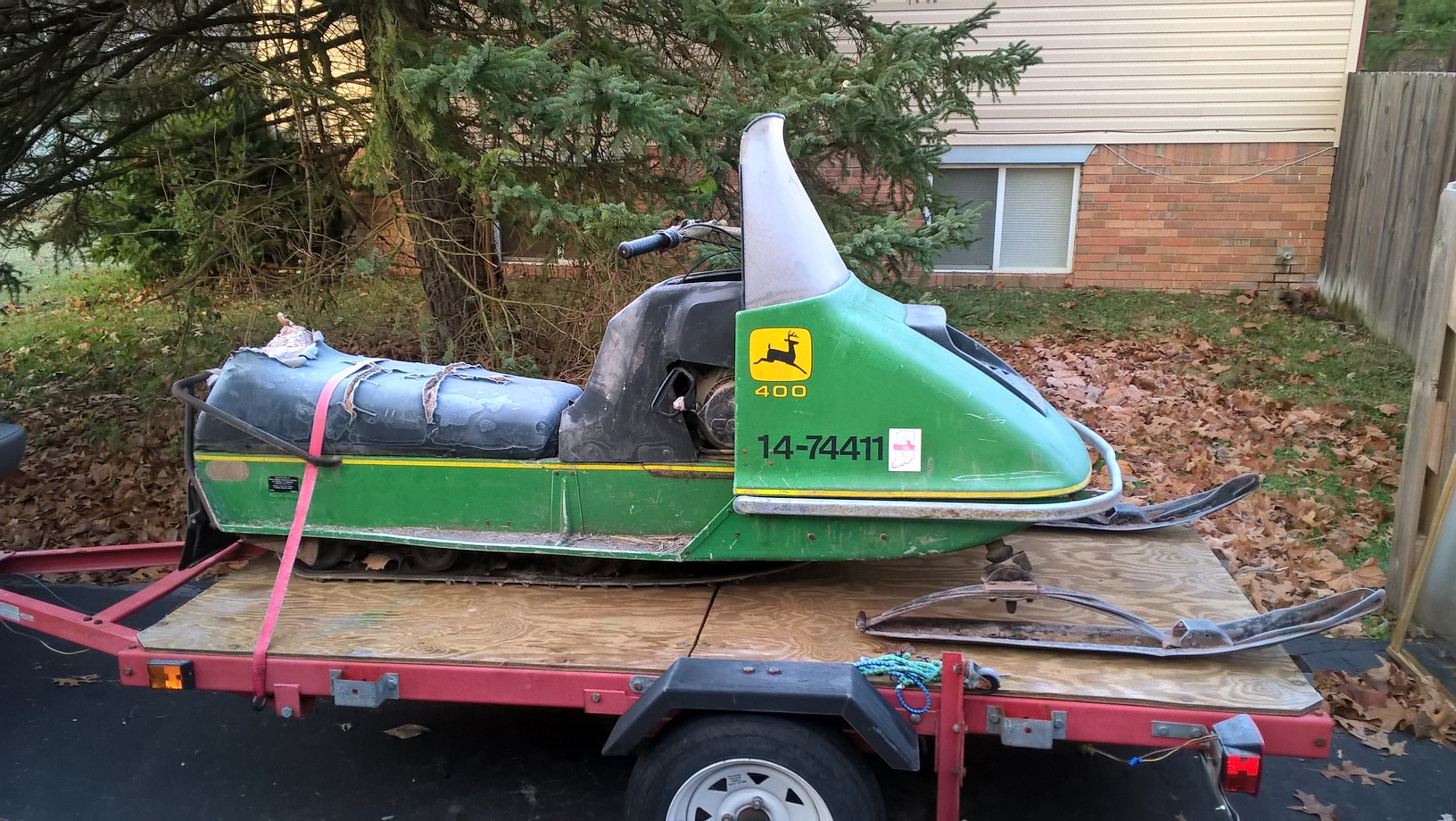

Long time lurker, first time poster.
Two years ago, I knew nothing about snowmobiles… especially vintage sleds. I came across a YouTube video of a hundred series Deere and loved the look much more than other brands. I jumped on Craigslist and like a light shining down from heaven, I found one in south central Indiana. A little haggling and 80 bucks later the all original (I think) 1972 400 was on my trailer. It’s a CCW with 1675 original miles. It was bought from Deere by this guy’s dad and he remembered scooting around the farm with it in the mid-80’s. But, it had been sitting in a barn ever since and hadn’t been registered since 1985.
After a whole lot more reading than wrenching, I was able to get it running and re-skinned the seat for the winter. I didn’t put much more than a few miles on it. Last winter, we about zero snow in Indianapolis so I didn’t get it out of the shed until a couple of days ago. The fever has set in again. I’m back to reading, tearing stuff apart, and more reading. My goal is to have the sled as an occasional rider (bc we only get occasional snow…) and not a restoration. I couldn’t care less if under the hood is the original paint, a little rust, etc. but it needs to run well and look good doing it. Something I can be “proud” of but not cry when it gets a scratch.
In the last two years, I’ve changed one crank seal but was too pansy to take the clutch/drive components off to get to the other one. To no one’s surprise, it throws a little oil so that needs done soon. I checked the compression and, if I remember correctly, it was 140’s for right side and high 130’s for the left.
I rebuilt the original Walbro carb but it was pretty dingy again this year. The crud in the metal gas tank is just too much, even with two fuel filters so I may change to plastic. For all the trouble others have had with the Walbro, I must’ve gotten lucky.
I look forward to checking out the transfer case, chain, and clutch. The white drivers have a few cracks, so I’ll eventually be looking for the black ones that might fit. But, the track is in a little worse shape than I thought, and I don’t know that I can adjust the tension much more, or correctly. So maybe I’ll wait until the drivers or track blows before dropping some coin on it. The steering is SUPER sloppy so I need to figure out the bushings situation and how to repair/replace that stuff. I saw some forum threads about it, but I might as well have been reading Japanese.
Cosmetically, I need a little fiberglass repair on the hood, all the old decals need replaced so I’ll be working on sourcing those. The rest will get sprayed green again bc green vintage sleds are my new addiction. Anything that was chrome probably won’t come clean enough so I’ll repaint them black. The headlight lens needs replaced, though I might try to put in LEDs for headlights. Oh, and the top console has been patched with aluminum due to some broken plastic.

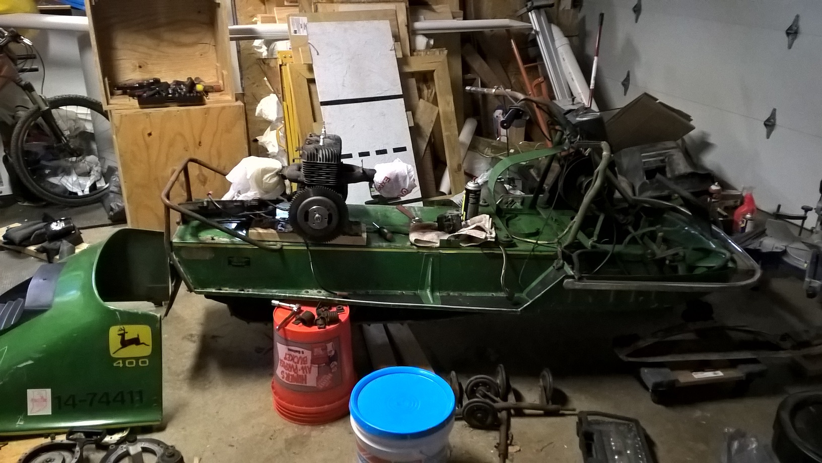

I feel like I'm moving right along on this project... I walked into the garage to grab a tape measure and somehow ended up scrubbing rust off the bumper with a wire brush. I never made it back in the house with the tape.
That bumper was brown with rust and I'm amazed at how well it cleaned up! I had planned to paint so I used a really rough paper (50 grit, I think). I used an old headlight lense restore kit to see if it'd polish, and while it's not perfect, I'm actually debating leaving the chrome now. I'll research how difficult it is to get good adhesion to chrome if I paint. If it's a headache, I'll leave it chrome and finish polishing once it's back on the sled.
I also continued with sanding the body of the sled and popping out some dents. It looks like someone shot a pellet gun at it because there's a ton of dents on one side. It won't look pretty painted, but oh well.
I'm basically only painting what you'll see, so I'm not concerned with how it looks under the hood even though that's a travesty to restoration gurus. I didn't even bother with taking all the bolts out. I figured I can always touch them up later after wrenching on 'em. And, I used two different primers bc that's what I had. The hood will get primed and painted eventually, but I just started the fiberglass repair, so I've got some Bondo work yet.
Continuing with the body work theme, I cleaned the windshield and popped off the rest of the black strip surrounding the windshield. I had to run a razor blade between the strip and the shield to break it apart. There's a ton of little wiping scratches on the windshield, and it's a little yellow, so eventually I'll do a restore on it with a headlight lense kit in hopes it doesn't look like I'm looking at the trail through beer goggles. Oh, and it was broken when I bought it, so I sheared off the bottom 1” or so of the shield and redrilled the holes. It obviously doesn't fit as perfectly as it did, but it's functional.
It's always a wallet shock when starting a project like this, and considering how much I'm not going to be able to use it, I might try to rebend the leaf springs and seal the gas tank with por 15. I found a broken saddle in the process of prepping the skis and hardware for paint, so I'm in the market for one of those, too.
The bushings have arrived so I'm excited to get those on. I think I'll end up needing to only replace one side of the tie rods, but I'll reassess once I actually get some skis on it again.
In the crank housing, I found the chain rubs the metal inside of the housing and is biased towards one side of the tensioners. I need to figure out why and what to do about it. So, it's back to reading!

Adam, Nothing wrong with doing these resto's a piece at a time, and just what you are able to do with what you got. Sometimes life or funding doesn't allow us to do it full blown. Looks like you really want to make this a rider, so I think you're going about it right. Fix what needs to be fixed.
Regarding your drive chain that is just a bit off and rubbing inside... I would check the part of your manual that addresses the sprockets and the drive shaft itself. I believe there is a spacer on the upper one which aligns it with the bottom sprocket (need to check that). If that isn't installed properly that chain cannot run true like it should.
The other thought is how the drive shaft is bolted to the tunnel and chain case. Or the shaft itself may be a little bent. Could be the secondary shaft is bent. You'll have to check things one at a time and eliminate each step until you figure out what is causing it. Good news is your tensioners look really good with not much wear, so you shouldn't need those.

The biggest bane of this sled (for this year) has been the secondary shaft... and the chain rubbing against the chaincase. Finally got it figured out with a ton of help from Matt in the Tech section. Someone has definitely fiddled with this sled more than I thought.
Long story shorter, my left side bearing (bearing that's actually in the chaincase) on the secondary shaft was turned the opposite direction, with the locking flange (looks like an attached spacer on the bearing) facing out; it needs to face towards the secondary clutch. That bearing had caused a little damage to the shaft including a rib that wouldn't allow either bearing to slide on one side of the shaft and off the other... it always got caught on this rib. Doubly important to note: apparently the shaft isn't supposed to be flush or protrude from the edge secondary clutch. After a couple of purchases from Matt at New Breed and JD, I had everything I needed to put it back together as it should be. It didn't have and o-ring or the spacer between the gear and the bearing.
I don't think I've mentioned the repainting of the hood. I couldn't get the sheen correct with the spray can on the hood. It was blotchy and looked terrible, so I tried to add a clear coat finish from a spray can and it actually peeled the paint. So I ended up using a stripper and stripped it off, along with some of the original green, and tried to sand it down. Unless I sanded it completely clean of the original green, I wasn't going to get a good, smooth finish. So, I decided I didn't care that much (bc it's a damaged/repaired hood anyway) and re-primed and painted. The sheen came out perfectly, but the up close all the imperfections are hard to tolerate. From a few feet away, it looks great, so that's how it's staying unless I get a new hood. I'll probably rub a little car wax over it to give it a little protection because I'm gun shy about trying to use the clear coat again.
Let's see how much of this thing I can get thrown back together today. I need to put the gas tank back in, replace filters, and reinstall fuel lines (just two years old). I used POR 15 and that stuff seems legit. I used CLR and rough cut gravel to shake inside the tank, let it sit, and shake some more to remove the rust deposits. I did this two years ago and it was back, which is why I used POR15 this time. After rinsing the tank with a hose, I poured some 91% rubbing alcohol in, sloshed it around, and dumped. I did that so it would dry faster than rinsing with water... again, rust prevention. To accelerate drying, I put tip of my heat gun in the fill port and turned it on low. Once dry, just dump the small can of POR in, slosh it around, and I turned it upside down to dry. I'm pretty sure I ruined a couple of gaskets on the fill port and fuel level gauge due to the POR getting on it. I needed a new gauge anyway.
Oh, the windshield... It wasn't as bad I thought. I probably should have just used a polishing compound and soft rag on it first, but I went straight to the headlight lens restore kit to try to freshen it up. It actually left a bunch of swirls (that it didn't leave on my headlight lenses) that I can't buff out. But, I can still see through it better than before and it looks clear, so again, good enough.
Hopefully I'll get some photos up soon!
