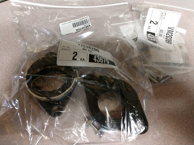

We will rewind to last fall, just before Thanksgiving. Adam had already rebuilt the Liquidator from last years I-500 attempt. This year she has nicasil bores over the iron as she scuffed one last year. Cari and I were flying up to see her family in NY for Thanksgiving, so I was planning to help Adam with the sled. He had talked me into a dyno tuning session at Jim Czekala's Dyno Tech Research in Batavia, NY and I am very glad we did it.
Squish was too large with the thicker Cometic gasket, so I swapped it back to the thinner one for the run. We loaded up my Dator motor, stock and Aaen pipes, his Cat motors, spares and after a brief 4 hrs of sleep we headed out.
This was time and money well spent. We found out the Aaen pipes are oversized for the little Dator, but in the rush to leave we forgot the stock stubby manifolds. So, we were not able to run the stock pipes this time. We were able to run the Aaen pipes on a stock Deere muffler which not only reduced sound, but gained back a lot of power. We made the needed tuning adjustments that would could to deal with the pipes, and went on to testing Adam's Cat motors for his new racer....

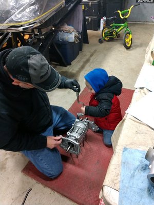

Aside from being under time pressure to get the basically new Liquifire motor together, another neat thing about it is that it will go down as the first motor Richard helped me with. He was very adamant that I let him help, and he even learned how to put sockets on bolts and snug them down. Working with my boy was probably the best part of this project.

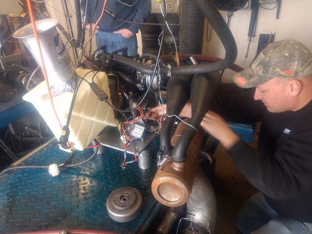

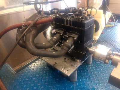

Calling the motor "rebuilt" isn't exactly accurate since only the flywheel, it's housing and recoil, the new CDI Box from last year, the gearbox, water and oil pumps, and a few manifolds actually carried over from the old engine. Everything else was new, reconditioned, rebuilt or NOS parts. Kind of like "Grampa's Ax"...
One large chassis part that was replaced after the motor was installed was the wiring harness. Luckily I had a spare NOS one on the shelf as this one has burned wires at the motor plug again, killing the lights when Jason borrowed her last year on the VC. So good bye to wiring issues and burned out bulbs.

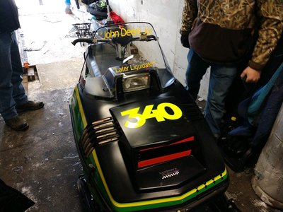

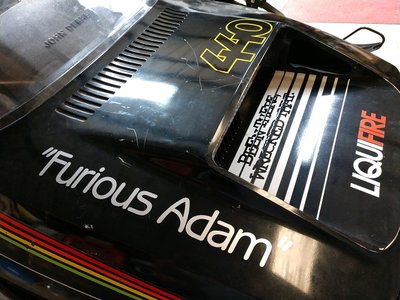

I also grabbed a hood from the barn and added a few stickers for Adam "I am not a John Deere Guy" Leubner to race with. Considering it was his second time racing the Liquifire, I figured he should have his own hood and not have to duct tape over my name on the old one.
"Furious Adam" refers to his affinity to Suzuki Fury sleds. I always say that "Hell have no wrath like Adam's Fury"...

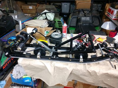

With the Liquifire set aside until more parts showed up, I finally jumped onto rebuilding the Liquidator rear skid. The Dator racer is built to be a "77 Style Updated-Up-Dator" with an aluminum suspension. I even used a spare set of Up-Dator wheel kit brackets, but with larger idler wheels as I am running a rubber track instead of the original cleated one. Luckily I had already sent the rear shocks out to Carver to be rebuilt and re-calibrated, and had received them back by early December. We chose to soften up the damping 'about 10%' from last year as Adam noticed the sled would occasionally want to kick you in the tail over moguls and bigger bumps. Turns out it was a good call.
The rest of the skid was basically "clean, inspect and repaint" before assembly, and I replaced the slides as a bent track clip chewed one up on the side a bit. The rear wheels posed a small problem, as I found that despite them being rebuilt by our idler wheel expert Lindner, the bearings were all toast. I started to rebuild another set, but get distracted by truck projects like fuel injection and water pumps.
So, I "Pulled a Rainville" as Lindner would put it. I tore the rear axle out of every steel skid I had until I had a pile of aluminum centered idlers to choose from. I picked the best two of the "late" style" with the large opening and black spacer/seal around the bearing and re-used them. For the center position, I installed a new bearing in a plastic 78 340 Cyclone idler and ran that. Problem solved for this year.

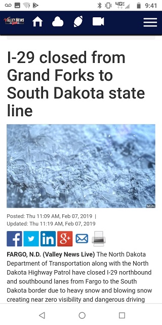

Except for one more hitch. South Dakota closed I-29 too, and much earlier, and much farther south. I found a traffic gate shut at I-29 and I-90, over FIVE hours from the casino and TRF. Rats.
OK, let Adam know, hit the rack early, and got up at 4:00 for the expected 5:00am reopening...
But they didn't reopen the road until 7:00am. Then it gets really aggravating. it got cold that night, down to about -15. Shouldn't have been a problem, but it very much was. I woke up to dead batteries and gelled fuel. We tried for an hour to jump the stubborn SOB to no avail. Running short on ideas and not wanting to get the truck towed, I called a Chevy dealer and had new batteries delivered...and they brought the wrong ones. So I rode back to dealership with my old ones to fix that. Finally, got the truck started, let the bottle of "Diesel Medic" do its job and let some heat thaw the fuel filter. Finally pulled out of Sioux Falls, SD around 1:00 pm Friday. Race was the next morning, and I was at least 5-6 hours out. GREAT.

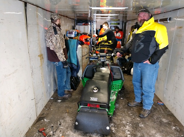

Returning to my trailer, I found that Dustin and Adam had more or less dealt with the remaining issues on the Liquifire and buttoned her up. We got the sleds tech'd and numbered, and started to finally layer and gear up. But during all this, the 100 plus sleds had already been leaving the starting line. Time was getting SHORT.
I was still in the trailer when I hear them call "Dave Chambers-Vintage +50 class...and that is your 2019 I-500 staring line up folks!" I finished pulling on my helmet, didn't grab my glasses, did grab my goggles and said to Adam: "We got to go, and go now!" He handed me a pack of hand warmer packets and said: "Just rip this open, they activate in air". Had he not done that last act of support, I would have been screwed later on...
So I pull up to the starting line and yell "Can I go"? The flag man asked if I had a transponder, which I pointed to my pocket. He waved the flag, and once again, a Liquidator was starting the I-500.
