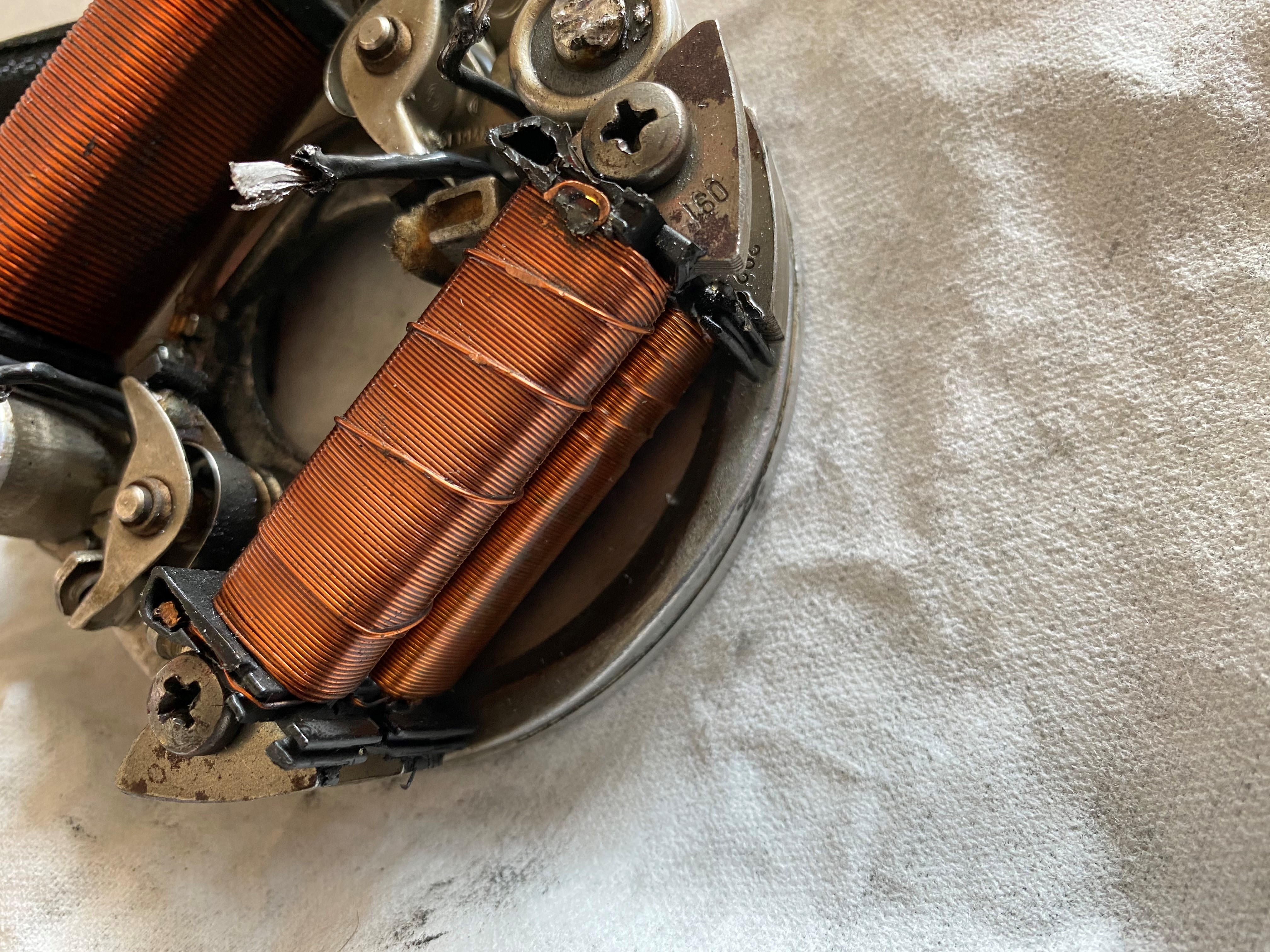

Went to remove my condensers and found this wire which looks like it has broken off , I think.
Should this be connected to the green wire?
Not sure if you guys can zoom into the pic.
Thanks]
I presume this needs to be replaced?

What specifically is this off of?
Re: I presume this needs to be replaced?
sorry a John Deere 300 K2952ax Thanks

I have no experience working on the Kohler point systems. I have worked on the Denso and Kokusan point systems on the Kioritz engines. A wire that is loose or disconnected or broken would certainly be a red flag. If you were lacking spark on that side, that sure might be the reason why.

It's hard to see but the wires that I see are loose get soldered to the condenser. You can see the same connections on the other condenser there.

Thanks guys I had a spare motor and had a look at that one and yes the wire was broke so I replaced the whole unit.
