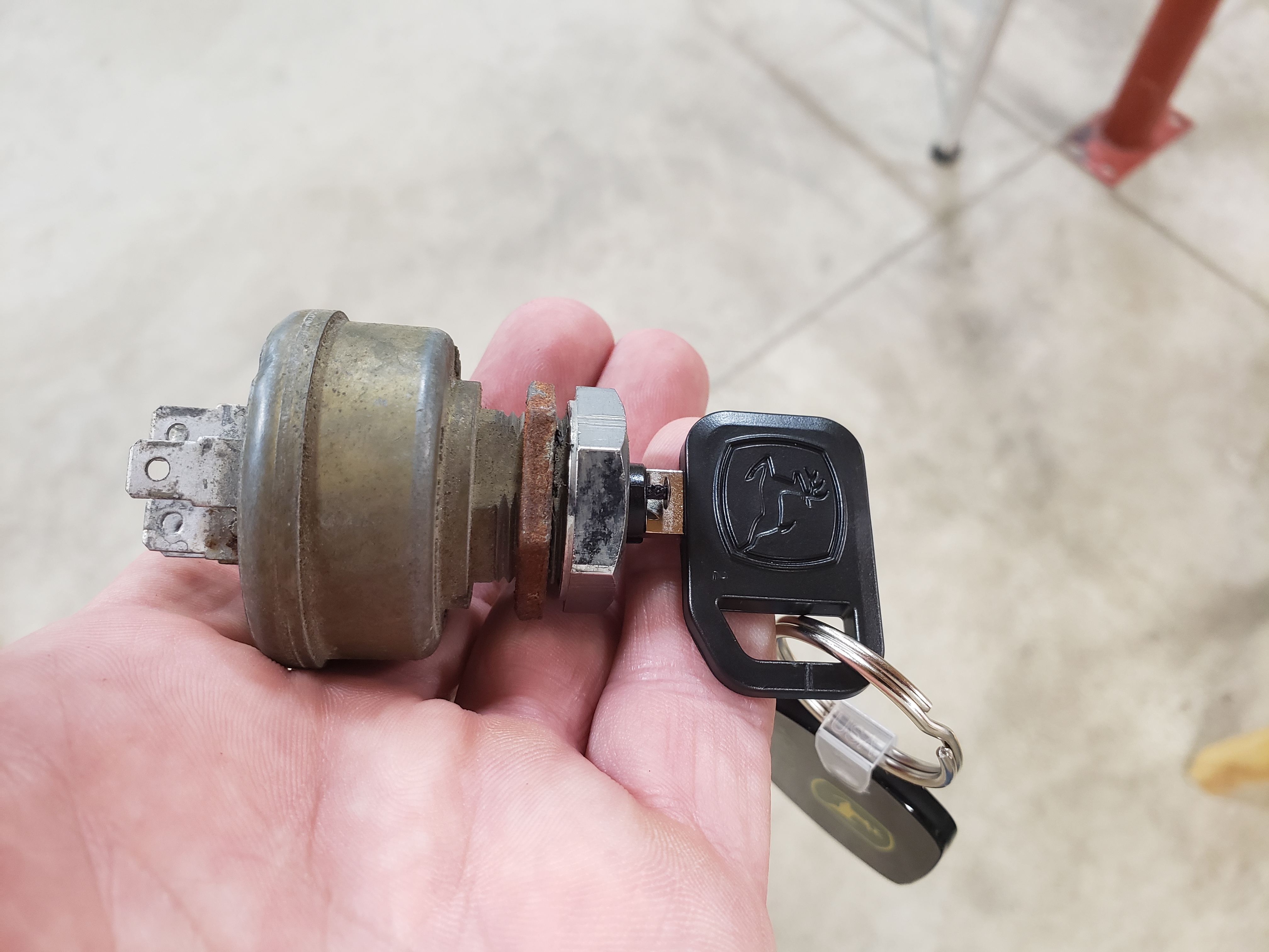

This may already be common knowledge but I thought I'd share.
A few months ago I acquired a sled with e-start. The original owner passed away and his family didn't know where the key was located. Jdparts shows the key as M63301, which is no longer available. After a little investigation I was pretty sure the OEM switches used the same key cut as the Gator and many of the newer mowers. Today I stopped by my local dealer and picked up AM131841. Works like a champ. Key even has the new style Deere logo.

Nice find Nick!!

Nice!
