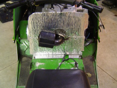

That is really hard to know, because Deere never did that R&D on these engines. If you look up the specs on a 440 Cyclone, you will find they were jetted HUGE, although the needle and needle jet might be relevant. I played with a Mikuni on a 340/5 piston port for a while 15 years ago, but eventually put a Walbro back on it so I could run the stock air box. I have no idea what the Mikuni I had was off of, as it was on the sled when I got it.
