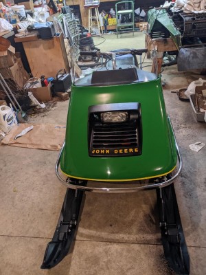

My son bought a Jdx4 1974 with I believe the kohler engine. Very tough starting to say least. Is that normal with these? Takes at least 5-6 pulls with full choke. One guy I know said to put a marine primer inline to get fuel to carb. Have you guys heard of this? Or is skidoo primer better option?

5 or 6 pulls warm or cold?

Make sure it has the check valve on the intake fuel line inside the tank. If not, then fuel will just drain back down. Although I would call 5-6 pulls an easy start if it's cold.

I recall 5-6 pulls on mine using the plunger style primer during a cold start. It would be more like 20 or better without a primer.

One other thing that I recall is that it helps to have the check ball fuel fitting hanging straight down in the tank rather than laying horizontal in the bottom. Another thing I really enjoy is electric start.
