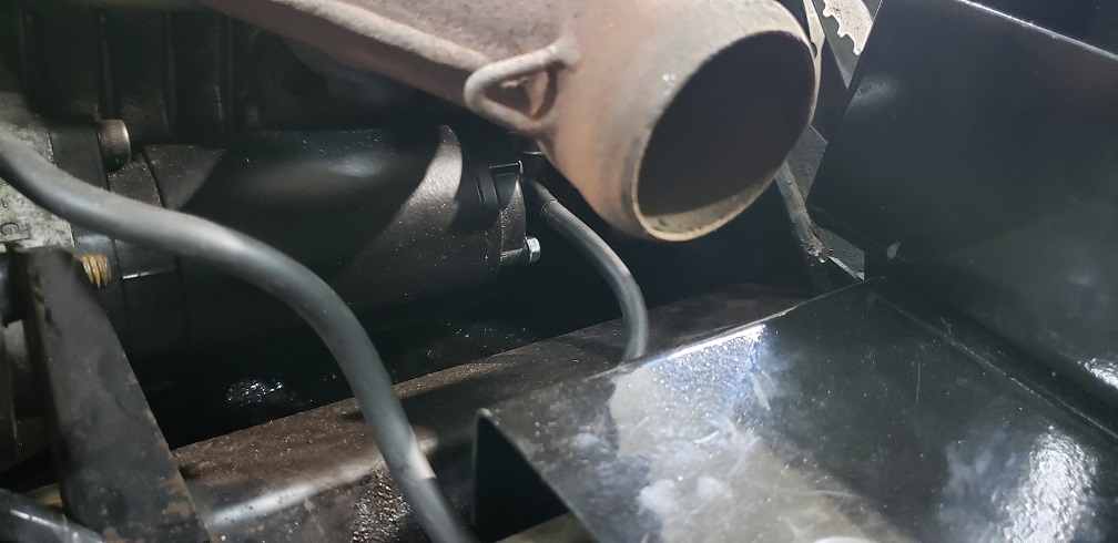

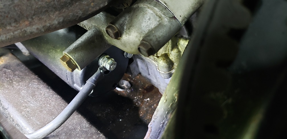

Yes, the JS440 starter motor will work. I have installed them on Trailfires, Sportfires and Liquifires. The mounting holes are tapped, you will need to drill them out. The clearance between the mounting holes and the body of the starter is very small. I use socket head capscrews to make access easier. The JS440 starter (or at least the one that is available on eBay) is longer than the original snowmobile starter. The original used a sheetmetal bracket to support the overhanging end of the starter motor. The extra length of the starter might interfere with the boss on the lower crankcase half that was used for the sheetmetal bracket. I think I had to grind a little bit on a Sportfire but the Trailfires and Liquifires have cleared.
