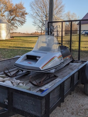

So I'm new to the forum and rebuilding sleds. I inherited this from my Father-in-law. He bought it new and I used to ride it back in the 80's. It's been sitting in a barn for about 30 years. Engine isn't stuck, and it ran when it was put in the barn.
What should be my first line of attack with it? Like I said, I've never done this before. I am mechanical and can do most things it need i think.
