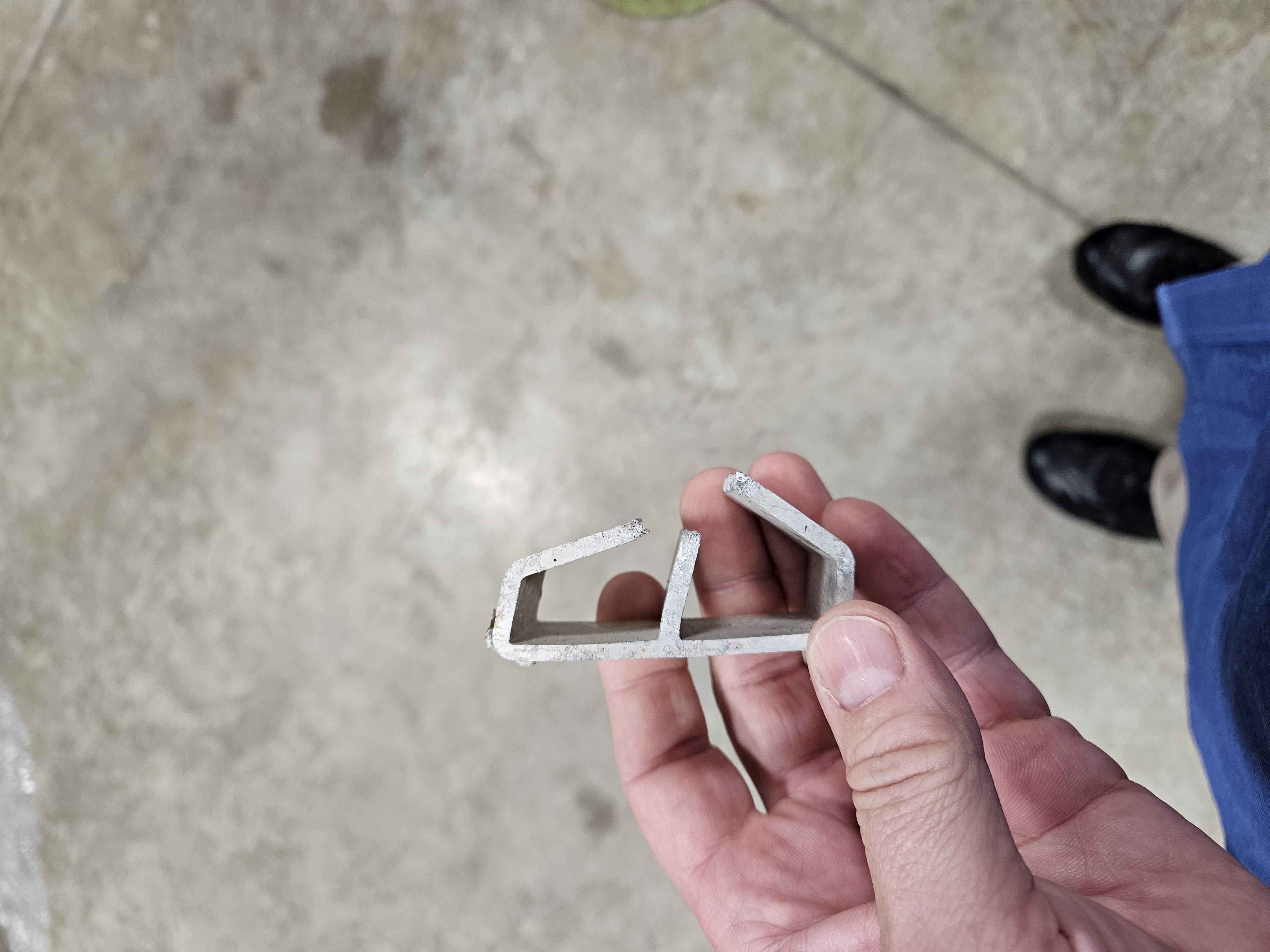

If you look closely you will see the pivot bolt appears to be in two pieces. In my case the bolt rusted and fractured with a small stub holding things partially together. I always assumed there was nothing in the tube but it turns out they weld an extrusion in the tube that acts as a bushing to spread the load of the bolt across more than the edge of the hole. It was sort of miserable to take this thing apart. We tried using the air hammer to remove the bolts but no dice. In the end we used a sawzall to cut the bolts and then used the air chisel to bust up the extrusion then we were able to get heat on the bushing part and drive the bolt halves out with an air hammer. The bolts were very corroded into the aluminum extrusion. Here is the largest remaining piece of the original extrusion.

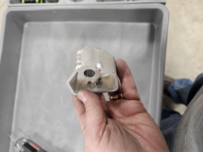

I stopped by my local Triton dealer and asked if the extrusion could be purchased......no sir. So i set out to make my own. Just for the record, I'm not a professional welder and I have not done a lot of aluminum welding so please go easy on the appearance my welds.

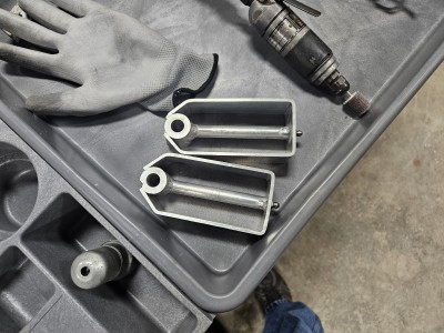

As I thought about this project I decided it would be nice to have the ability to pump grease into the pivot to hopefully avoid this in the future. Here's what I ended up with. The shorter ones went in the wishbone tongue and the longer ones went in the deck frame.

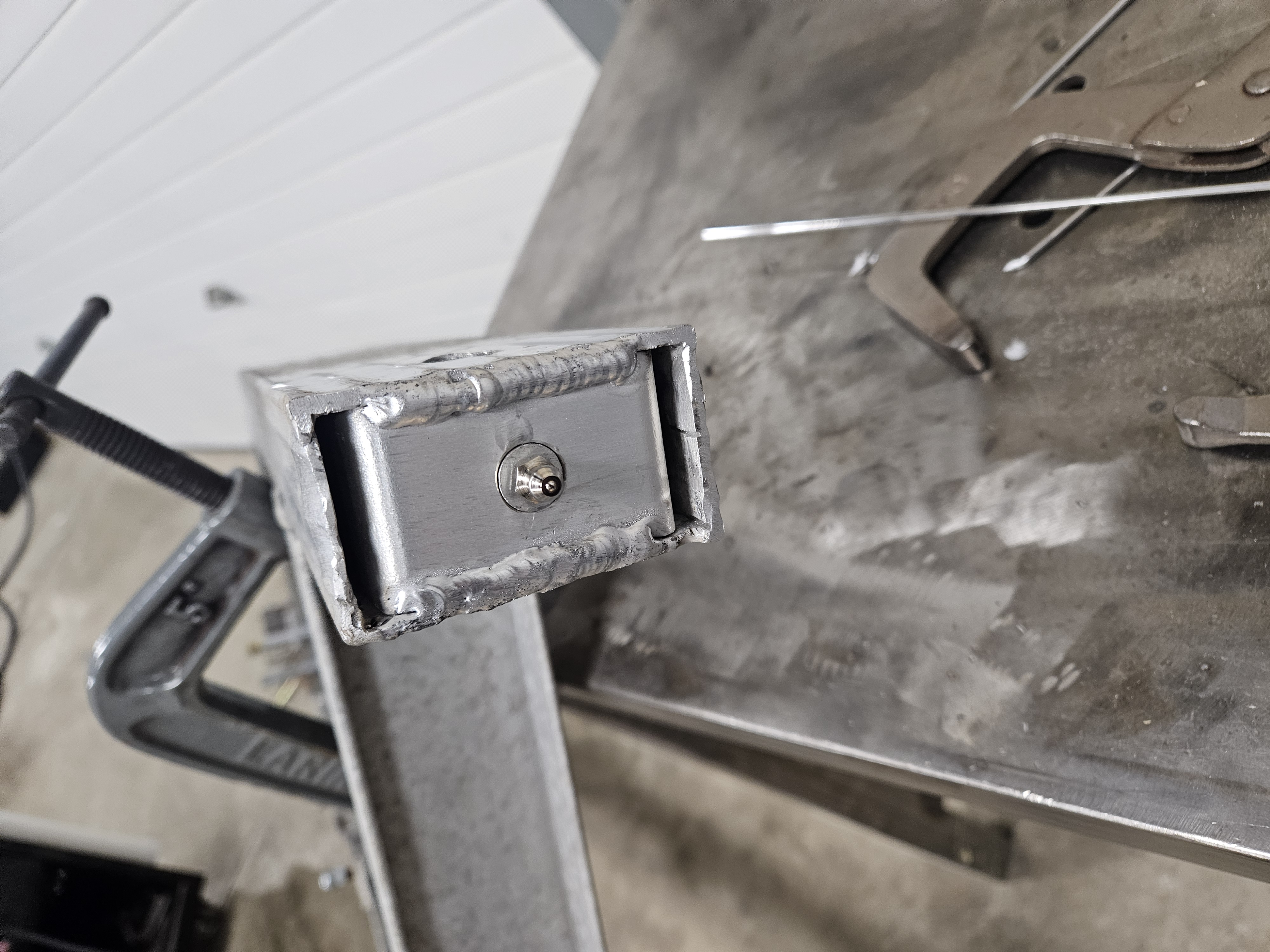

I bolted the tongue to the trailer before i welded the new pieces in place. The pieces in the deck frame were pretty difficult to get to. I had the front of the trailer lifted as far as I could and rolled under it with a creeper. It was pretty tight quarters and nursing a bad back didn't help the situation.
For the tongue I welded one side fast on each piece and then unbolted the tongue to weld the sides closest to the plastic spacer. The reason I un-bolted it was to prevent melting the spacer.
