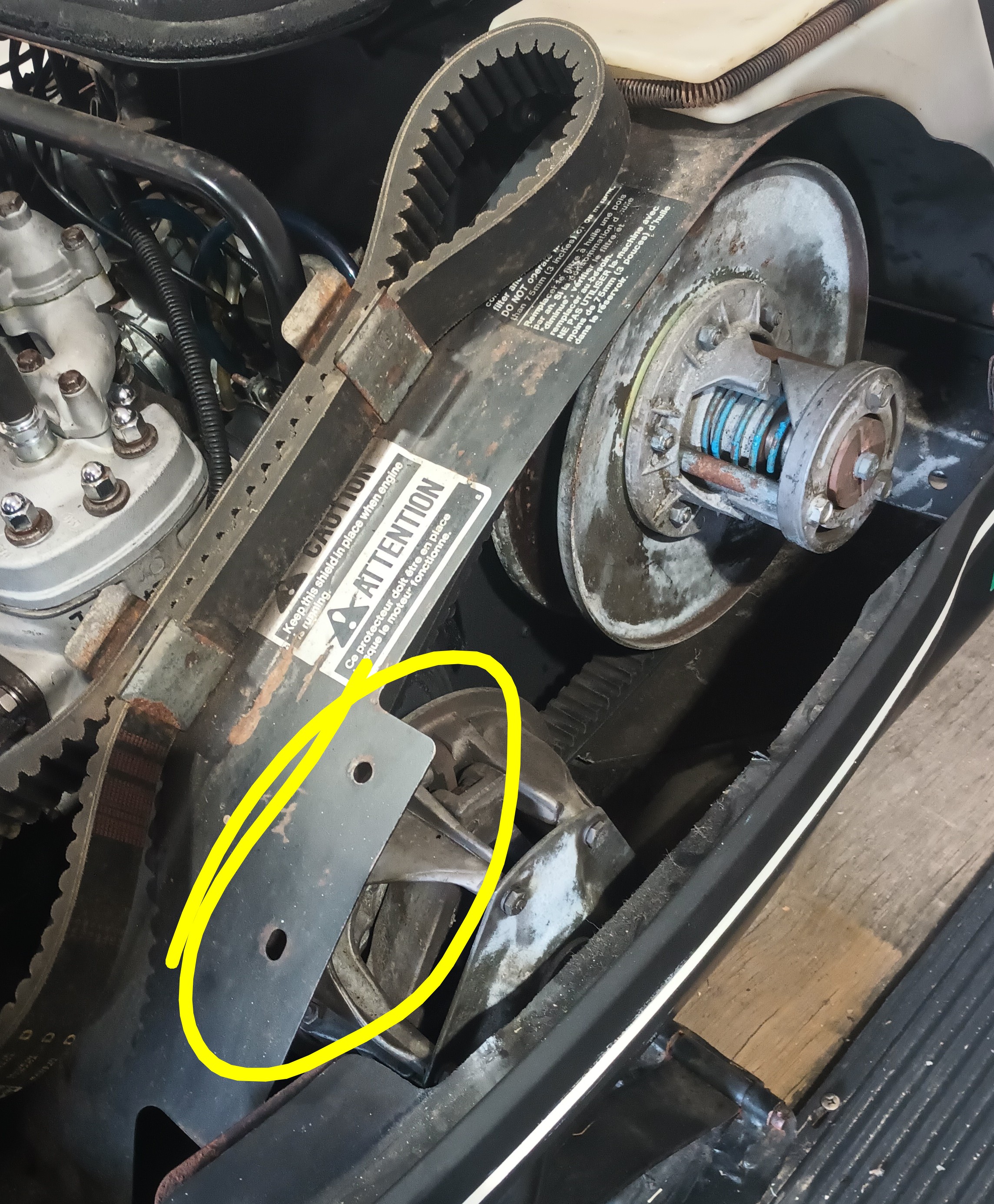

Post by SnowMeTheWay »
Is there a guard or something missing on my '83 Liquifire?
(Yellow circle) What are these two holes for?
1983 Liquifire 440
1980 Chrysler Sno Runner
Re: What are these two holes for?
Clutch guard on the 82+ liquifire. I'm assuming this sled is new to you. Just an FYI. The 82+ liquifires came from the factory with the TR800 clutch. These ran a 1-3/8 wide belt. The secondary and jack shaft are also unique to the 82+ liquifire. I can't tell if you have a 102C or a 108C clutch on there. You can make either of those work. Just wanted to make you aware that there could be some mismatched stuff going on there. For example the 102C could be setup for a 1-1/4 wide belt but the secondary is setup for 1-3/8. Just something you may want to investigate if you are having clutch issues.
