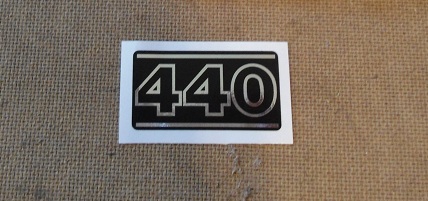

I have a guy that can repop them to factory specs with the same material.If anyone wants to send me one so I can get him draw it up,I will return the old one along with a new one.After that I can make them available in the store.The ones I have had done already are the Trailfire "340" + "440" engine shroud decals, the Spit,Sprint+Snowfire Ignition decals along with the 80s style belt caution decals,and engine "oil" decals.
Engine Shroud Decal Trailfire 440
