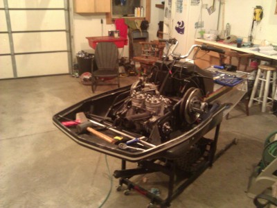

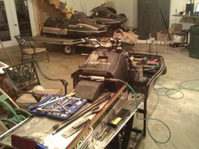

I have restored several Kawasaki sleds but for some reason I have been drawn to the "green" side. Maybe it is the guys that create the warmth of family in this group or maybe the midwestern upbringing and the prestige of a "JD"......I am currently putting a '81 l/F together on the way to a complete line-up of 80-84's and am ready to drop the clutch on. I picked up a couple AM55325 102c kits and wanted to know the thoughts of dropping them in my 102c's......
Here is a link to the current kits on ebay:
http://www.ebay.com/itm/JOHN-DEERE-LIQU ... 987wt_1091
The 102C that I plan to run in this machine has a silver spring.
I am running Invader heads but everything else is stock.
Question #1
Does this weight kit work with everything else stock?
Does this kit work with a silver spring?
My manual does not include this AM55325 in the chart of weights?
I have a basic understanding of clutching and the payoffs associated with preformance.....
I appreciate all advice and welcome all comments.

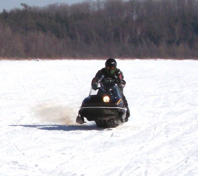

I see quite a few studs on that rocket.

STUDS!!!??? Nopenick80lf wrote:I see quite a few studs on that rocket.
Those are P/N AM567803 - Highly sought after factory experimental John Deere attachment developed secretly in Horicon for the 80-84 Liquifire. Used for aerating the lawn.

I seeTOYMECH wrote:STUDS!!!??? Nopenick80lf wrote:I see quite a few studs on that rocket.![]()
