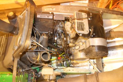

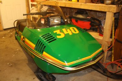

Here is a couple pictures of my latest completed project. It is a 1978 Cyclone 340 chassis with a 76 440 powerplant. The project started with a 76 cyclone that I bought a few years back. The chassis was pretty beat, but it had 1800 miles on it. I had a parts 76 LF 440 engine with carbs and decided to try to put the LF carb setup on the cyclone. I got the the changeover done and it ran well, but was plagued by issues of a beaten and neglected sled. This fall I found the 78 chassis that had a partial motor and no clutches. It was in very good shape and had been stored inside. I pulled the engine from my 76, rebuilt it, cleaned up the intake and ports, and then put it in the 78 chassis. I also switched the gears to the 1.68 ratio for more top end. So far, I have put about 35 miles on it this season and am happy so far. There are still a few tweaks to do with jetting, clutching, and maybe modifying the suspension for deep snow.

Very clean! Nice Job!

Re: Twin carb cyclone
That looks real good. How much more travel does this give you?
Took the cyclone out for a quick spin today. Had it set too stiff so I will adjust tomorrow and put a gas shock on that I found in my stash. I haven't measured the travel yet but at least 5 inches more than I had!! The drive shaft is a 82 LF hex shaft with JD 8cog 2:52? Pressed on. These are smaller than the polaris drivers for they will fit the tunnel and same ratio to fit track. Hope this helps!
The sled looks great! I had done a Trailfire suspension conversion on the sled that the motor came out of, and it worked well. I didn't do it to this sled, because I didn't want to put any new holes in the tunnel.
