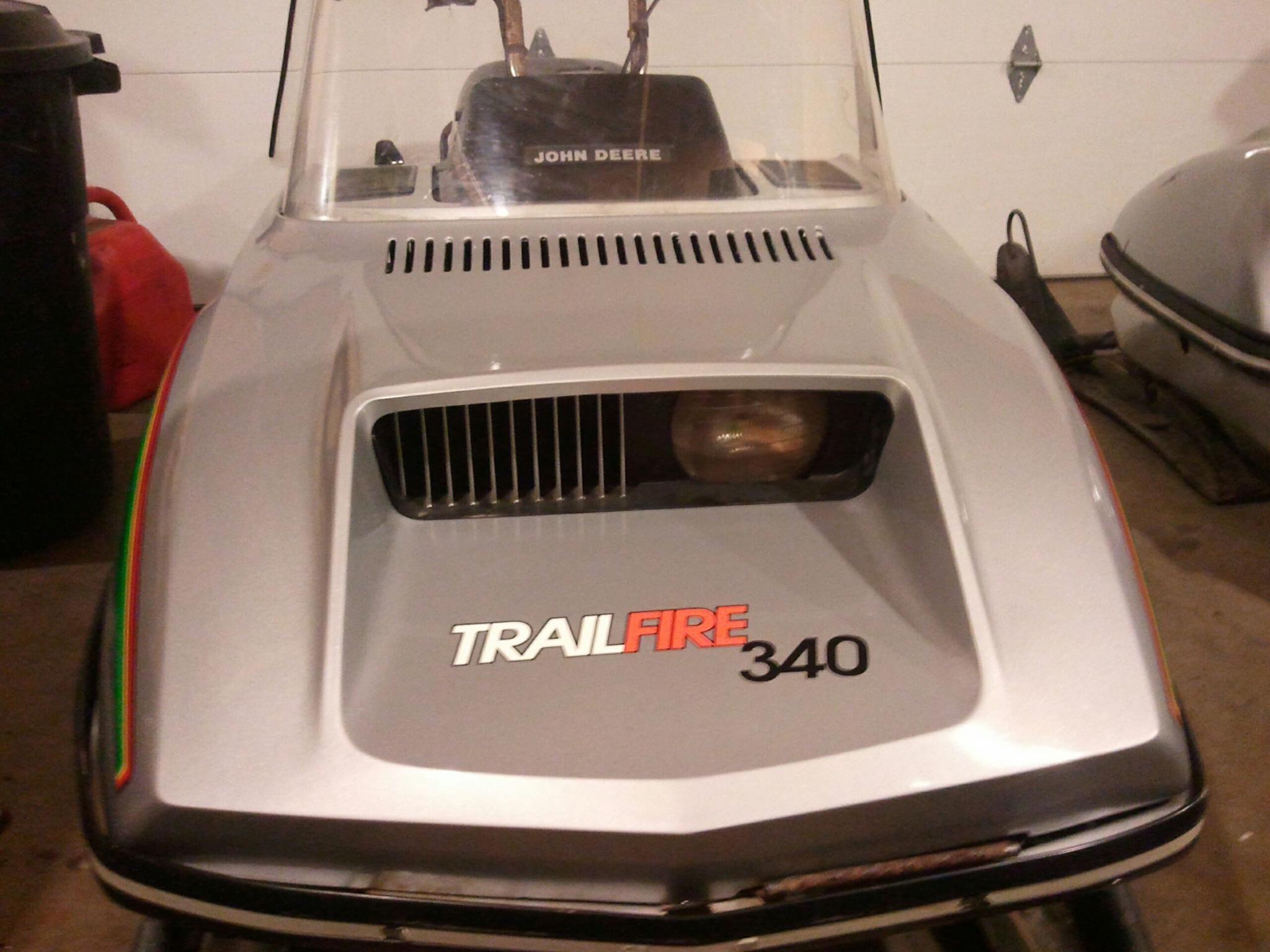

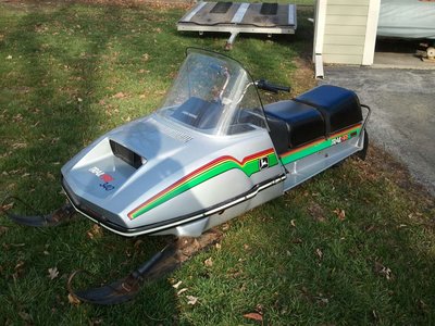

I used Napa's Crossfire paint line and had good luck with it. The paint was Crossfire silver metallic. The code was 53-42159-00-B, but it is a single stage enamel, not base/clear. I had good luck and thought it matched fairly well. You could probably use the code and get it in base/clear if you want. The size of metal flake was a little smaller than factory, but the color was quite close. Here is a couple pictures of a sled I did with this paint. The tunnel and belly pan are original, and the hood is repainted to give you a comparison.
