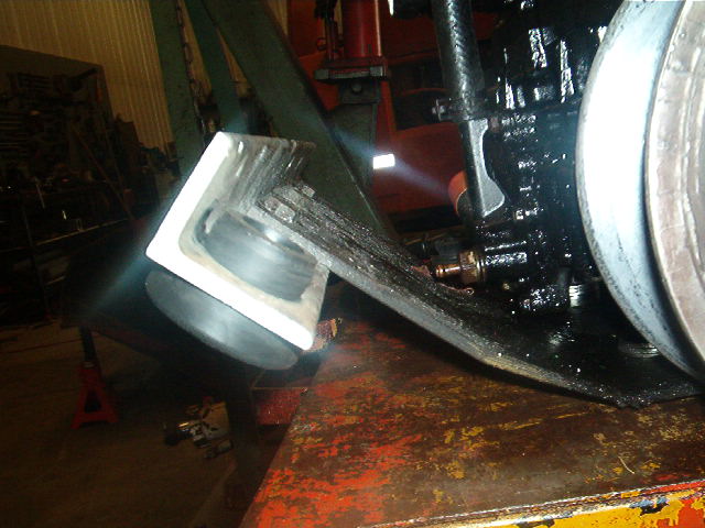

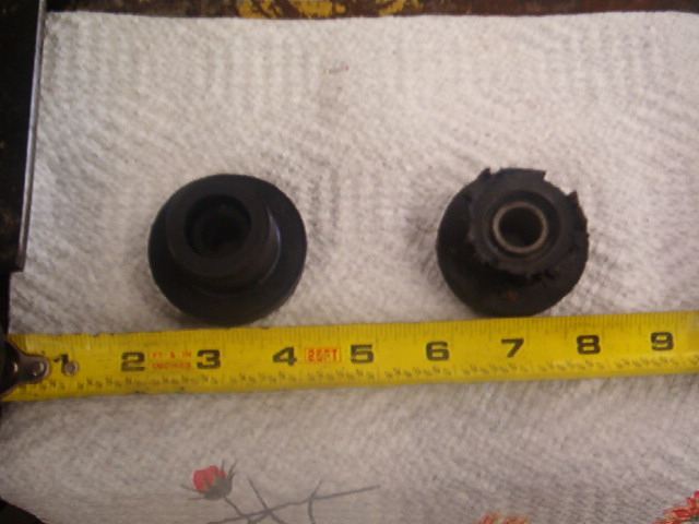

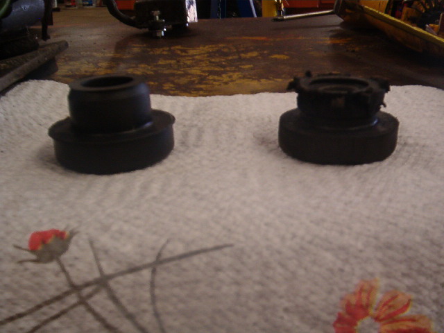

I know there has been some talk of the eng mounts for the JDX/100 series-early Liquifire/cyclone. I think I have found a good replacement. It looks and measures up the same. I got it from my Bobcat skidloader dealer PN 6560633 about $15 a piece.

JDXspec wrote:I know there has been some talk of the eng mounts for the JDX/100 series-early Liquifire/cyclone. I think I have found a good replacement. It looks and measures up the same. I got it from my Bobcat skidloader dealer PN 6560633 about $15 a piece.
Excellent !!

With this last winter being not the greatest I didn't get all the miles in I wanted (about 50 miles). That said they are holding up great. If you notice the eng is NOT a JD eng, but the mounts are jd. Being I have the 650 wildcat eng in there it still is rock solid. More then normal wear and tear so they work great.

The fit of these is perfect, but they do run about $25 a piece here in the great white north
