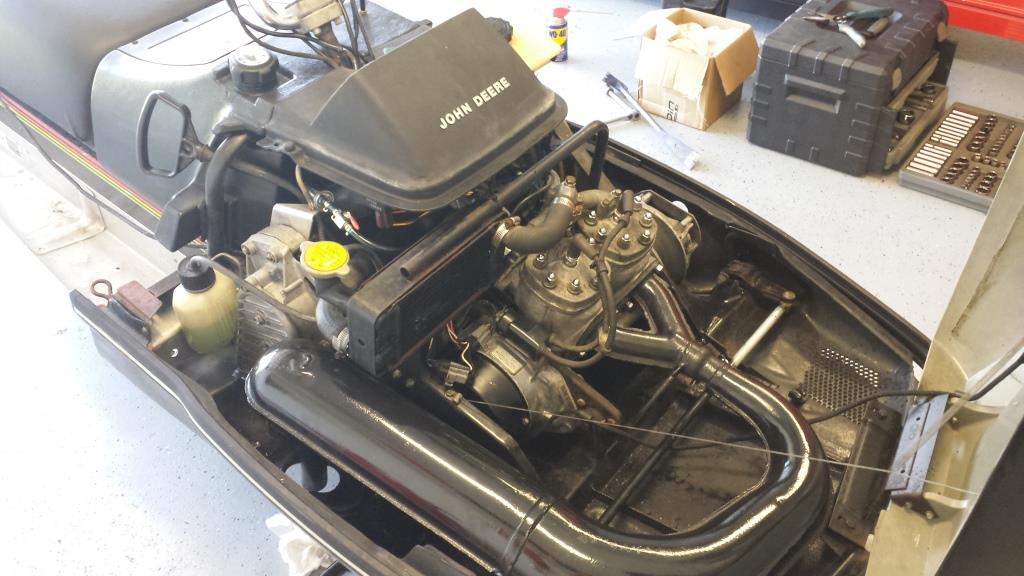

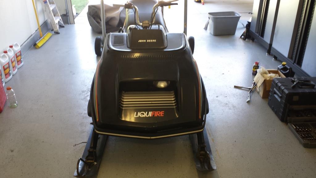

pwgsx
Posts: 109
Joined: Tue Feb 05, 2013 10:21 am
Location: Texas
Re: 1981 Liquifire Project
Post by pwgsx »
Got the sled all back together, carbs were VERY dirty but cleaned nicely. Here are some finished pics, I didn't go all crazy with the restore, just did everything that was needed to make it run. To my surprise all the lights, gauges and brake lights work. When I found it, it was stored outside without a cover for many years. Now to decide what to do with her since TX is not a place I can use it. I still need grips, and new carbides but that should be it.
