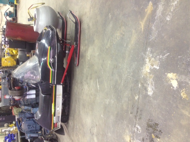

Here is my ifs. I have a few little bugs to work out. But it works

How wide is the clutch belt suppose to be new. I got people telling me 1.250. The manual says 1.375" new however the belts they are selling me is #1105 and 1.250 thick. I think it is wrong

Thats one big turbo diesel in the background. I like your sled.
Re: What is the most powerful sled john deer came out with
If that '82 has the OEM secondary, the belt width new is supposed to be 1-3/8". The JDX8 had a 440cc engine.
