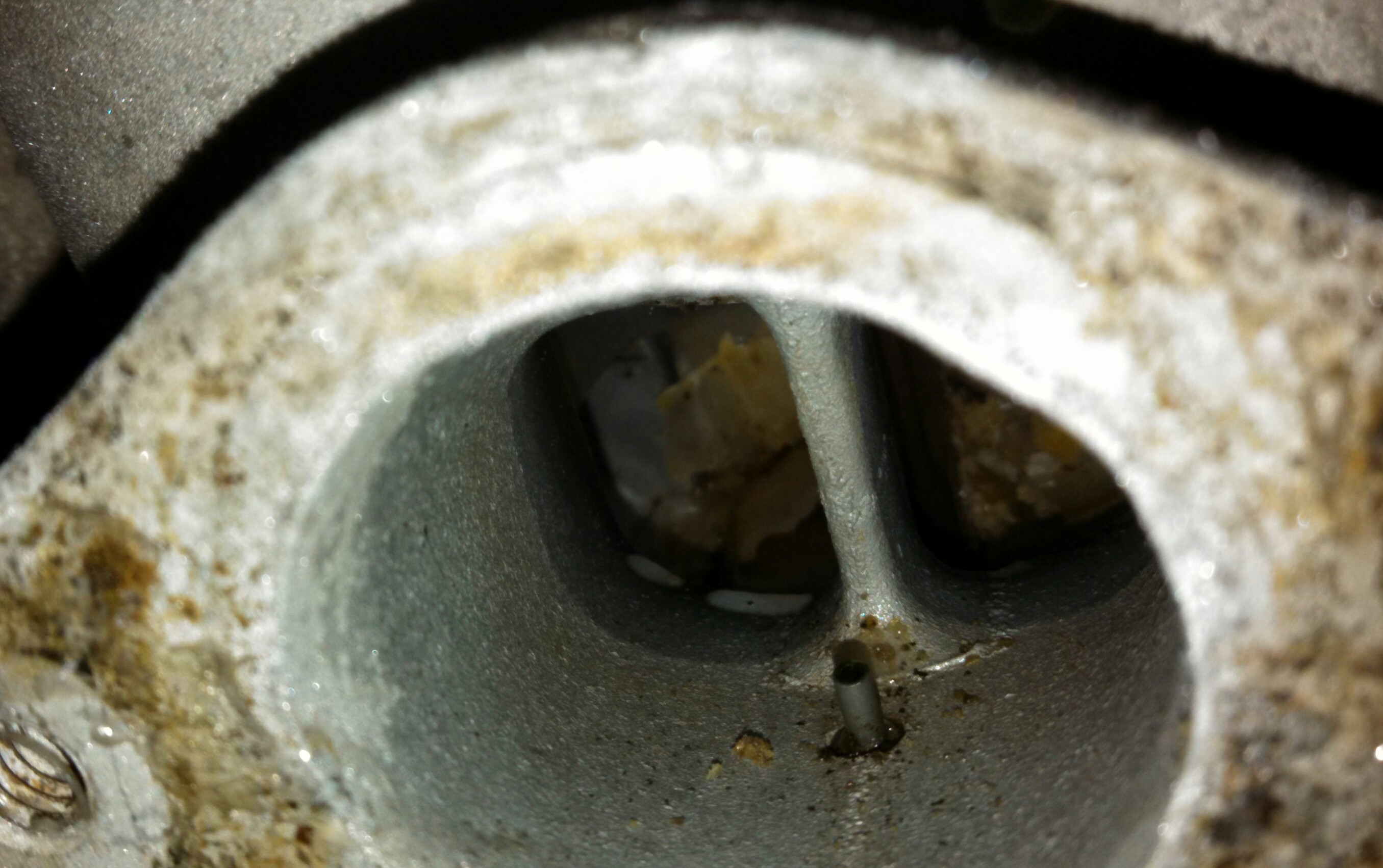

Discovered chunks of ice sitting under exhaust side cylinder.
Re: 1980 440 Liquifire
In the crankcase?

Yes it is from rapidan lol. So I peered through the right carb intake and that is where I saw the chunks of ice in the engine.

Yeah I hasseled the guy about the ad...he is strictly a scraper and had a some lady post it for him...My guess is just like harleysportster said there was no air box on it, and the clutch side carb was not even attached and the exhaust side carb was attached. The sled was jacked up but sitting outside for at least a year with no cover on it! I'm guessing the culprit is rain/snow/whatever moisture entered through the carb intake ports as there was spark plugs screwed in and the recoil was attached.

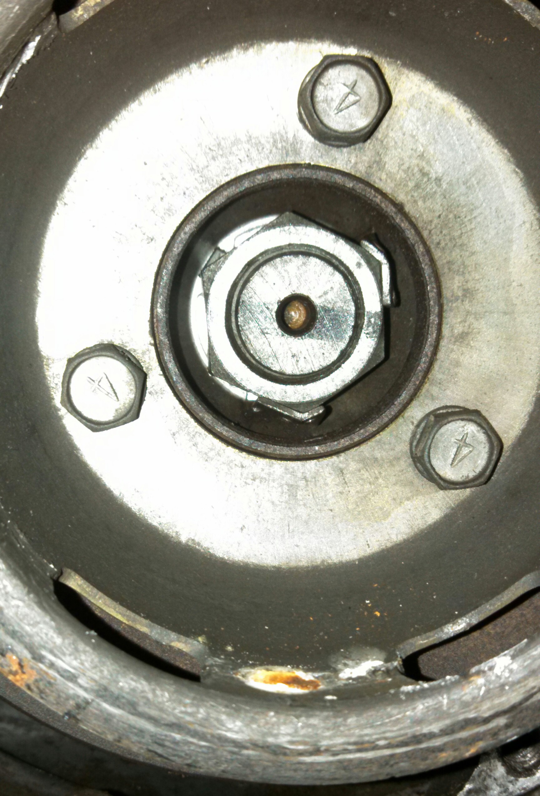

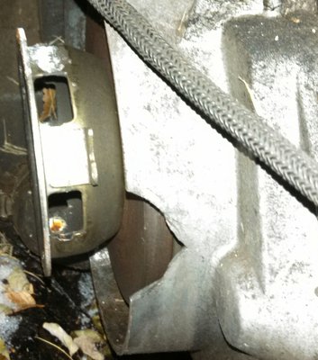

So I learned tonight that taking off just a liquifire recoil can be a pain but doable.... so there is a couple pics not much to see but I do have a chip out of the housing apparently, how big a deal is that?
It leaves a hole for moisture to get in at at the stator, I just tore down a liquifire motor for parts to be parted out.

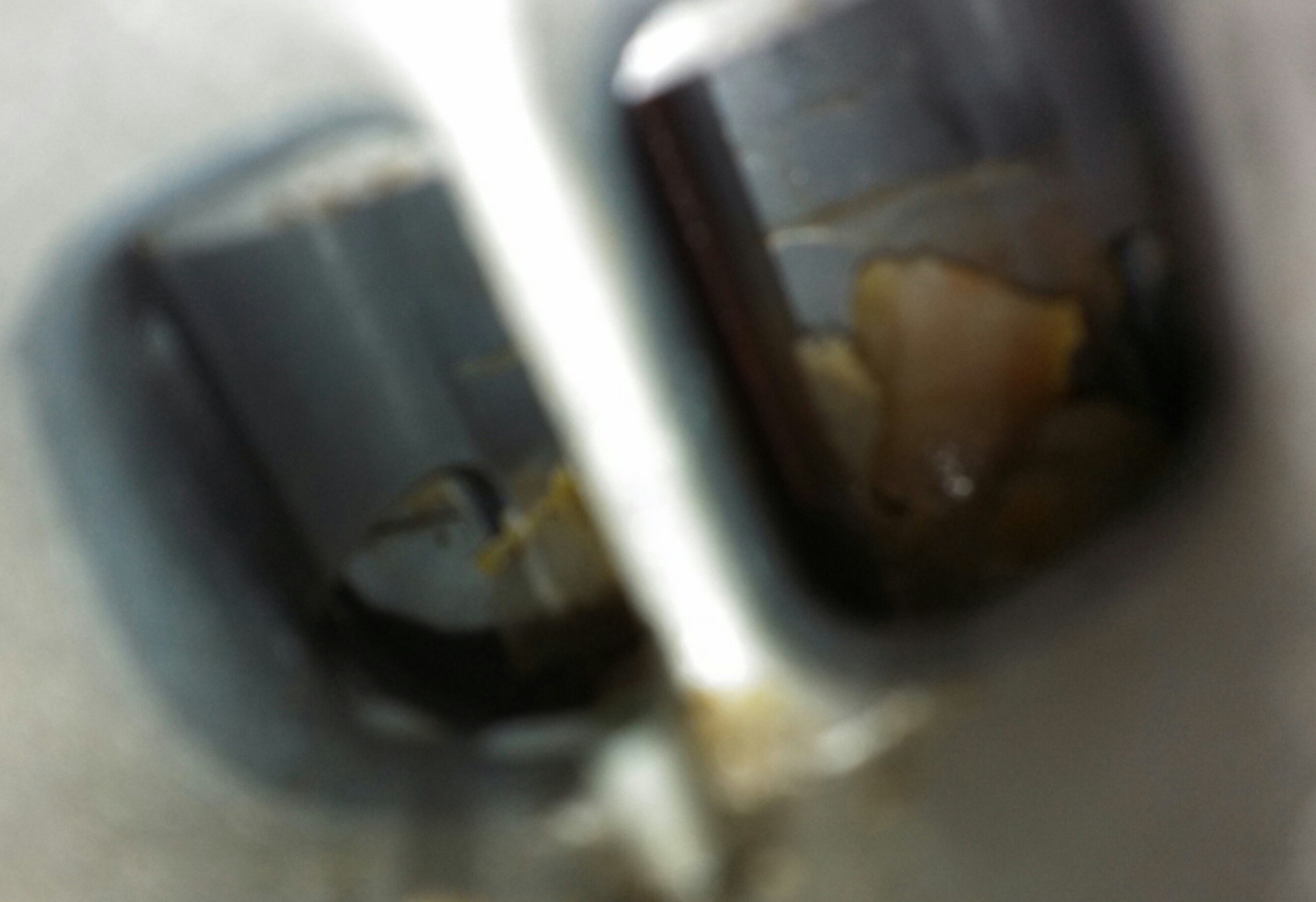

In this post you will see the exhaust side cylinder with the chunks of ice in it. Now it was 36 degrees here today and I was able to turn the clutch counter clockwise but not clockwise by hand. Why is that? Both cylinders did move up and down.
That motor is going to need to be pulled out and overhauled at the least.
