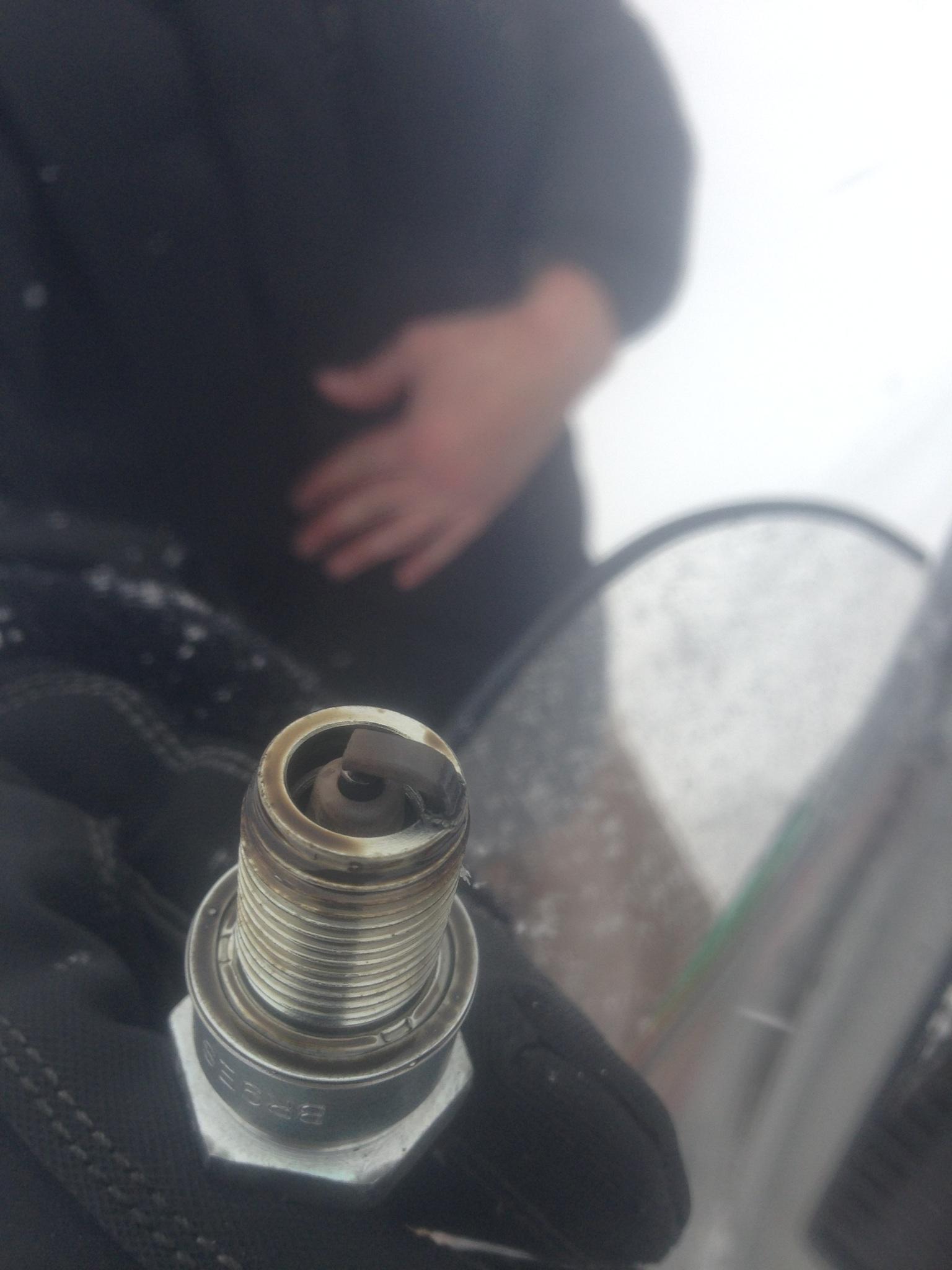

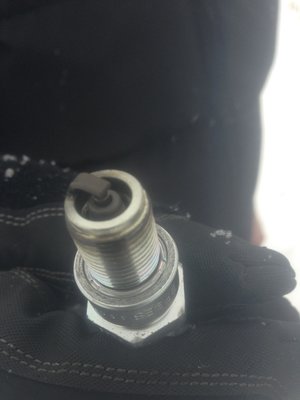

I'm doing some ditch banging and it's finally running well. How do these plugs look to the trained eye?
Re: critique my plugs please
Reading plugs is harder than reading the wind for a long distance rifle shot on a calm cloudy day. The first one looks cocoa brown, the second looks a bit lean. What machine, which sides of the engine, and how long were they in?

I understand. The first time they were so lean the space station could have seen them.
It's an 82 sport fire that has been harassing me since I got it.
The first one is the pull start side, second is the drive side.
I'm still missing the small washer that goes under the e clip in the slide needle, so I'm figuring it would be a slight lean condition from the needle being just a hair more closed than it should be.
I just want to see if anyone noticed something way off base.
You must have something else causing a lean condition on the PTO side if the plugs look that different on a Sportfire. The first plug appears rather normal, so if an incorrect fuel mixture is the issue, both should show it and they don't. Crank seal leak?
They look not bad to me, as long as your getting good oil supply I wouldn't be overly concerned, but best to put that ring in anyhow
Sure looks better than before when the one plug had white specks of alum on it.
Remember better to error on the rich side as a fouled plug is cheaper to replace than a pistion.
I just looked at my Sportfire's plugs yesterday after riding last weekend, and they look about the same, one is slightly off from the other. This could be because the side by the fan cools a little better.
That is a valid observation. I bet that plastic fan shroud deal is supposed to alleviate some of the difference in cooling between sides of the engine.Matt wrote:I just looked at my Sportfire's plugs yesterday after riding last weekend, and they look about the same, one is slightly off from the other. This could be because the side by the fan cools a little better.
