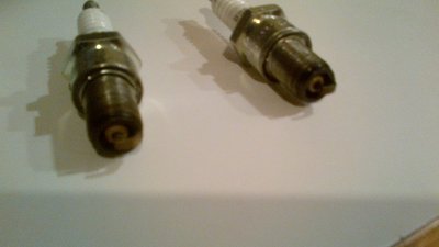

Here is pic of the plugs

The backfire is from being lean or a late spark. I will also go with a bad coil. Could also be a crankseal
Re: wont rev over 7500.....80 Liquifire
Picture looks like a lean condition to me.

JDT wrote:Picture looks like a lean condition to me.
Yeah it is a little...hmmm?
