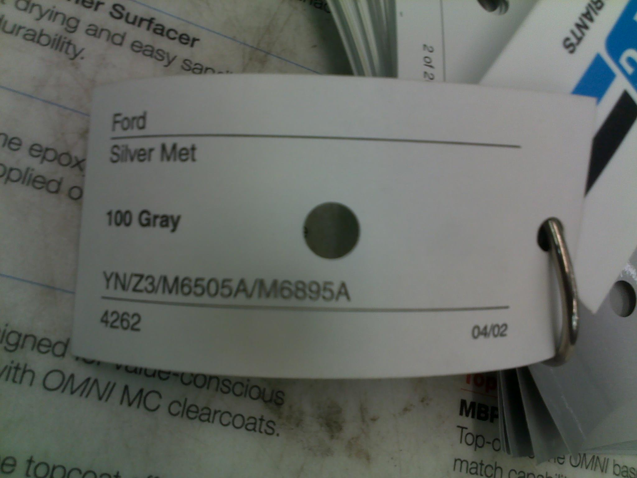

If it's correct, it looks like 4262 is a code for that color in PPG. I will see if my local PPG dealer can spray out a card, and see how it looks.

The consensus was that Winter Frost 2 was VERY close to the color Case/IH used on their silver wheel rims. I also thought I’d read that Winter Frost 2 was still available at Deere dealers but had been renamed. I can’t vouch for how close they are, however Deere does currently have a silver paint available that the color chart says ”matches Case/IH silver.”
Case/IH currently has 2 (3 if you count the high-temp exhaust paint) silver color options available. #1 Silver-Aluminum, #2 Silver-Argent. I had read on the Case/IH/Farmall forums that the Silver-Aluminum color was “too bright” for most tractor resto guys.
After spraying Silver-Argent on a card I took it to the local paint shop to be matched. Boy did I get an education! Up until then I always thought “a color, was a color”. I had no idea how auto manufactures struggle to maintain consistent color matches over a year of production. I always figured that for example, all 2012 silver Ford Mustangs (not picking on Ford here) were EXACTLY the same color. Turns out that the color varies ever so slightly during the production run and from time to time (due mostly to automation and minute variations over a period of time).
Below I have posted photos of the backside of the PPG Ford Silver paint that I had mixed for the Trailfire. The Case/IH silver paint sample I brought with me most closely matched one of the “up-date” silver colors (there were 6 update supplements for this color with just slightly different variations). I took the advice of the paint guy to go with the “prime” version of this silver.
I can only imagine that snowmobile paint colors also must have varied during production “back in the day.”

If that PPG 4262 works out well, let us know please. I have used PPG most all of my life, and have their reducers, and clearcoats, primers etc, in my stockpile, so it saves on buying all of that. Hopefully that color works well.
