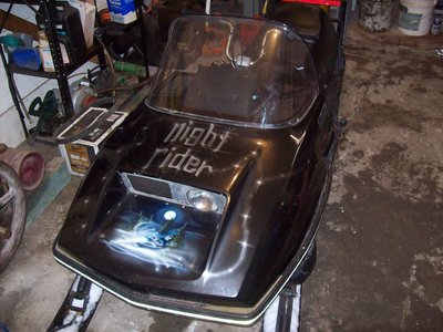

I just picked up this 80 Liquifire Saturday. I bought it from the second owner, who had bought it used in 1986. The first owner pretty much immediately set it up as a race sled. The engine was sent into Aaen for porting and other modifications. At this time, I am not sure of what other modifications were done. The second owner, who I bought it from, put the clutching back to closer to stock and made it so that it was a very hot rider sled. Since he bought it in 86, he has put around 1000 miles on the sled and it ran fairly dependably. The custom paint job was done in 1980, as the airbrush guy signed and dated the hood 1980. The sled also came with an extra, NOS, hood that has never been on a sled, but was painted identical to the hood that is currently on it without the Night Rider name. I don't know if this was just an extra hood or what the deal was. I have ran the sled in the shop a little on the stand, but need to do a little more cleaning on the carbs before I get it in the snow. The crank seals have been changed in the last few years, as well as all of the outer bearings.

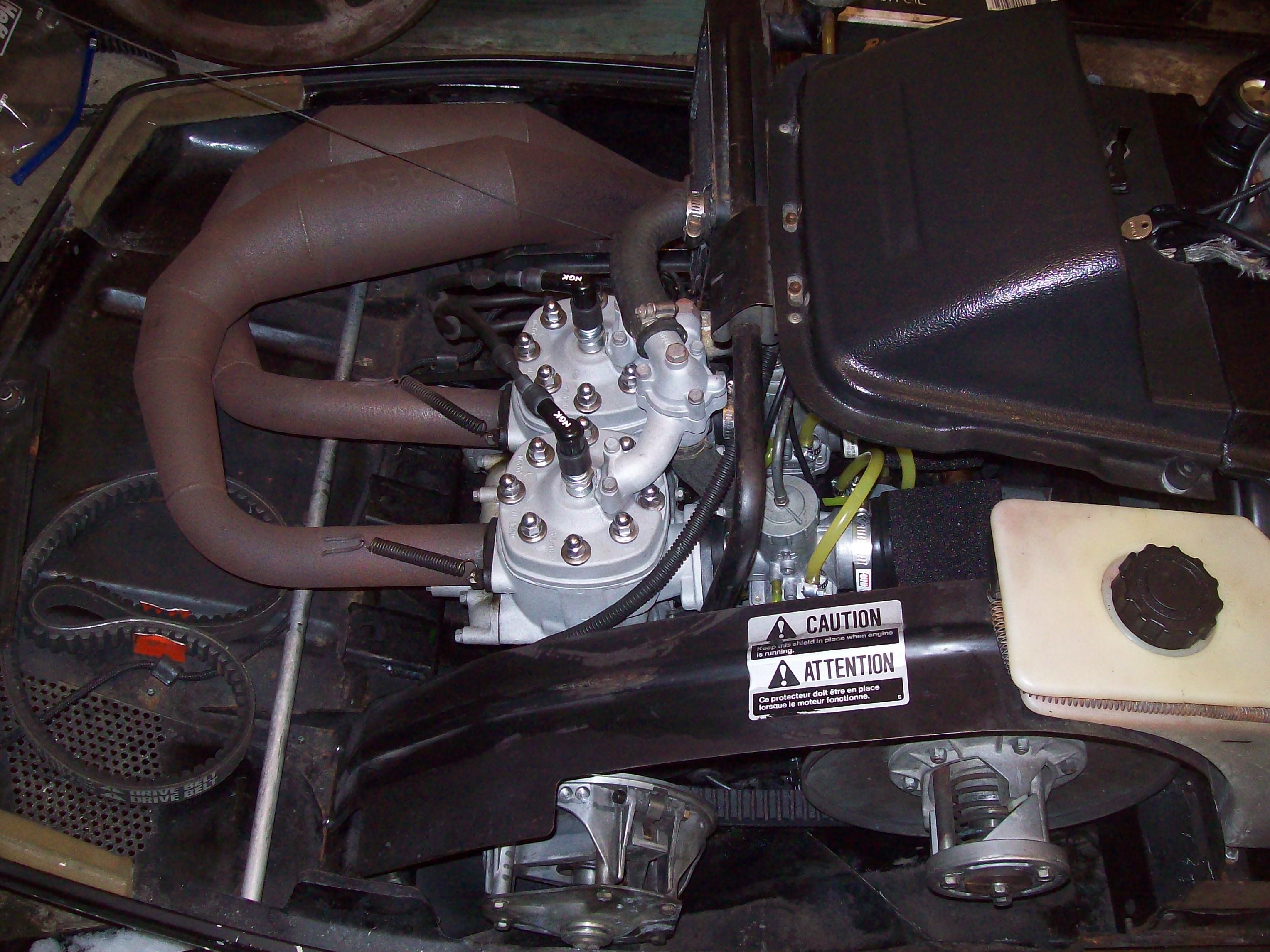

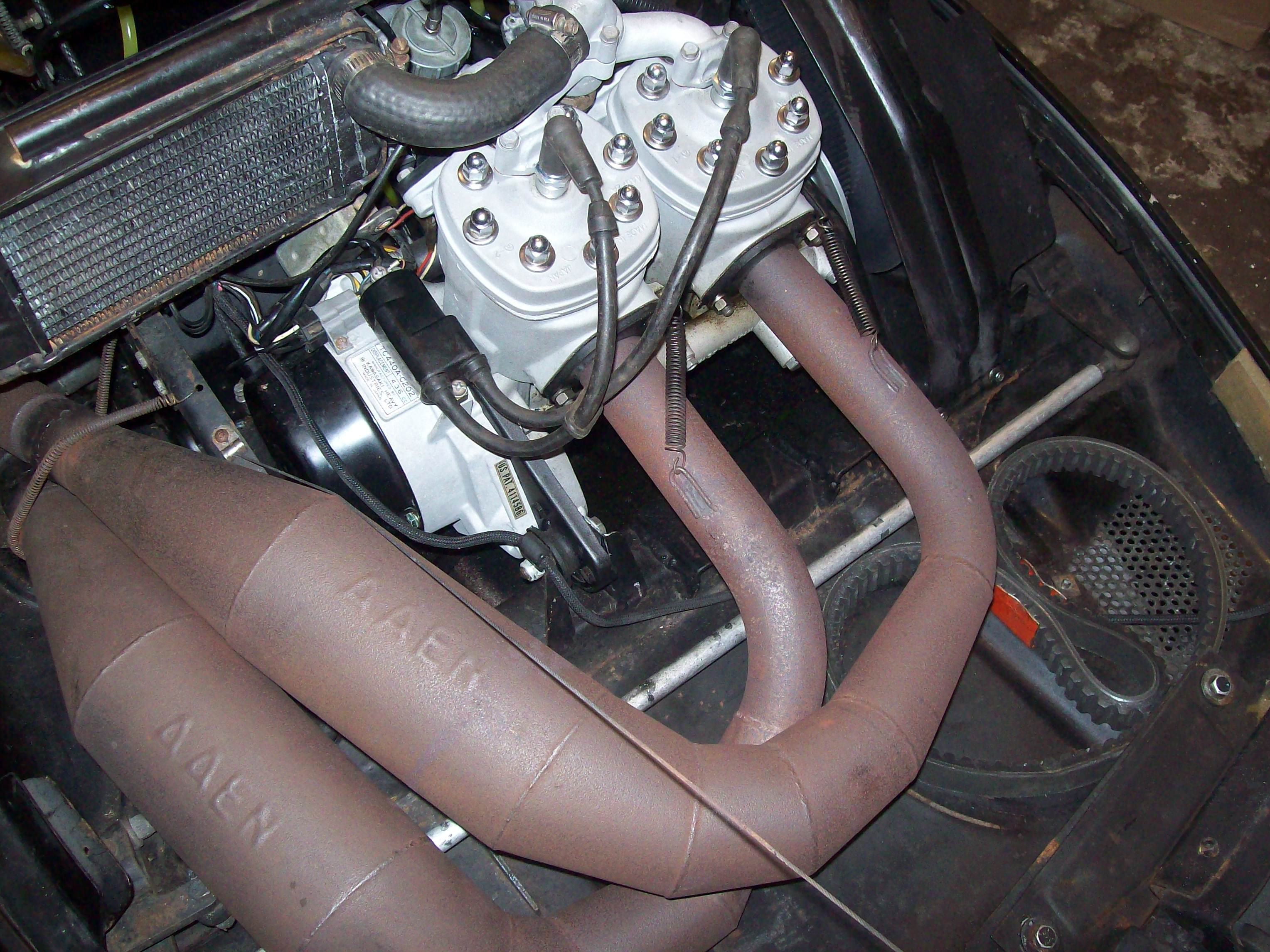

Jeff ...... great looking sled. I would like to see more detailed pictures under the hood. Perhaps the most interesting thing I see is what looks to be added motor mount brackets?! I wonder if there was a different motor in it at one time. What is the serial # and could you post a picture of it?
As far as the air cleaners go .... I tried running them back in the day and they did not work for me on a stock sled. It started and ran fine until you got up to speed it lost power at times. I was told by engineering that they had to have the air box to normalize the air turbulence under the hood that could draw air away from the carbs at time??? Something like that anyway. I do remember seeing them on someone's sled recently and they said they had no problem? Maybe it was Brad Wheelocks sled?

I had some time to mess with the sled today. I took both carbs apart and soaked them. I don't think that they were dirty because it still runs about the same as it did before. It seems to be either running lean. The plugs are very light grey-- almost white. I did put new plugs in, so it is kind of hard to tell with the 15 min. of run time. Something is not right, I think in the carburetion. I can't get to go above about 5000 rpm before it bogs down-- barely enough to move the sled. Where should I start with fiddling with the carburetor? I have the drive belt on the loose side just to make sure that isn't the problem. According to the previous owner, the sled ran okay when he put it away a couple of years ago. In talking to him, he also said that he replaced the stator a few years ago. Ever since then, it has been harder to start and tried to backfire through the carburetors when starting. He said he thought Aaen changed the timing and he tried to get the new stator close, but he's not sure it is right on. Does anyone know the correct procedure?

This sled has me stumped. I have spent some time trying to eliminate possible problems, but the sled still will hardly pull itself with me running along side (I have gotten quite a workout). I have removed, taken apart, and soaked the carbs 3 times now, as well as taking apart and checking the fuel pump. I tried both bigger and smaller jets to make sure that the jetting wasn't a problem, I put a new CDI on, and put my brand new spare 102c clutch on. Compression is 120+ on each cylinder and is the same. I have had 3 different sets of plugs and 2 different coils on. A friend of mine stopped by and worked on it for a couple of hours last night. He was a Ski-Doo mechanic for a couple of years in the early 80's and he is at a loss. Has anyone here experienced a problem like this? Could it possibly be timing? It doesn't start real easily and, sometimes, will try to backfire through the carbs. It also seems like the warmer it gets, the worse it runs. The previous owner did replace the stator with a NOS one. I have the tech manual and it says to check timing, you have to use a timing light, which looks almost impossible to do on a Liquifire. From what I understand, with the Aaen modifications, you have to advance the timing something like 4 or 5 degrees, which adds to the complexity of this equation. I would like to know what others have done to set their timing and how well it has worked.

Joe, unfortunately, I don't have the airbox, and it hasn't had one since the early 80's. I talked to Brad Wheelock about it the other night and we discussed the airbox. He said that one of Aaen's modifications was to set it up to run the small filters instead of the airbox. I thought that by trying different jetting yesterday-- both larger and smaller, I probably took the carburetion out of the equation. I will buy an airbox if I have to, but I hate to spend $50-$75 for an airbox that I don't need with this setup. Thanks, Jeff
