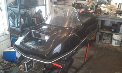

I just picked up this 80 Liquifire Saturday. I bought it from the second owner, who had bought it used in 1986. The first owner pretty much immediately set it up as a race sled. The engine was sent into Aaen for porting and other modifications. At this time, I am not sure of what other modifications were done. The second owner, who I bought it from, put the clutching back to closer to stock and made it so that it was a very hot rider sled. Since he bought it in 86, he has put around 1000 miles on the sled and it ran fairly dependably. The custom paint job was done in 1980, as the airbrush guy signed and dated the hood 1980. The sled also came with an extra, NOS, hood that has never been on a sled, but was painted identical to the hood that is currently on it without the Night Rider name. I don't know if this was just an extra hood or what the deal was. I have ran the sled in the shop a little on the stand, but need to do a little more cleaning on the carbs before I get it in the snow. The crank seals have been changed in the last few years, as well as all of the outer bearings.

Jeff ...... great looking sled. I would like to see more detailed pictures under the hood. Perhaps the most interesting thing I see is what looks to be added motor mount brackets?! I wonder if there was a different motor in it at one time. What is the serial # and could you post a picture of it?

I had some time to mess with the sled today. I took both carbs apart and soaked them. I don't think that they were dirty because it still runs about the same as it did before. It seems to be either running lean. The plugs are very light grey-- almost white. I did put new plugs in, so it is kind of hard to tell with the 15 min. of run time. Something is not right, I think in the carburetion. I can't get to go above about 5000 rpm before it bogs down-- barely enough to move the sled. Where should I start with fiddling with the carburetor? I have the drive belt on the loose side just to make sure that isn't the problem. According to the previous owner, the sled ran okay when he put it away a couple of years ago. In talking to him, he also said that he replaced the stator a few years ago. Ever since then, it has been harder to start and tried to backfire through the carburetors when starting. He said he thought Aaen changed the timing and he tried to get the new stator close, but he's not sure it is right on. Does anyone know the correct procedure?
The serial number of the sled is 128783. It was bought new around Farmer City, Illinois and the guy I bought it from lives near Monticello, Illinois. It came with the original John Deere cover and a ton of extra Liquifire parts, as well as another stock engine the was just rebuilt.
I am new to this performance sled stuff, so I am sure I will be asking a lot of questions, but man, the thing sounds cool when it fires up, so it is worth the fight. I am planning on keeping the sled just like this and not restoring it-- you don't come across a built performance sled everyday, so it has a lot of character. Does anyone on here know anything about this sled or remember seeing it back in the early 80's? I am very interested in more of the history.
