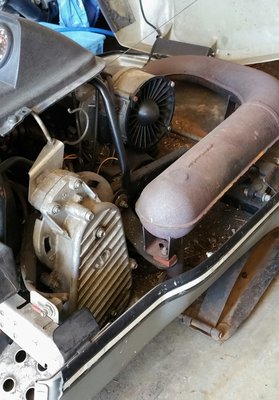

I have been looking for a sporty and then just happen to literally open the barn door and see this one, the owner said he had a Trailfire and when I opened the door she was no TF! The owner wasn't terribly eager to sell it but I made him a reasonable offer that would of got him out of bed in -20 below weather lol. She has pretty neat custom striping and the all rubber track in good shape and square headlight. Comet 102 but no hsr, no air scoop and no airbox but JD Rob has a box coming to me! and Matt can help me out with a fixer upper scoop. She has spark and an original sport windshield! Yesterday I checked compression and she has 151/151. She fired on a Lil fuel down the plug holes. Oil injection I'd not hooked up on her. Original white sealant around case so seals are getting done! Matt which crank seals will I need for her?

Seals are OS1302R and OS1317R. I'll dig out that scoop and send you a photo so you can see what you're up against.
