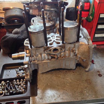

Darn thing kept flooding out the pto side cylinder so something is wrong with that carb and here the rubber o-ring is missing on the main jet. Stupid thing lol
Sure that's not excess fuel and oil from not having the jet setter o-rings?
My experience with those in my younger years, was that I had compression leaking past and coming out through the studs. In all honesty the failure was due to the surface of the head and jug not being flat. An OEM gasket leaked also.
In my opinion I think your asking for trouble if you don't lap the heads and jugs on these to make sure their flat.
On the flip side, its hard to tell from the photo if it's coolant. However, mine leave an oily spooge ring under the exhaust when I let them idle.
